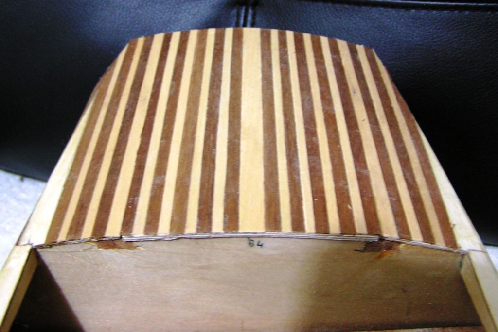

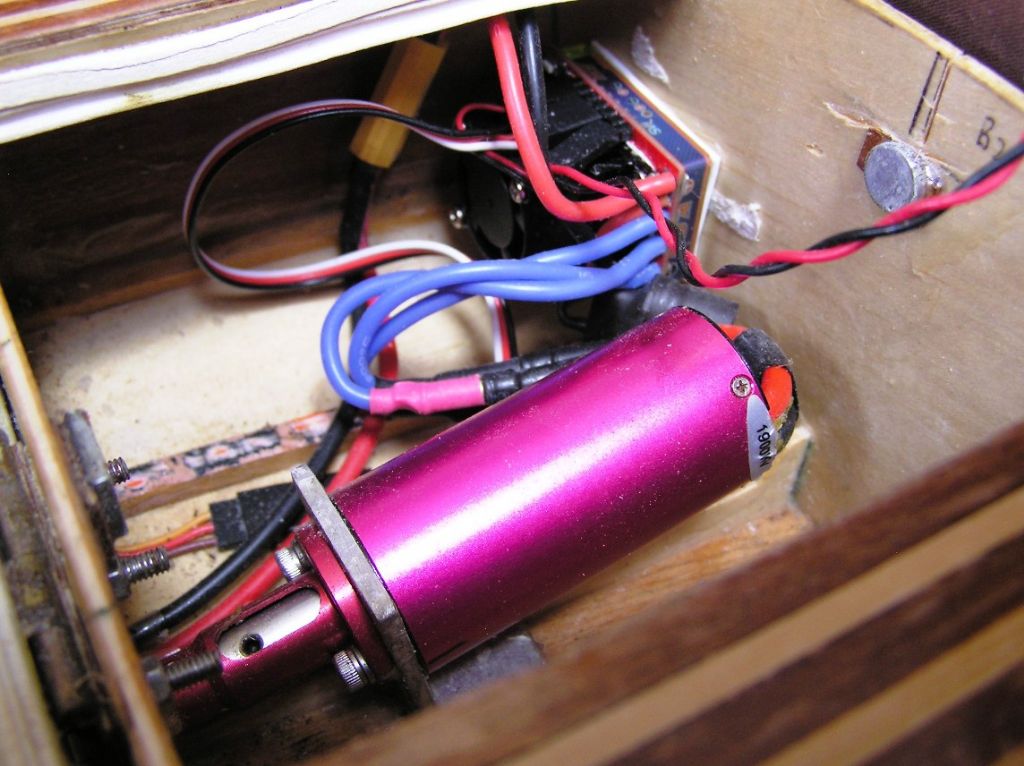

                            planking stern 2.jpgradio and battery bay.jpgYes you can hide the motor with the engine cover and maybe get the rudder servo and receiver in the small area at the stern, but, the ESC and battery are a problem.
                            A few pics of the Sea Hornet and this required large mods to the original design.
