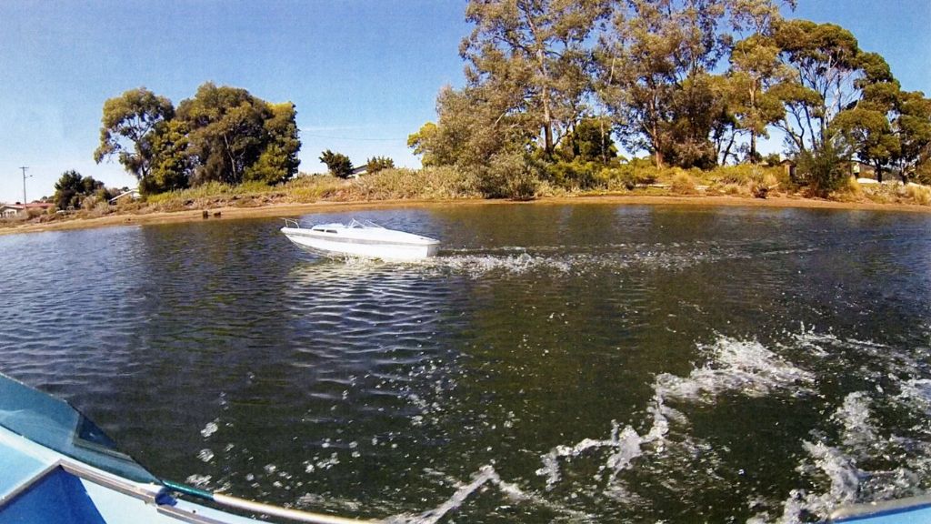

                Hi Andrew
                One of our club member's runs a Spearfish with a Hobbyking 35mm 3639-1100kv brushless motor with a 5800mah 3S Lipo Battery, ESC is the Hobbyking car 60 Amp, prop 2 blade 45mm.
                Good turn of speed without getting insane.
                If your wish more speed change to 4S battery with all the other bits the same.
                Or more speed the 3648-1450kv motor.

                    Hi Andrew
                    The D3548-4-1100kv is a far better motor, I am running one in my Sea Commander.
                    Harry
