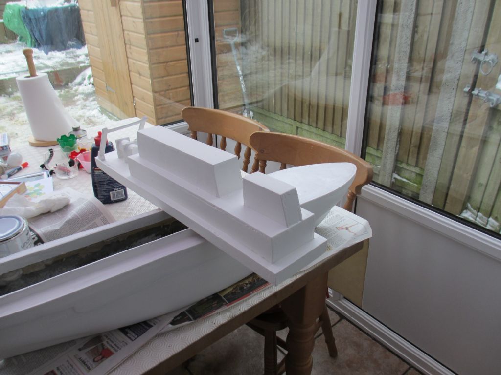

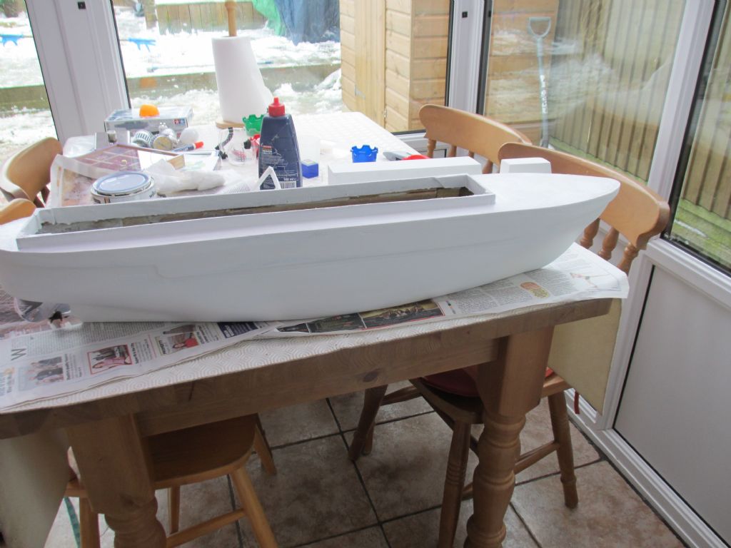

      now the weather being so cold, I have had a bit of time between sledging ,snowball fights and bed.so the boat has moved on some and here it is so far

        my boat so far

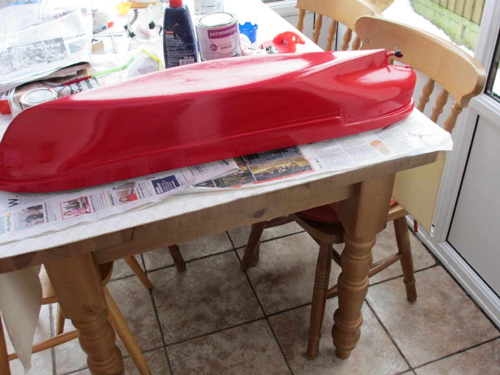

          Wayne. Looks good so far. Nice finish to the hull. Careful when doing the waterline, use fresh masking tape and press the edge well down…but I dont have to tell you that.
          A wheeze I have used when using Black below the water line (as your boat is flat bottomed) is to put the hull on a clear table and cut a block of wood to support a round nosed indelible marker pen, and draw the line on, sliding the block/pen around the hull…then paint up to the line with black paint…Dulux or whatever, I like heavy duty stuff below the water. Get a very sharp line this way, and its easy around the curves front and rear.
          What are you using for filler?? I can reccomend knifing putty or that stuff in a tube from model shops for filling your odd bits on the superstructure, as it is Cellulose based it dries well in the cold, bit better than water based products, polyfiller or what have you.

            thanks Ashley
            the filler is car body filler

              The hull finish has taken time with rubing down between coats.using painter touch water based gloss.I must admit I an not 100% sure that a water based gloss is the best ,but it is exterior grade and most paints nower days are not oil based.
