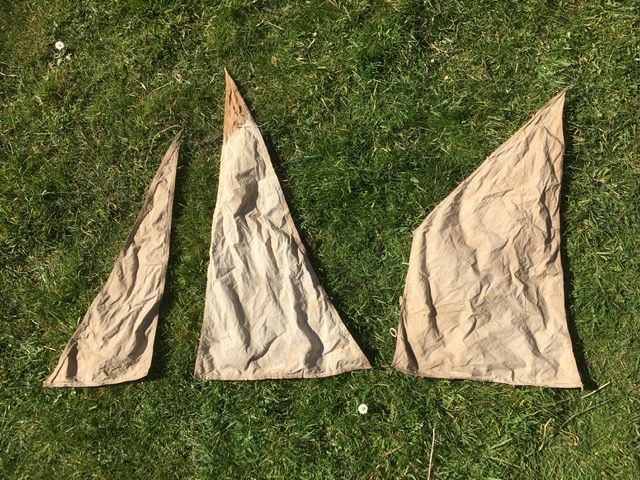

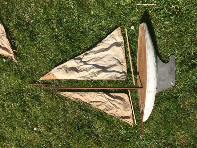

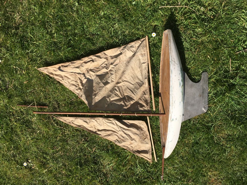

              Gaff rigSloop rigHere are some photos of the yacht and the sails. I think the ‘mainsail’ is too large to be a jib or topsail, but it might be. I have also made new booms and sanded the hull.
              #86613
              Zephyr Yachts
                @zephyryachts
                Here are all the sails together:Sails
                Edited By Zephyr Yachts on 08/04/2020 11:27:38

                        #86622
                          @timrowe83142
                          Zephyr
                          I think Malcolm has it.
                          Hope you can get it on the water soon.
                          Tim R
