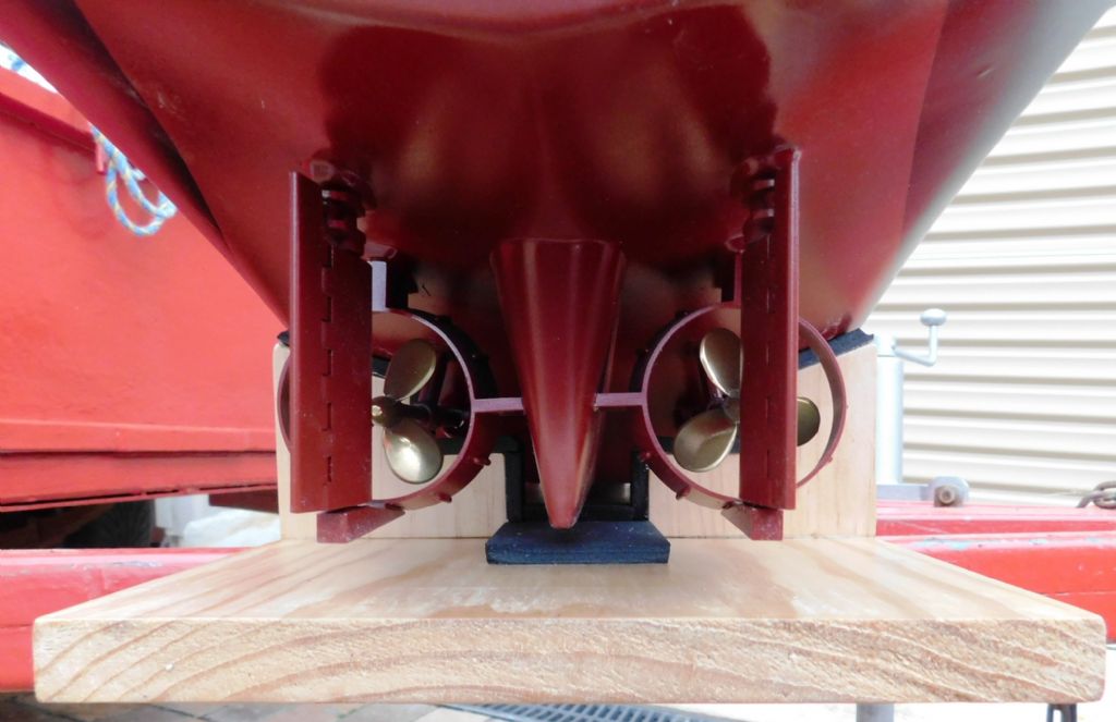

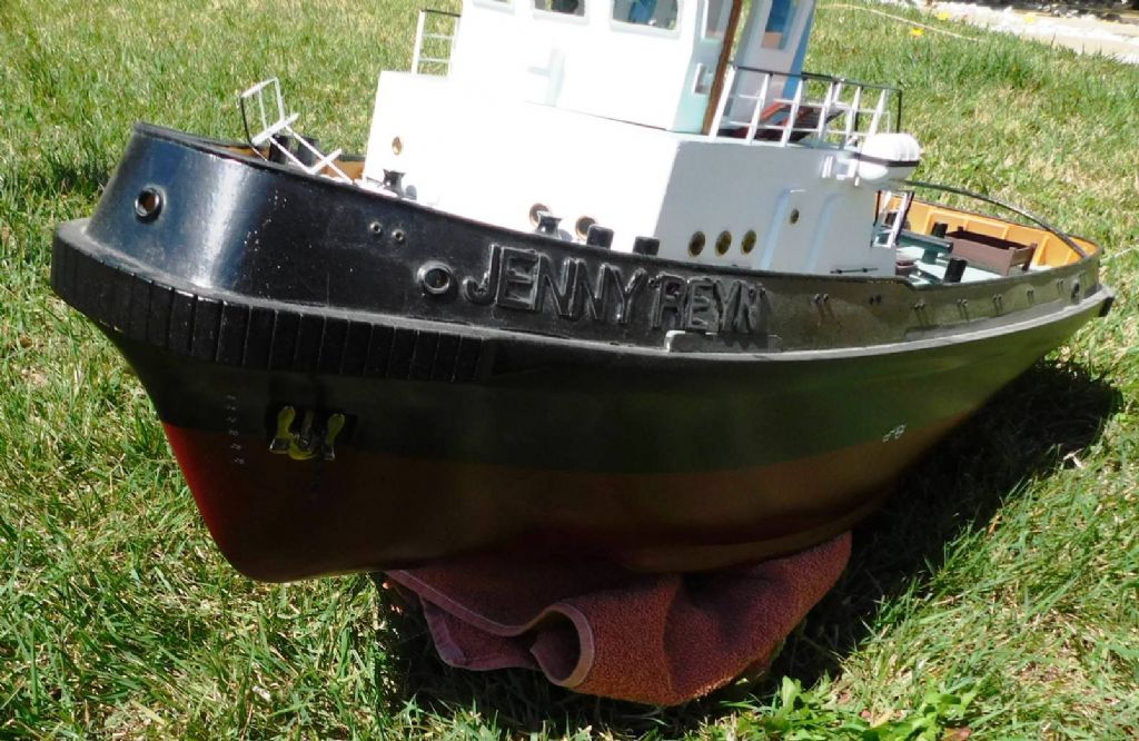

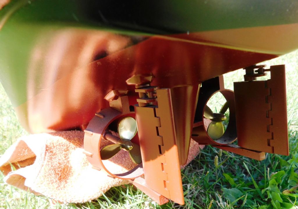

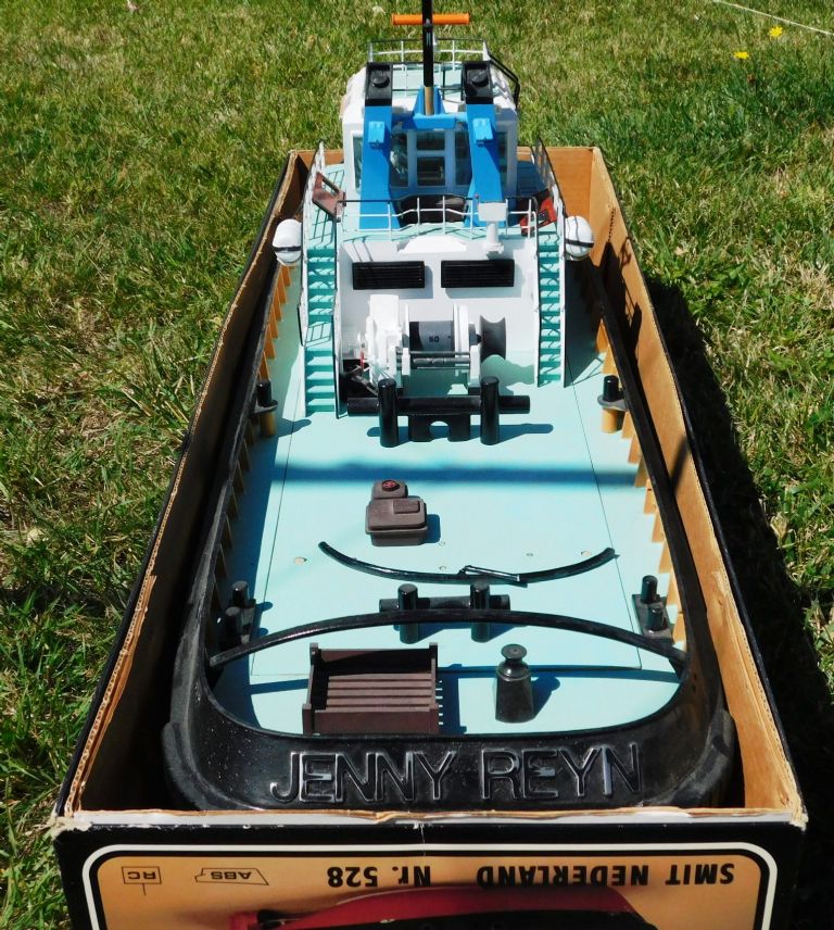

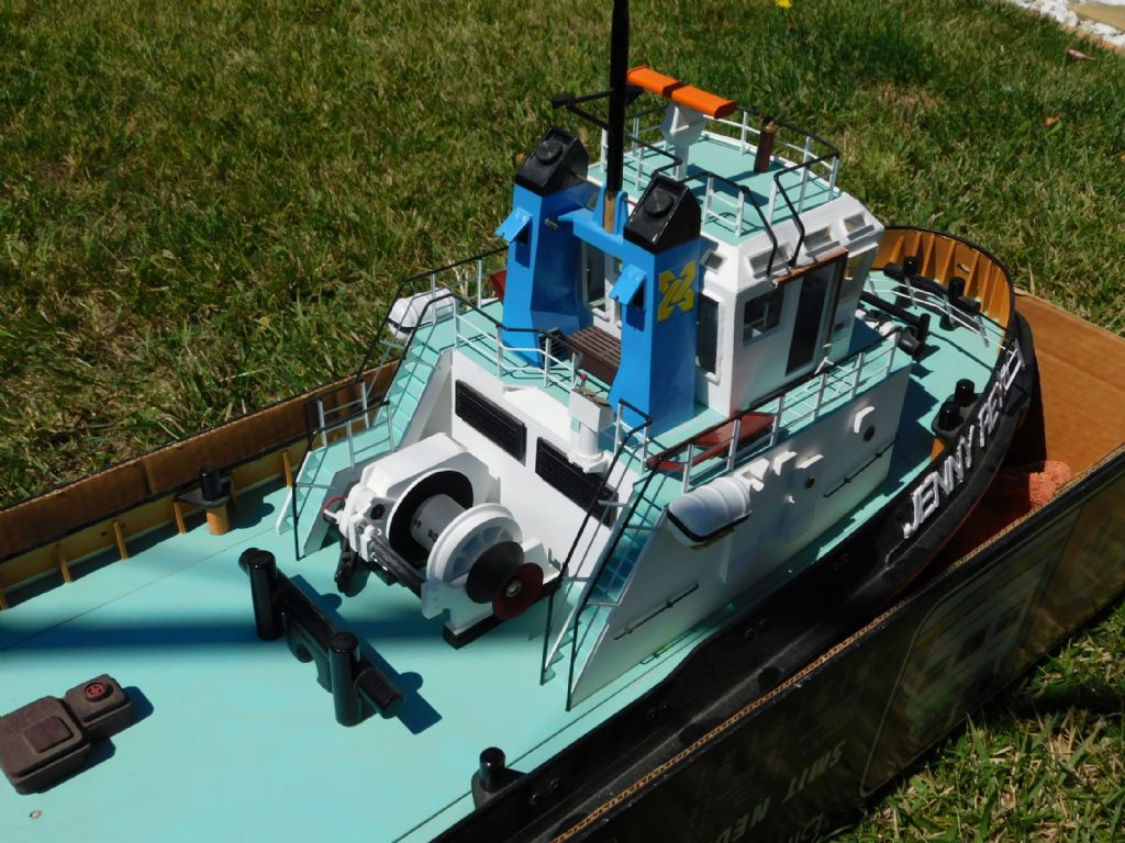

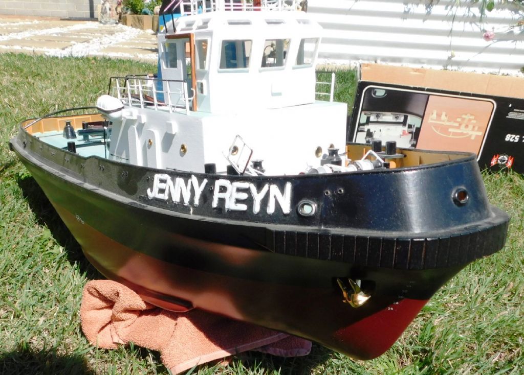

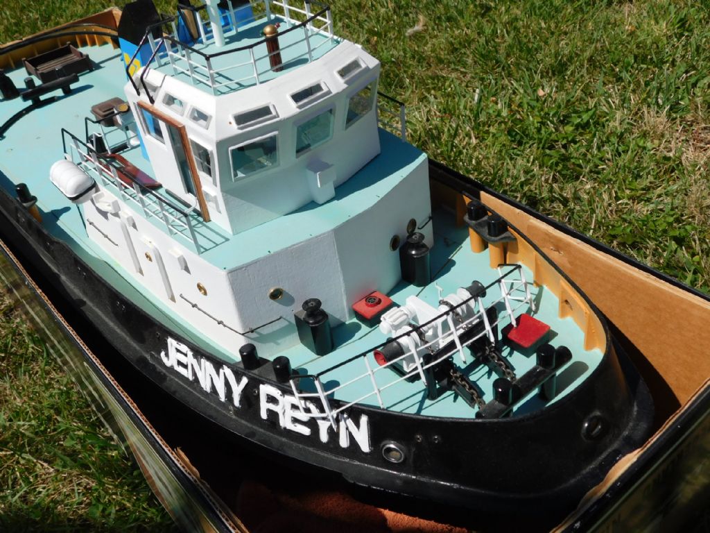

            stern view 5.jpgstern view 4.jpgstern view 3.jpgstern view 2.jpgstern view 1.jpgside view 3.jpgside view 2.jpgside view 1.jpgbow view 4.jpgbow view 3.jpgbow view 2.jpgHi All
            First I would like to thank redpmg for pointing me to the Billings Website.
            That is wot this forum is about, helping fellow members.

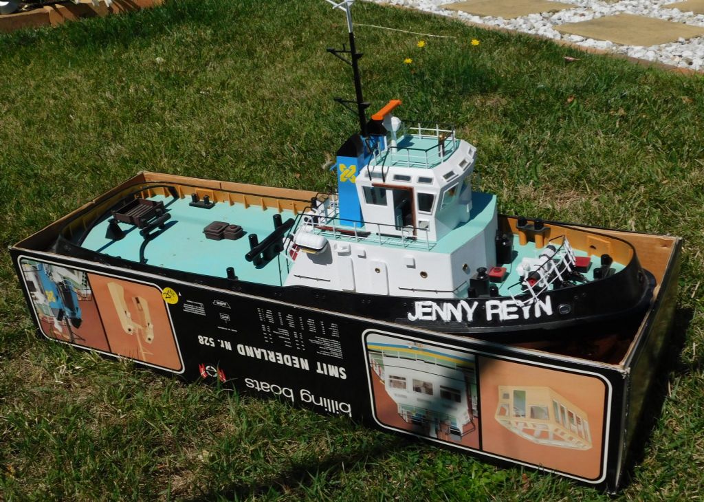

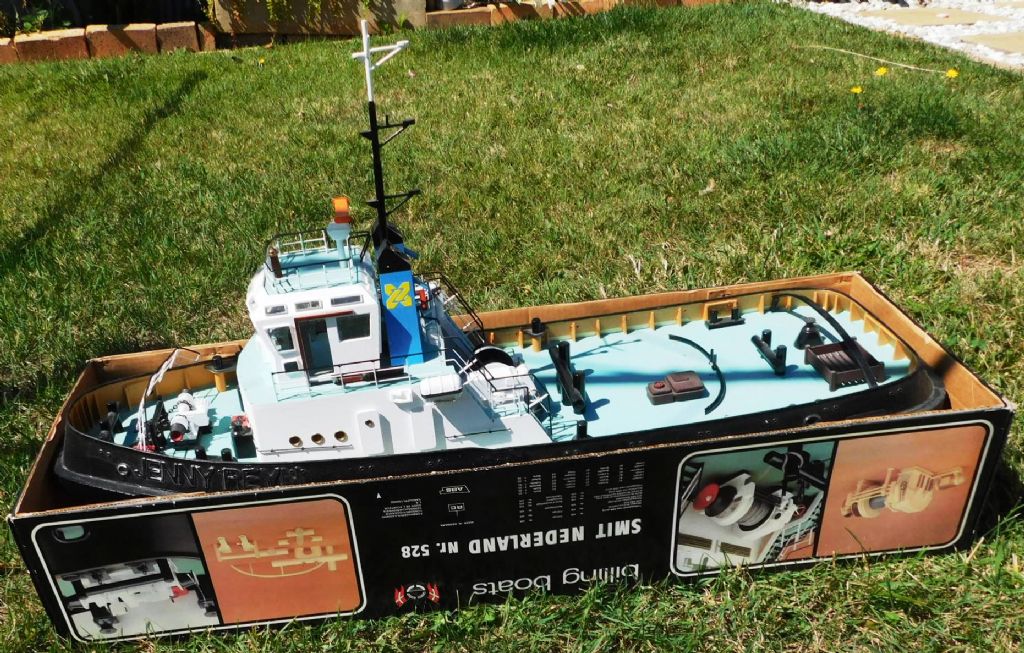

            Well I pickup the boat this morning.
            Only a few bits broken off and the three vents missing from the stern.
            Will be interesting to drive with Nozzles and Becker rudders.

                Hi red
                South Australia ???
                The boat was from a local auction site .
                The white over paint removed from one boat name which was a pain !!!
                Matt black and heading into the same look as the stern name plate.

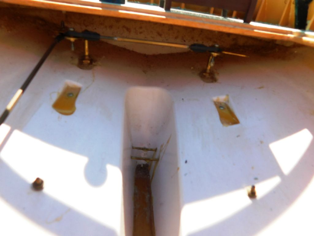

                Ripped out the motor mounts and making a stand for the boat.
                Made new alloy motor mounts.
                Also making a stand for the boat.
                Harry

                  Hi All

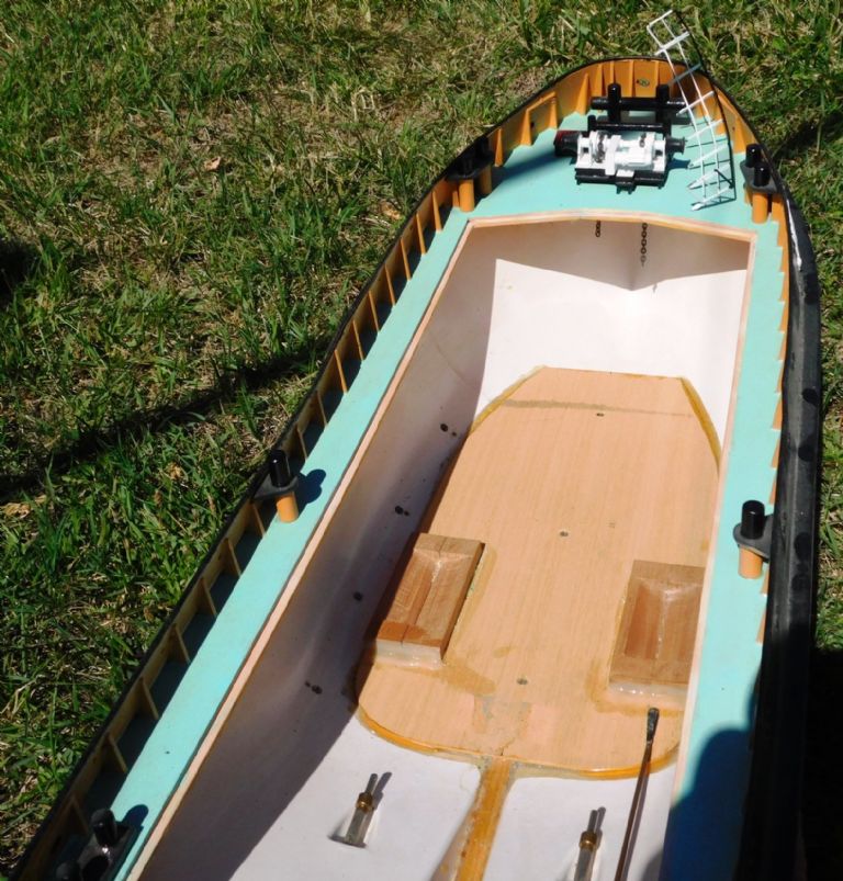

                  Regluing the motor mount base back down to the hull.
                  Drilled eight holes in it and adding filler foam to stiffen up the hull bottom.
                  Main job today was making a boat stand, also added 30mm door stoppers under the stand for feet.
                  Harry

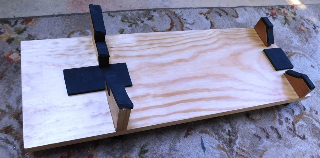

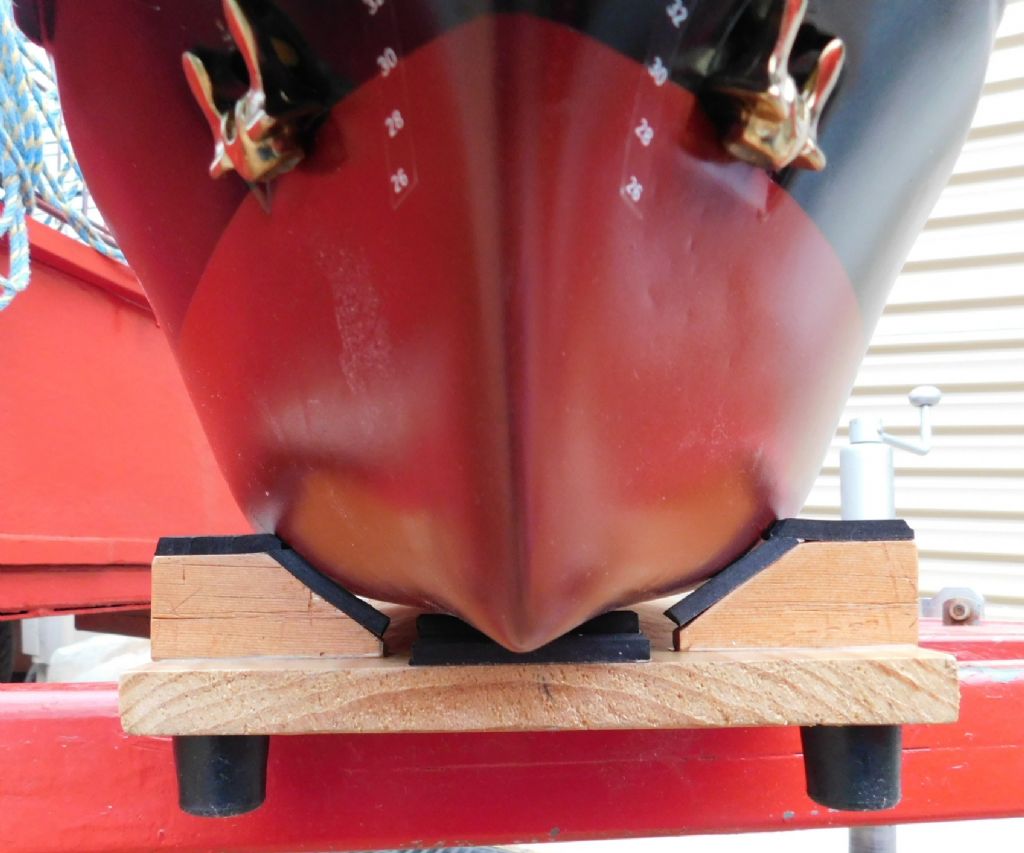

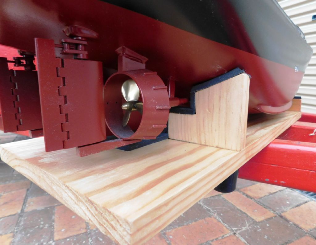

                    main winch.jpgmotors escs batteries.jpgbow view 5.jpgboat stand 4.jpgboat stand 3.jpgboat stand 2.jpgHi All
                    Finally got the stand finished.
                    The filler foam has work out well (under the plywood base)and should make a solid platform for the motors, etc.
                    Starting on the rudder servo mount next and melting some lead for the weights.
                    No idea of weight I will require !!!
                    The boat ramp is only a 1/4 Km from home .

                      Hi All
                      First dip in the water today to add the ballast.
                      Also added servo mount and setup the radio system for tank steering.
                      Harry

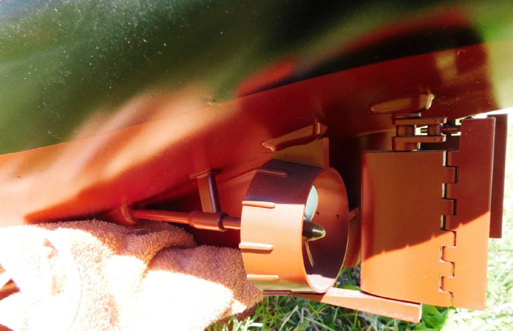

                        I wonder if there is any discernible difference in performance between squared off prop-ends and ordinary props when running in cowls?
                        Good work as usual Harry. Boat ramp only 1/4 km (whatever that is) from home…ah, boating on demand…
                        #93910
                          Hi Ashley
                          I think it would make a difference, mainly blade area.
                          Yes a full scale boat ramp to launch cabin cruisers/ tinnies, etc.

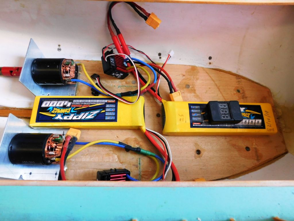

                          Fully installed the drive systems with silicon grease in the shafts and thread lock on the proips.
                          Mounted the two 4000mah Lipo batteries.
                          Removed the red wire from the second ESC/ mounted the ESCs and receiver.
                          After mounting the batteries the lead blocks would not fit each side !!!
                          I cut one down( it had more weight than the other) and fits OK.
                          The bow weights are round, so change them to recut bits.
                          A little hit or two with the 2 pound hammer and a touch with the file, nice fit.
                          So I have mess up my ballast test a bit !!!!
                          Harry
