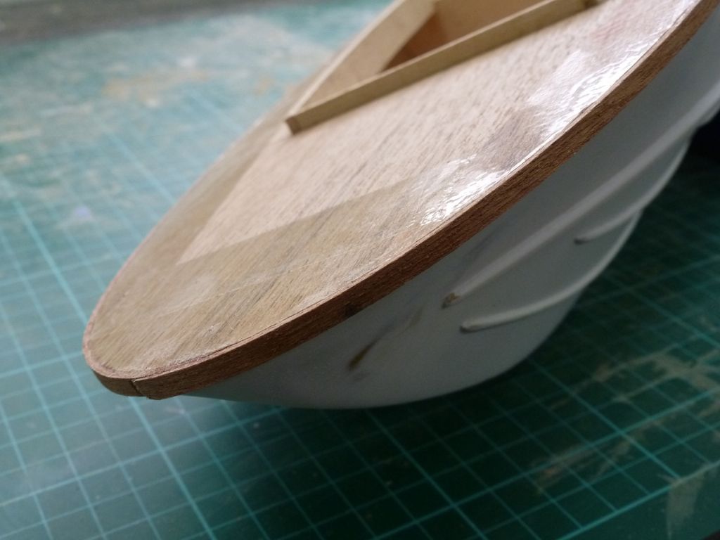

            As you've found, it doesn't help to try to glue hardwood strip without bending it first. I always hold the stuff in the steam from a kettle (with the lid off) and hold the bend while it cools. Glue it in place about 100mm at a time, holding that steady for a minute or so before moving on to the next section. It works for me. Pic shows 1.5mm x 3mm mahogany rubbing strip, fixed along sanded edge of Huntsman deck with Slo-Zap as described.
            Mahogany isn't known to like superglue overmuch so any help you can give it is worth doing. If you continue to have problems then consider using something much more flexible, like bass/lime. This is what I use for the chine and spray rails on my models. You'll find it will also take dark woodstain very easily.
