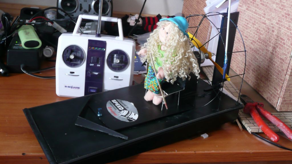

            hi KEITH, hows skimmer coming on ?………
            here is mine now ready for testing……
            LARRY

                  Larry, normally I advocate crew on a boat, but……
                  AShley

                    @larrywhetton68737
                    HI ASHLEY just a bad hair day ………LARRY.

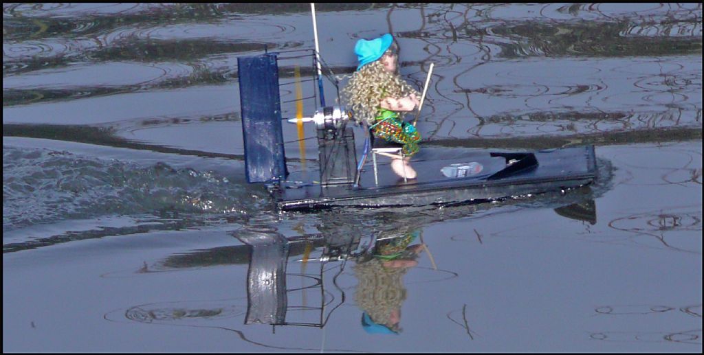

                    LARRY WHETTON
                      @larrywhetton68737
                      well it WENT quite well , but to much draft took on water ,will add a bit of buoyancy……..
                      well it is a swamp boat ………..LARRY..

                                  Larry
                                  My Skimmer was built to Glynn’s plan, went like greased weasel poo, and used a Speed 400 7.2v motor, a Graupner 2-blade 6″ x 3″ airscrew and a 6 cell AA-sized NiCad pack. I reckon your battery pack is much heavier than this so I’d suggest a power transplant., using either NiMH AA cells or maybe a 2-cell LiPo pack (7.4v).
                                  Hope this helps – oh, and slowing down a bit to take corners is definitely a good idea!
