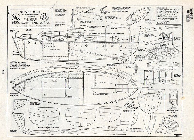

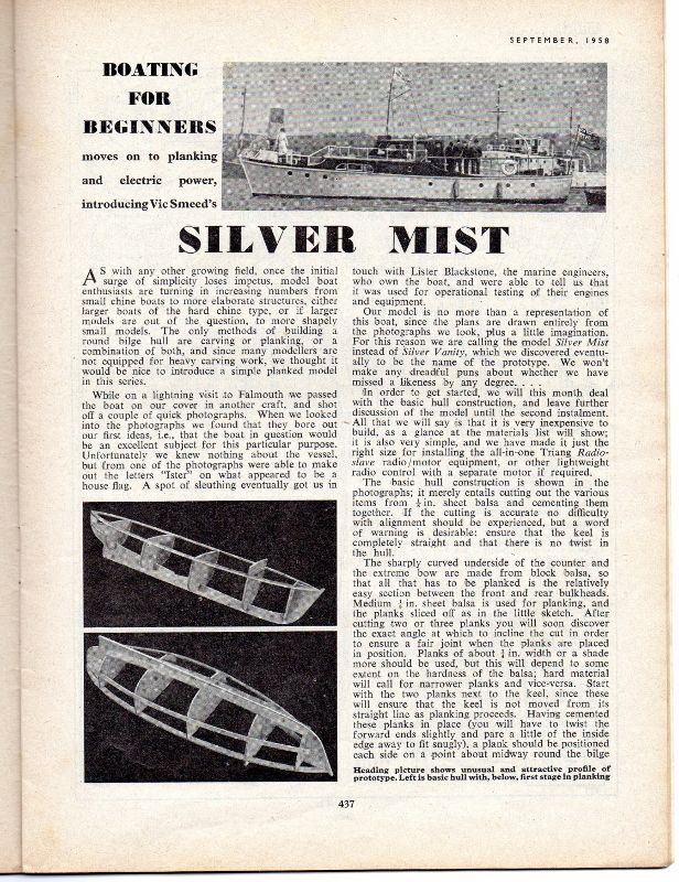

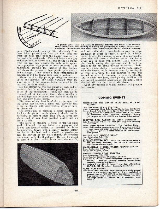

                                      #39935
                                      Barry Gibson
                                        @barrygibson15259
                                        img007 (590x800).jpgimg006 (800x577).jpgimg004 (616x800).jpgimg005 (613x800).jpg
                                        From the 'Model Maker' September 1958.
                                        Edited By Barry Gibson on 27/03/2013 10:39:13

                                            First of all,isn't it lovely to see that old Model Maker article- I must search ebay and see if I can get my hands on one. Thanks for posting Barry.
                                            Dave, thanks for the offer of help with my Rapier. I will send you a private message describing the problems I have had- I'm sure you will have some ideas. At the moment it's slung in the shed in disgrace but I expect I will simmer down and have another go with it!
                                            All the best….Ian
                                            #39961
                                            Ian Gardner
                                              @iangardner62867
                                              By the way, Barry, any chance of a scanned copy of that Silver Mist article? I know of another gent who might be interested too and I could pass it on.
                                              Ian
                                              #39967
                                              Barry Gibson
                                                @barrygibson15259
                                                PM me your email address and I'll send a copy to you.
                                                Edited By Barry Gibson on 28/03/2013 22:17:51
