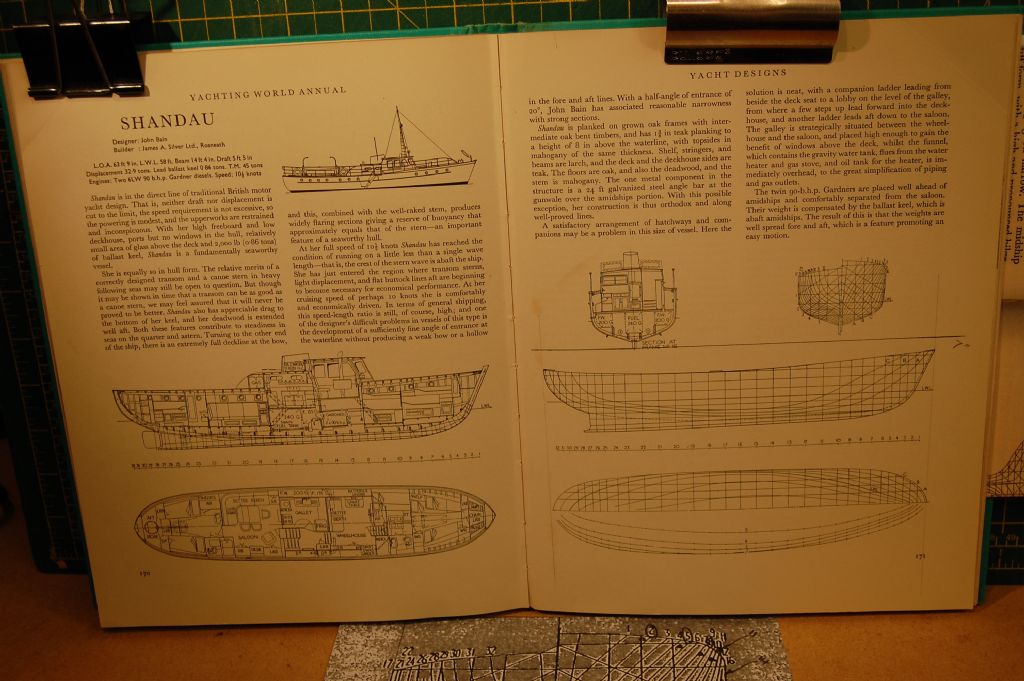

      shandau ym 2.jpgHi All,
      Well enough of the recent plywood bashing, time for a nice balsa planked displacement hull with some nice mahoganyshandau ym.jpg brightwork, the actual boat resides in the Netherland and is in lovely condition, on the drawing board at the moment drafting the bulkheads
      #7232
        1/24th Scale Gentlemans yacht – James A Silver – Rosneath

                I just don't use my motor boats down the lake
                Hi Tim,
                1957 Yachting World Annual, came across it at a charity shop in Maldon Essex a couple of years ago, Gold Dust like winnig the Lottery
                Hi Colin,
                Yes those brokers photos on lineshandau2.jpg clinched it for me, but non of the deck I'm going for portlights, I don't like the modern long window as it is now  she will be 30" long 1/24th scale.

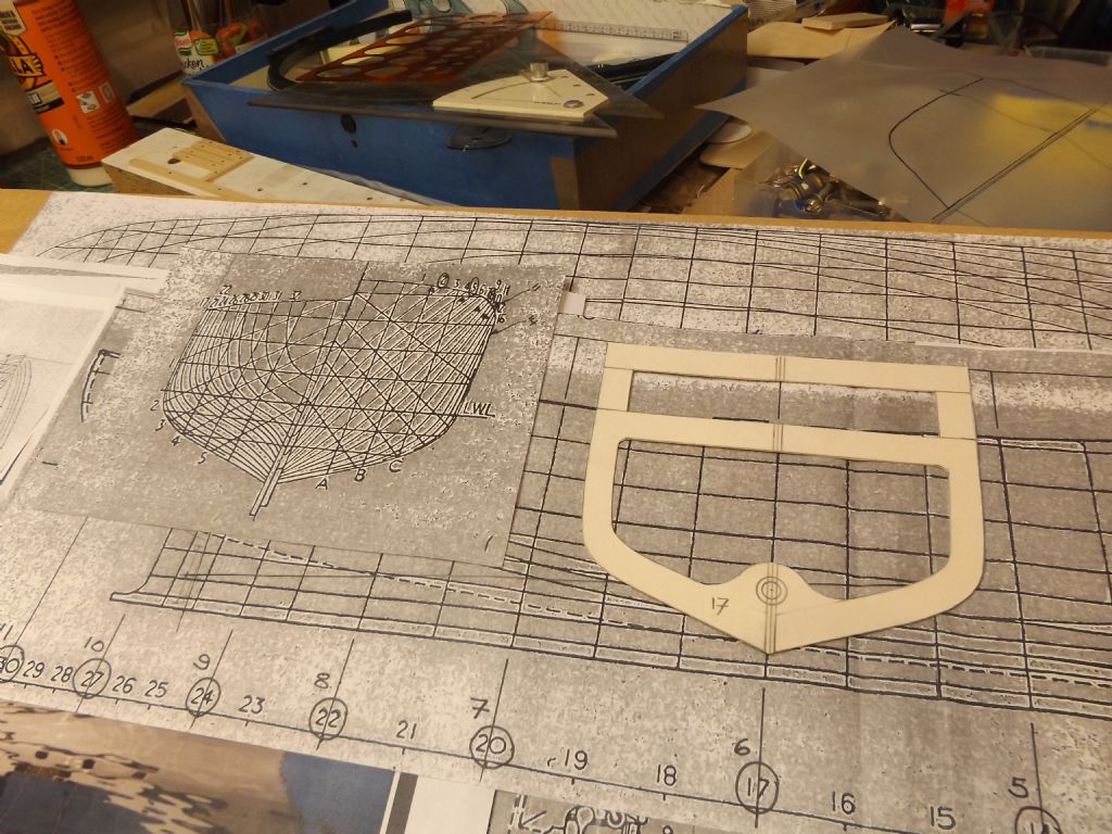

                          #102334
                            The first bulkhead traced from the sections and transferred on to cereal packet card so if she ever gets to being published as a plan I only have to draw round the template, first of many !! 6" beam

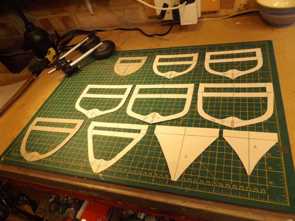

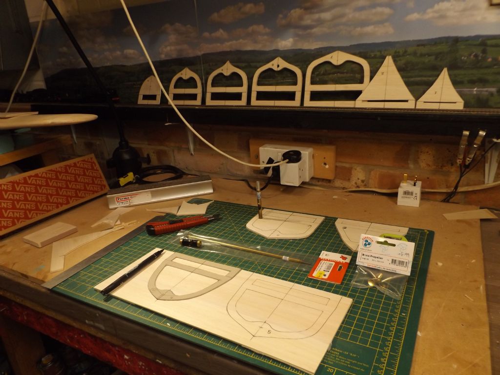

                              #102404
                                Well that's the tedious part done of tracing the bulkhead shapes onto card for the templates to draw round will go with my cross laminated balsa 1/16" sheet bulkheads & ply keel, which worked well on MS Oldenburg
                                This approach maybe of interest to anybody who fancy's next month's Jim Pottinger's free trawler plan to build, rather a shame he doesn't draft the bulkhead & keel shapes on the plan ! I think many more people would build them ?? I have built 2 of his designs the Spanish fishing boat & FT Everard's MS Stability.
                                Hi Harry,
                                I just "Control" & "Print Screen" screen for photo's and paste into a Word document to print them

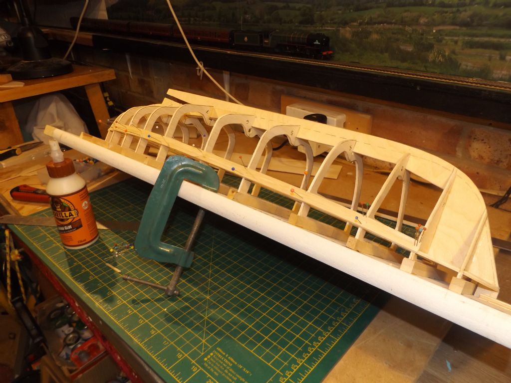

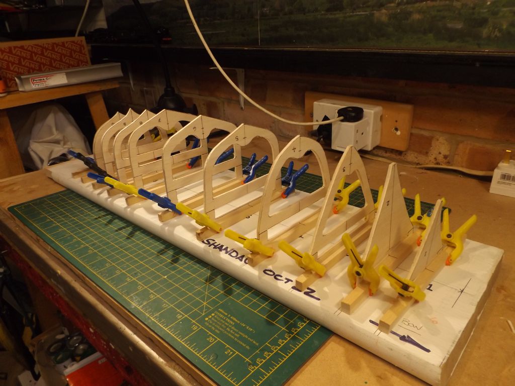

                                            #102515
                                              Hi Neil,
                                              Yes, she has lovely lines and looks very fast !! the attraction is in the varnished timber and has some interesting challenges ahead with curved hardwood handrails !!.
                                              All the bulkhead's have the mounting peices glued across from scrap timber cut on the bandsaw, the adjustable fence is brilliant
                                              Keel from 1/8th plywood next and cut the notches in the bulkheads to suit.

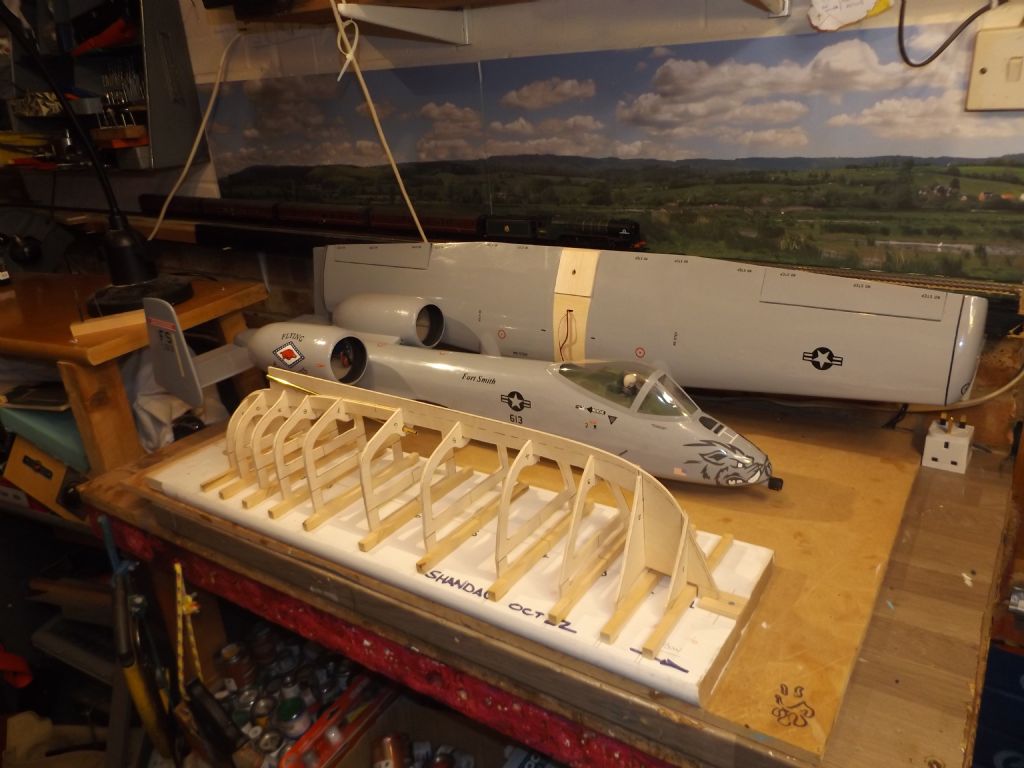

                                                Shandau is starting to look boat shape , next stage planking the centre section with Styrofoam bow & stern blocks.
                                                And Ooops my new toy behind it !! Built as the prototype model for an RCM&E free plan recently published, this is an A10 Tank Buster with twin electric ducted fans, designed and built by Tony Nijhuis who was having a hanger clearance

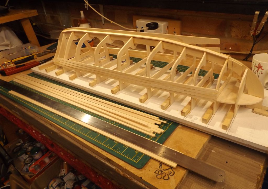

                                                  #102595
                                                    shandau6.jpgHi All,
                                                    I know most of you have seen me do this before ! but the 1/8" balsa planking is coming along at a pace now
                                                    One of the most useful items I have is a 1m steel rule metric and imperial ideal for cutting the 1/4" wide planks from sheet. It was £48 many years ago when I was building steam locomotives, but well worth the money
