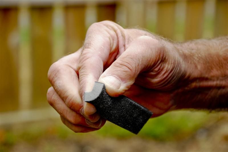

      I am finish shaping and sanding the hull of the Spanish trawler that I am building. It didn’t help that I brushed a layer of sealer undercoat on, thinking to give a good thick layer to fill small imperfections. I ended up with a plowed field effect and had to sand it all off. this was not going well for me, as my fingers always seemed to be in the way and the sandpaper was following irregularities rather than blend them out and it was taking for ever. I hit apon the idea of using one of those sponge sanding blocks, this worked so well that I bought another one and cut it into strips and thin layers to get at the concave curves. See photos.
      I would be interested to here of other peoples methods of sanding in awkward places and any tools that can be used to help with this process. I find the concave parts the worst to do and internal corners like where the planking meets the keel.

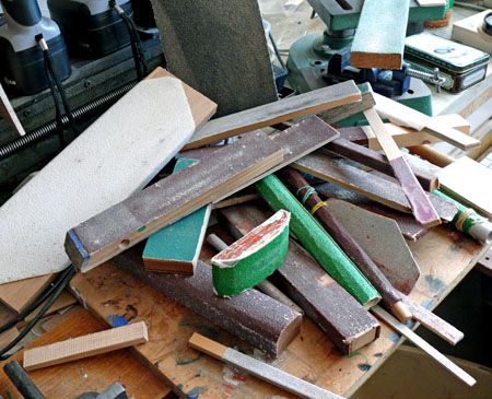

          Hello David
          I have a vast stock of sanding blocks………….all shapes and sizes………and like I`ve said earlier………….there`s nothing more delightful than a fresh coarse sanding block!
          The trick of cutting abrasive paper, is too cut from the backing side with a razor saw and instead of wearing down the saw teeth, the abrasive grains simply get pushed off the surface
          Just a passing thought…………..Bob

            #18478
              Hello David
              The special shaped sanding blocks I use PVA glued on abrasives. but for general purpose sanding, I simply use staples

                I am wondering if one could make a mini oscillating sander from an electric tooth brush, for those difficult to get at places.
                David.

                    #18484
                      Assorted sanding blocks
                      #18485
