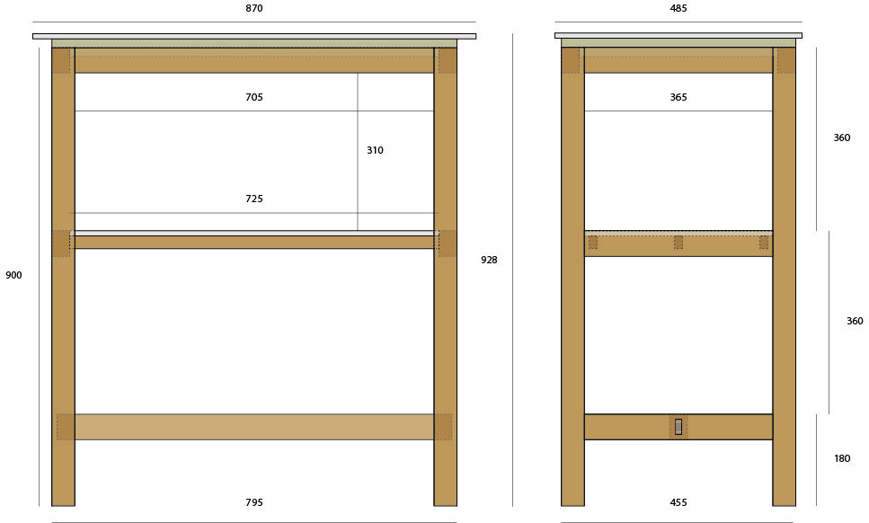

Well, yes, I am currently building summat, but not anything at all boat or ship shaped, I'm afraid, as right now I'm busy making a small table to use as a sharpening station in my workshop, based around two old offcuts of Corian that I saved from a kitchen renovation some 15 or so years ago; they will of course make up the top and shelf, being nice, smooth, flat, water proof and very easy to wipe clean.
This is my sketch for the project (all measurements in mm):

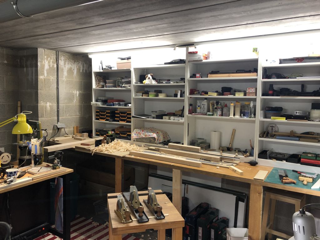

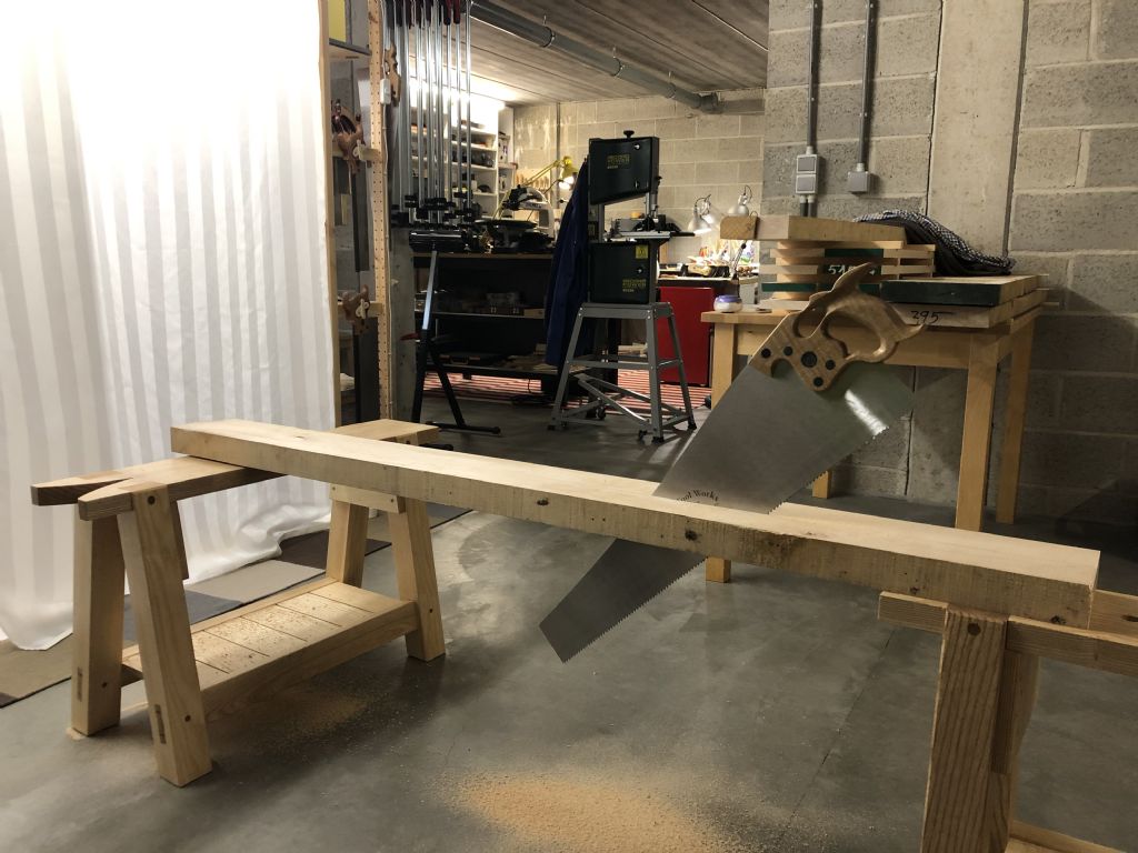

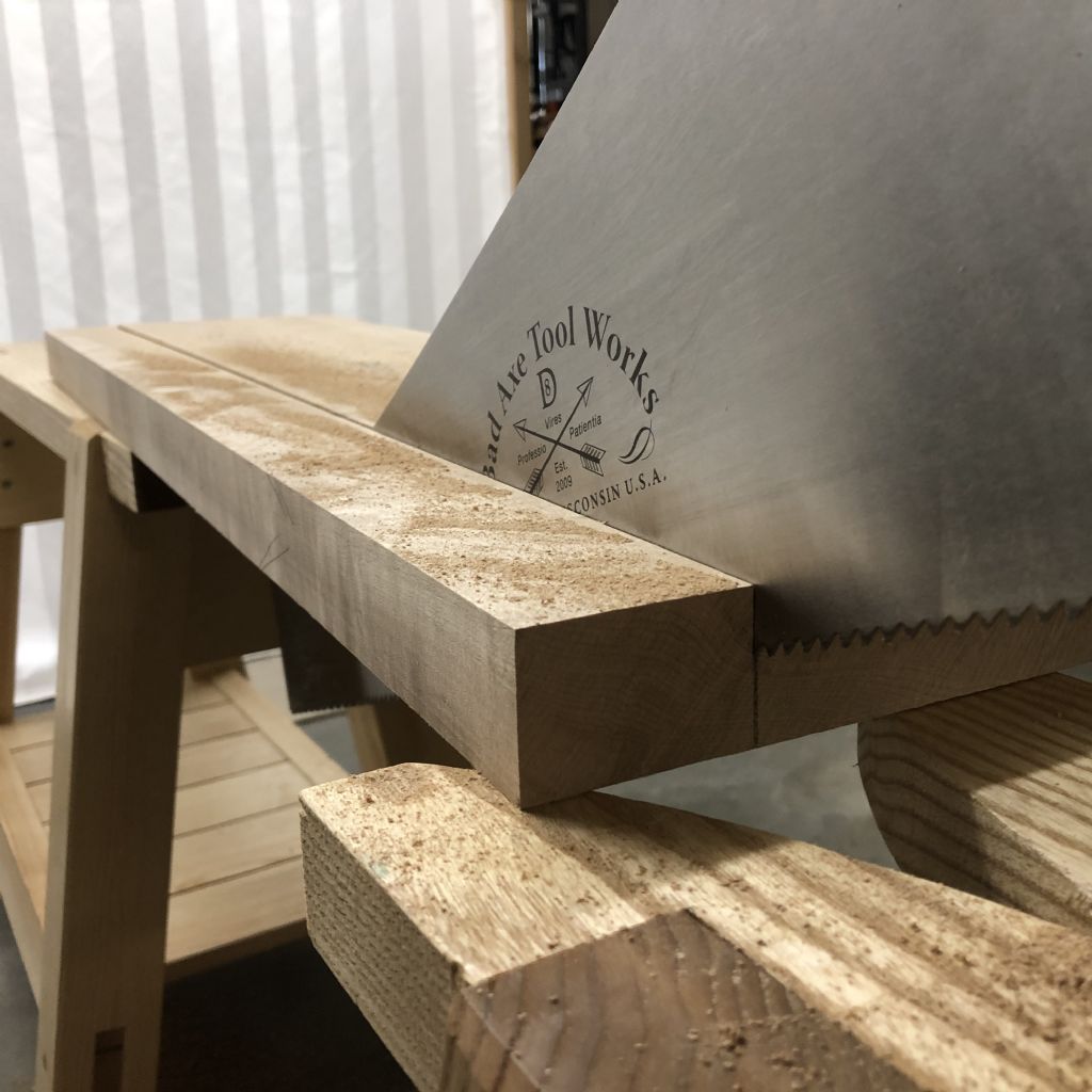

Apart from giving me a dedicated sharpening station (which is handy, as it can go next to the workshop sink, and have the most frequently used stones permanently set out and ready), the project is also a test of my own mettle against American hard maple as a timber, as that is what I'd like to use for an upcoming work bench build; I thus started this particular job by ripping and cross cutting a couple of raw planks of 8/4 and 6/4 hard maple …
… to break the stock down to rough size …

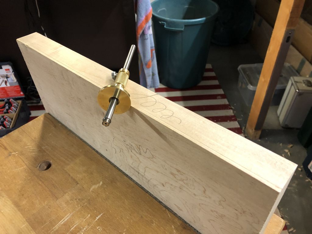

… before hand planing it smooth, to thickness …
… to width and foursquare.

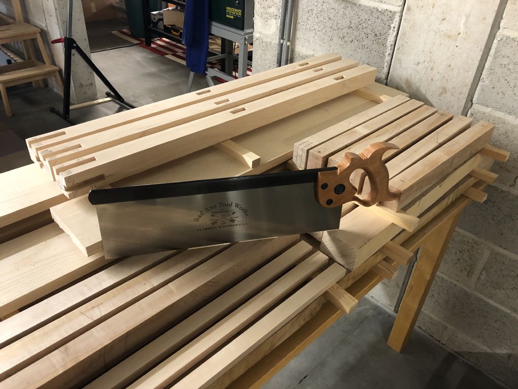

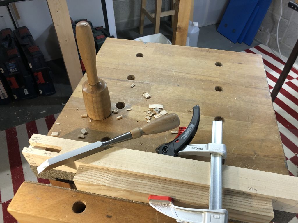

Right now I'm chopping out the mortises in the legs …
… after which it'll be time to saw the tenons on the rails.
