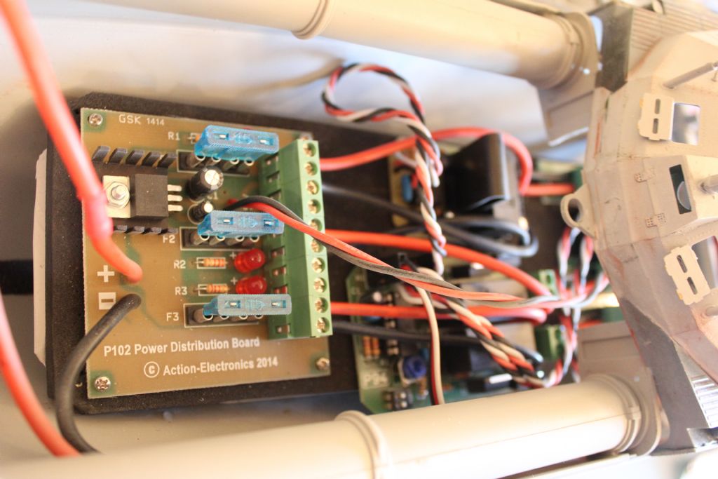

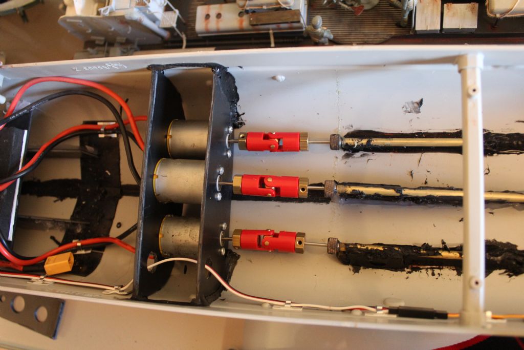

                    #70550
                    Phil Childs
                      @philchilds35947
                      #70551
                        Phil
                        Your installation appears OK. If there was a problem then either something would have blown – e.g. a fuse – or nothing would work at all. Electronics aren't generally "sticky" like prop shafts and couplings can be; they either work or they just sit and sulk. It's entirely possible that I built every ACTion gizmo in your boat myself so I'd like to think that they work properly!
                        There's no substitute for knowing what's going on when the boat is sailing, so I always recommend fitting a small Wattmeter between the battery and the ESC [in your case between the battery and the PD board]. This will record the maximum current drawn by the system which, for 3 x 380 motors, should be less than 30A in total. This is the one I use – others are available **LINK**
                        For the prop diameter you need to find out the size of circular hole which will touch each prop tip i.e. just allow the prop to pass through it. You can approximate this by measuring from the centre of the prop boss to the tip of one blade, then multiply by 2.
                        If you want to go brushless then I'd suggest you start with something like this x 3 **LINK** but bear in mind that all of that ACTion stuff will be redundant and you'll then need 3 x brushless marine ESCs and a 3S or 4S LiPo pack. Three new props would be a helluva lot cheaper.

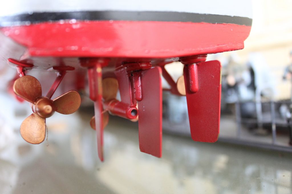

                        #70552
                        Empire Parkstone
                          @empireparkstone
                          Phil scaling your Pic to actual physical size (about 6'' across not maybe that accurate those props are coming out at almost 40mm? did you modify the rudders and confirm it is the Italeri model '
                          #70553
                          Phil Childs
                            @philchilds35947
                            Hi Dave,
                            I wasn't suggesting there was a problem with the electronics them selves, just that i may have set them up wrong.
                            I have measured the props and it would appear they are 30mm.
                            #70554
                            Phil Childs
                              @philchilds35947
                              Hi Empire, it is the Italeri 1/35 model, i did a bit of research on the rudders and it seemed the general consensus was to over scale them so i used two of the smallest brass rudders and the second smallest, i have found getting any info from SHG was difficult, but as they do the kit based on Dave Abbots build i just asked for that, but never knew the prop size or pitch.
