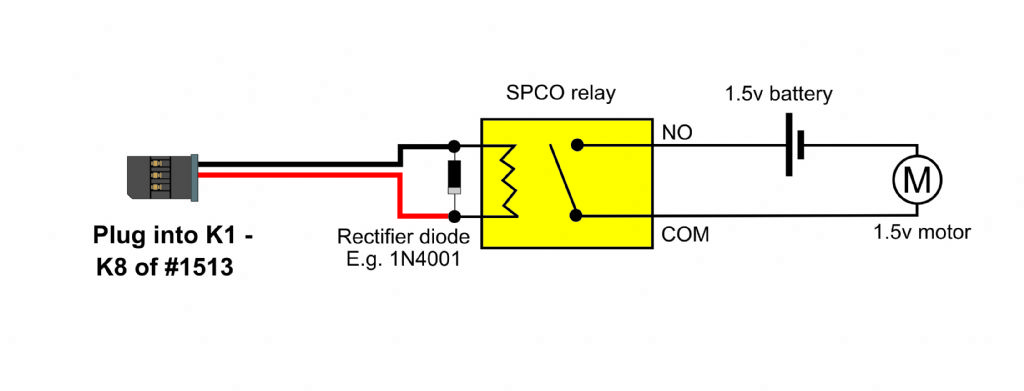

              #68664
                Guido
                This circuit will do the job and cost a lot less than anything Robbe ever listed for it. It could be built for a cost of a couple of pounds on a scrap piece of stripboard.
                Notes:
                The voltage of the relay coil should be the same as the input voltage to #1513 BATT socket (4.8v – 12v). For example, if you use a 4-cell pack (4.8v) then choose a relay with a 5v coil.
                The relay contacts should be capable of carrying the maximum current drawn under load by the motor.
                Use whichever K socket on #1513 corresponds to the switch on the Tx module which you want to use to operate the motor.
                (If it really was rocket science then I'd be nowhere in sight.)

                  Just a couple of questions, out of sheer ignorance and due not living int he UK (so I can buy the right components): what's the meaning of "SPCO" relay? And I assume the diode code should also be in accordance withe the coil voltage?
                  #68669
                    SPCO = Single Pole ChangeOver (It will have two coil pins plus one each Common, Normally Open and Normally Closed contacts)
                    Just fit a 1N4007. It'll block anything to 1000v.
