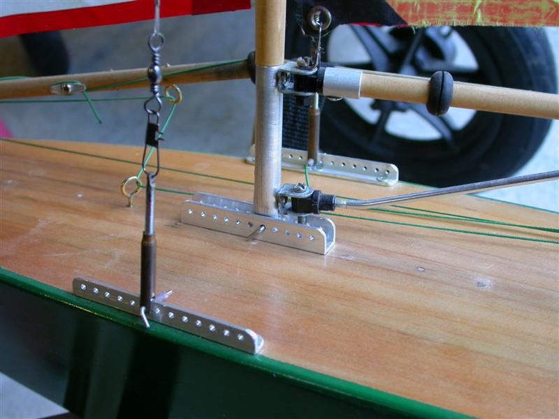

          Hi Rick.
          Here is a method that works for me and allows me to tune the position of the mast fore and aft to give best performance.
          Cheers.
          David.

            Thanks David, That has given me a couple of ideas to play with.
            I wont need the for and aft bit as it is only for casual relaxed sailing, but the methods are food for thought!
            thanks again
            Rick

                Hi Ashley.
                Would you believe the wheel allows me to sail when the pond is frozen? Well how about, it is the wheel of my granddaughters pushchair.
                The little green yacht it 700mm long and the mast a little over 900mm tall. The mast is 10mm dia dowelling and the booms are 8mm dowel. I would think 8mm dia dowel would be enough for a mast 500 long. Or you could taper a 10mm dowel if you were so inclined.
