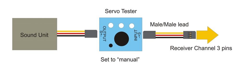

                    If you want to hear the sound all of the time then why not buy a cheap servo tester and connect the sound unit to its output? You can connect the power input via a male-to-male servo lead to the spare Rx pins, turn the servo tester to Manual and set it to run the sound continuously. Here's one but there are many others, some for less than two pounds.
                    Servo Tester

                    Peter Brown 15
                      @peterbrown15
                      Thanks Dave, I will give it a go as it’s pocket money price. Hopefully arrive before Xmas. I will let you know how I get along with it.
