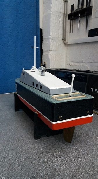

                      New turret and gunner :
                      #85031
                      Dave Cooper 6
                        @davecooper6

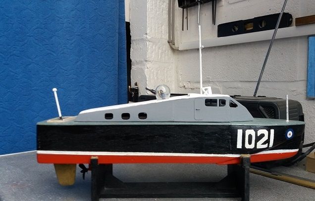

                        Latest side view (painting in progress) :

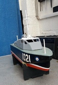

                          Front starboard side :

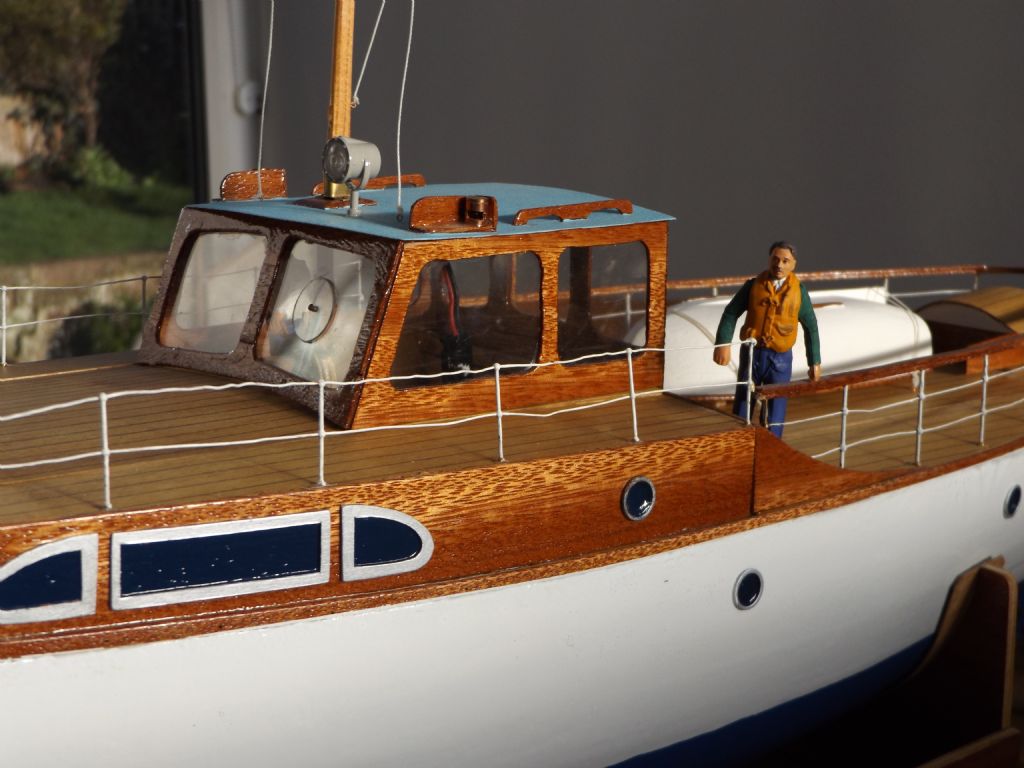

                                    Hi all,
                                    Here is the clear view screen on Silver Mist , a second disc of acetate with a 1/32" brass rivet in the centre with a small rubber band from the motor drive.@ 1-24th scale 😀

                                      Ray – Your 'clearview' looks better than mine. As above, got cyano inside one (will I ever learn !), but used epoxy on the port side. I rough-sawed a piece of 2.5 mm acrylic sheet, tidied it up on the bench grinder and then put it into the Dremel to turn down to size after drilling a 2mm hole through the centre. It's probably over-scale but seems to look ok. I used a small nail head for the centre 'pivot'.

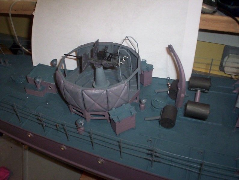

                                        0f2db040-966e-445e-ac7b-d5bb059e79f7.jpegHacking about soft balsa is a no-no as far as I would be concerned due to the difficulty of filling the grain afterwards prior to painting. I realise a slightly rough texture is required, but…
                                        Roll out a thin square (or woteva) of Clay and you can spend ages fiddling with it to get the right look, can texture it up when happy with a stiff brush, and hey presto!
                                        The hessian can be laid in ‘mats’ or scrunched up a bit using thread poked through with a needle. Attached snap of landing craft.note that no attempt to Be artistic has been used in this application, I just folded it and glued it on. It gives you an idea of the sort of effect you could create?
                                        Edited By ashley needham on 01/02/2020 09:45:55
                                        Edited By ashley needham on 01/02/2020 09:47:11

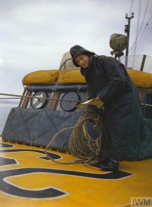

                                          The ones in my documentation are a grey rectangular sort of padding (bit like a mattress /giant pillow), with a 'hot-cross bun' pattern on the front face. Maybe they aren't A-A but some sort of flotation device ?
                                          They look to be canvass covered and are usually arranged just under and around the wheelhouse /gunner /sickbay areas…
                                          I'll see if I can locate a photo or two.

                                              I think you can see them under the wheelhouse windows and just behind the forward deck lockers in the above Airfix box art…
                                              That reminds me, I probably need to make a search light as well !
