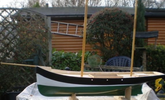

          This is the boat! I missed the original Message!

            Hello James
            You`ve been digging about in the archives?………..All those old threads you`ve dragged up!
            Your model looks very neat and tidy…………Is it a plan from somewhere?
            Looking at your hull, you don`t seem to have allowed for an additional keel in the build?
            What are you going to fasten the keel bar to?
            I would recommend a central box and mount the keel assembly in that……..and then you could have a few keel depths to play about with?
            You`ll find a similar keel in my Louis Heloise gallery
