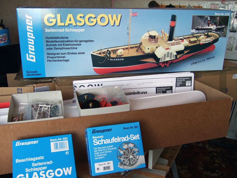

              Now then, what`s in the box?
              I was very pleased with the contents and the very neat packaging and consider this a fine start!……Pity I didn`t order the various glues required!
              The feathering paddle wheels look interesting!
              I love tricky mechanisms!

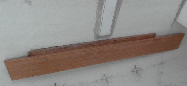

                                There you go Bob, First panel epoxied to Side wall, just placed in and a piece of Plasticard bent in to hold it in place and then second panel to that wood glued and screwed, you won't move that.

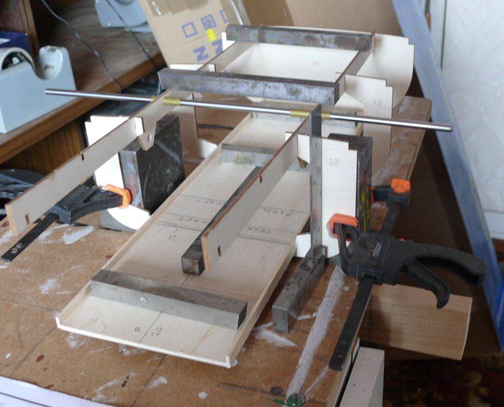

                                          A rather confused picture of the paddle drive framework
                                          Quite a trick assembly to align due to the lack of reference surfaces

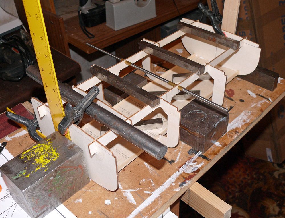

                                            The final glueing stage………Hopefully all is shipshape and tidy?
                                            The endwalls and tray needed to have reference centre lines for accurate alignment
                                            I would be interested to hear any comments from previous builders on the section?

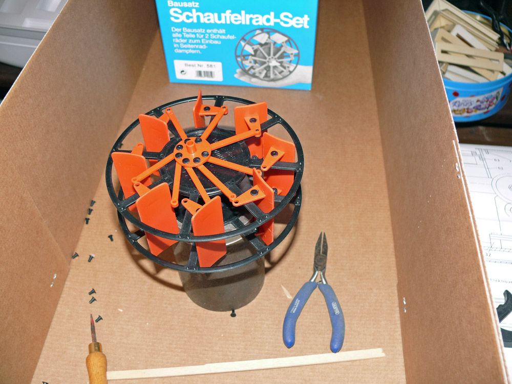

                                              While the glue sets, time to make a start on the paddlewheels
                                              All the parts are nicely made, but rather fiddly to assemble…….Note the box container to prevent those little pesky pivot pins from getting away!
                                              I hope there are a few spares in the kit!
