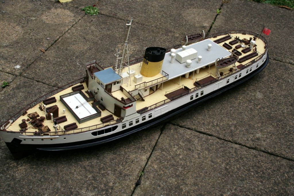

                          Bob's Boards had their place in their time if you had a low power low voltage application. My 33 inch long Shanklin was a very successful MPBA regatta boat in the early 1980s and depended on two Bob's Boards and several microswitches to give very effective mixing to the extent it could turn in its own length on 27Meg 2 channel radio.
                          I don't understand the wiring circuits anymore though!
                          MV Shanklin

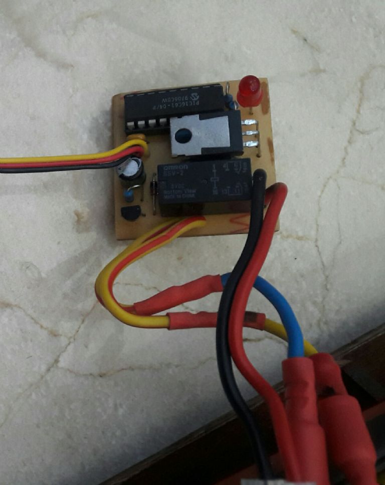

                            Hi all and thanks for the responses. The ESC is unbranded, and there is nothing that can be adjusted as far as I can see. The larger of the two black components (see photo) is marked Omron, according to a web search it is a signal relay. That doesn't help me though….

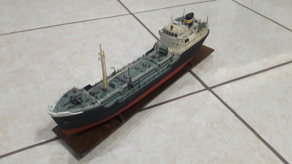

                            I'm wondering if I should just invest in a new, branded ESC? If so, grateful for suggestions. The boat is a coastal tanker about 15" in length and driven by one small electric motor. There is a small servo for the rudder (which works fine). It uses 8 x AA batteries.
                            Photos follow shortly.

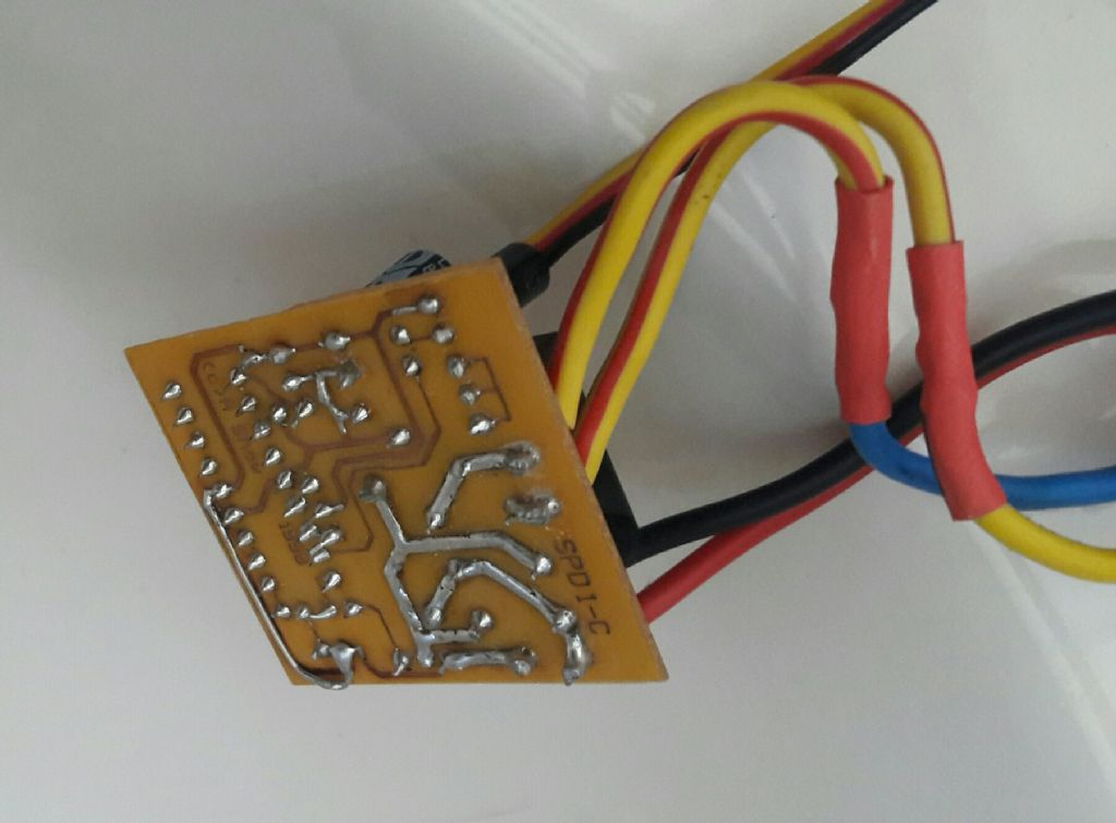

                                Yep. What you have there contains a reversing relay, a MOSFET power device and a microprocessor – I've no idea who the manufacturer is/was but I'd bet my lunch-money on that being the root of the problem. If the battery has once been connected the wrong way round then the symptoms would be pretty much what you have described. Bin it and move on.
                                I've used an MTroniks 10A micro speed controller before, and I've bought another one for a Graupner Pollux 2 which I'm building for grandson #4. Works for me and should be fine for your boat, too.
