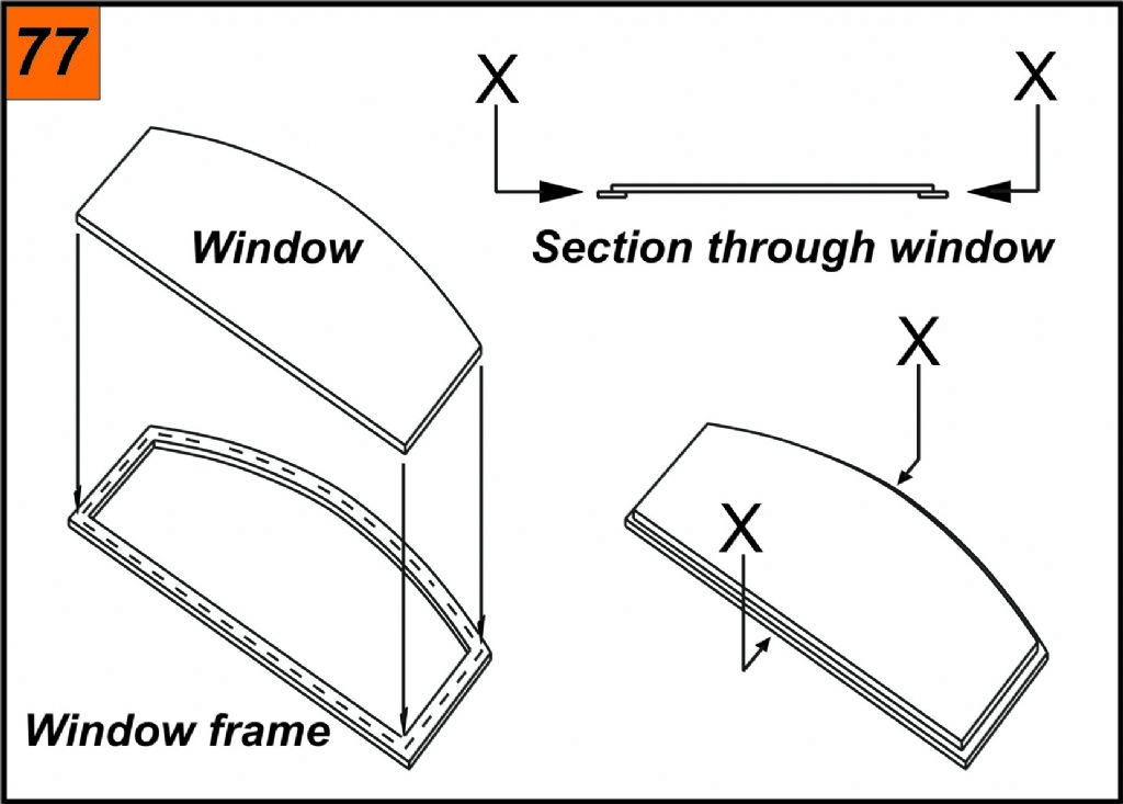

          Is the superstructure (cabin) already built? If so you can use the window cut-outs as templates for the frames. Cut these about 5mm wide from something like 0.8mm ply or 1mm styrene sheet, then make the actual windows from 0.8mm clear acetate. The "grab rails" can be fabricated from 1/8" diameter dowel and bass/lime sheet, stained mahogany and then varnished. There are plenty of pictures of fiull-size Huntsmen from which you could scale them **LINK** and there are even more in the Gallery.
          Here's a diagram from the SLEC Huntsman instructions which show the windows and frames quite clearly. I've recently used Stick2 double-sided tape instead of canopy glue and it's remarkably good.
          If you send me your regular E-Mail address via a Private Message then I can send you a full-size template for the big windscreen.
