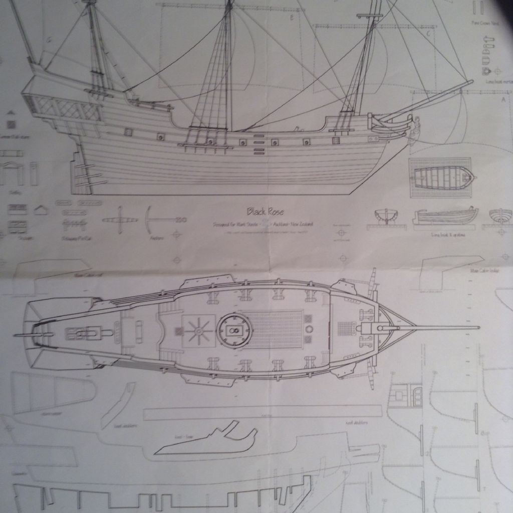

            There are some great photos of the same build in another thread called "black rose", but here is an image of the PDF plans that I have, I am just now starting on the keel and the bulkheads (waiting for a bit more wood to arrive this week to finish that up, but now is the time to plan for such things!

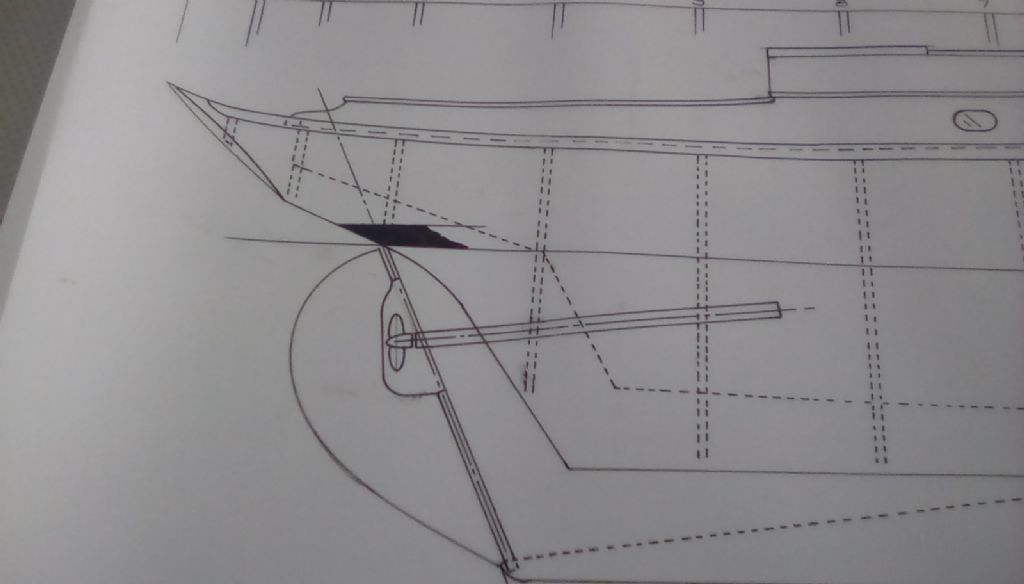

                #86666
                  Hi Jay,
                  This is slightly different arrangement for a Friendship sloop from Maine, but the principal is the same as Ashley is describing. The stern tube is built into the keel and the external planking seals the hull, I think you main issue will ballast in the hull low down, or an external keel to keep the boat up the right way 😀
                  When I build this boat I will move the prop forward into a recess in the keel, to make the rudder easier to build .
                  Edited By Ray Wood 2 on 10/04/2020 09:07:11
                  #86667
                    Like Ray said! His illustration is the sort of thing you need, the different style of boat means you will need to keep your shaft lower, that’s all.
                    I would also think about a thin (sheet brass) rudder…don’t know what the plan says, but without a prop therudder is likely to be quite fat which won’t help the motoring at all.
                    Ashley. (Snaps please)

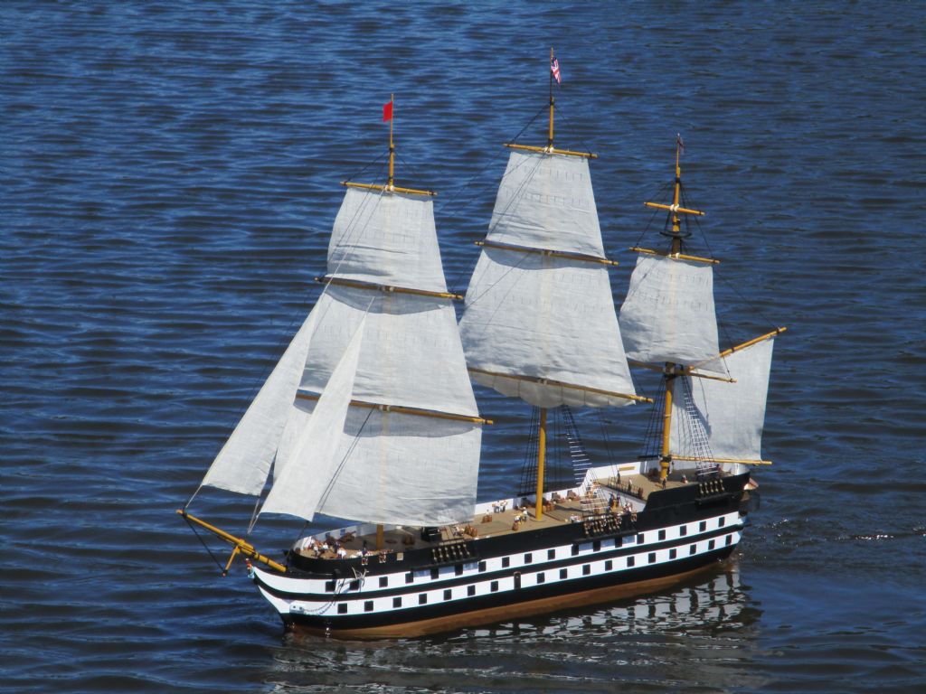

                          Malcolm has a point, however you could consider using muslin for the sails, as I did with the London, to minimise wind resistance?
