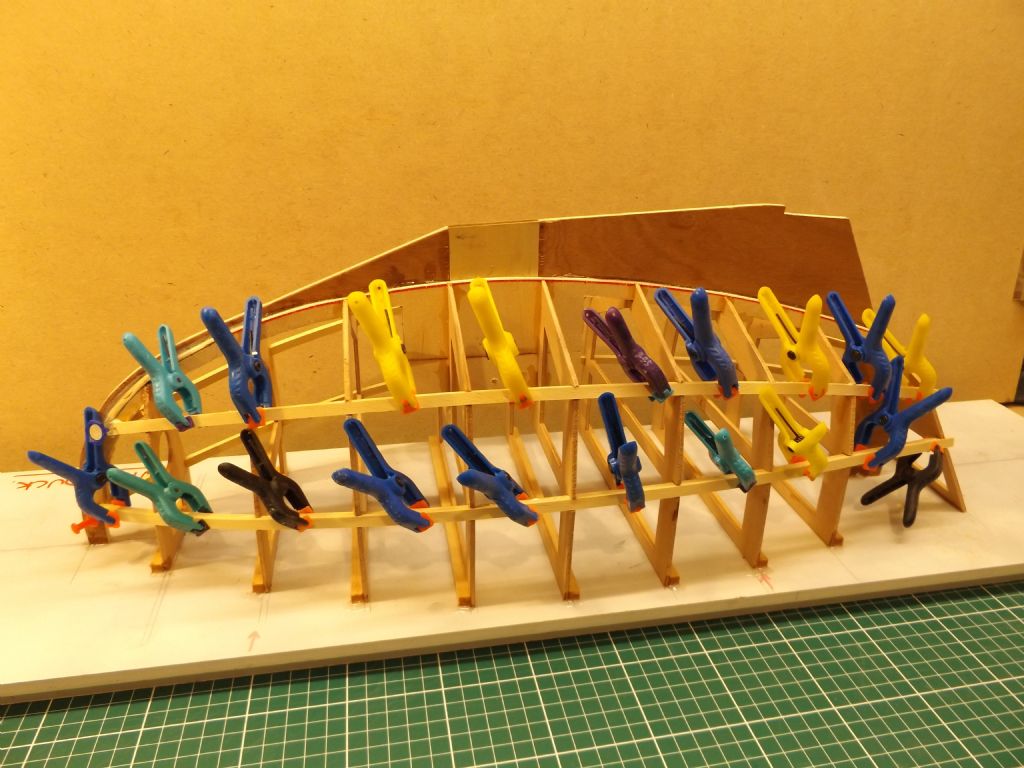

                                Hi All
                                Obeche is truly wonderful timber to work with, I use it for stringers and framing flexible and strong as it is available from SLEC at Watton & their on line shop is great, not forgetting the very cheap sheets of birch ply with the grain crossways, which must be offcuts from the bigger sheets Regards Raywd6.jpg
