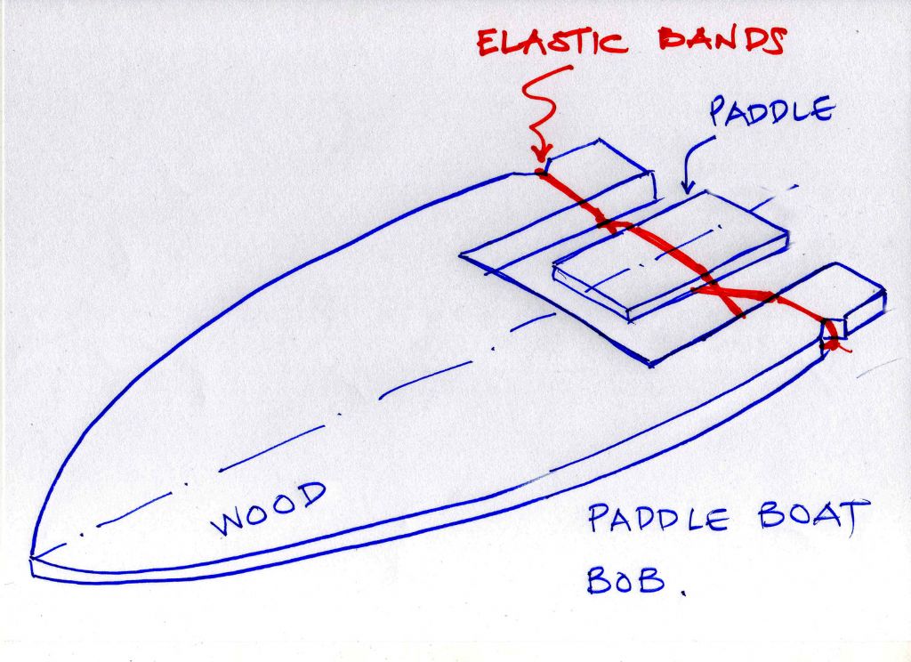

            If you post a drawing of what you require, you should then get a few good suggestions for paddle wheels

                    Here you go, Lorie!
                    Instant paddle boat!
                    You could easily make the paddle a four blader!
                    Show us your efforts, when you`ve made them please?
                    #31703
                      Maybe mount the paddle on a thin spindle across the notch in the back of the hull. Then you could experiment with applying a bit of friction to it to slow the paddle down and prevent it acting like a duck taking off – room for more experimentation on Bob’s excellent basic design perhaps.

                          Hello Len
                          You’ll need to post your photo….I ca’t find it!
                          Colin….the paddle blade will act as damper in the water and slow the mechanism down….Hopefully!
                          The size of paddle needs to be developed
                          The hull will need to be wider than my sketch, in order to get more rubber in too?

                            True Bob, it might flap about a bit if not controlled though. But, as you say the only way is to try it and see and then experiment a bit which would be a good educational exercise. Lorie could encourage slightly different variations to see which ones work best. It’s actually quite an interesting exercise really. This one works better than that one – why?

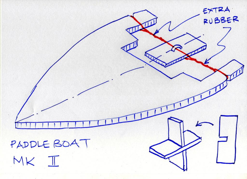

                              Hi Lorie
                              Here comes Mark II……
                              Longer life motor and a four blade option!

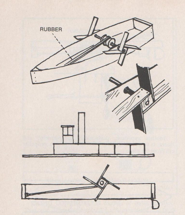

                                  Drawing from the book ‘The Australian boys book of Crafts, Pets, Sports and Hobbies’

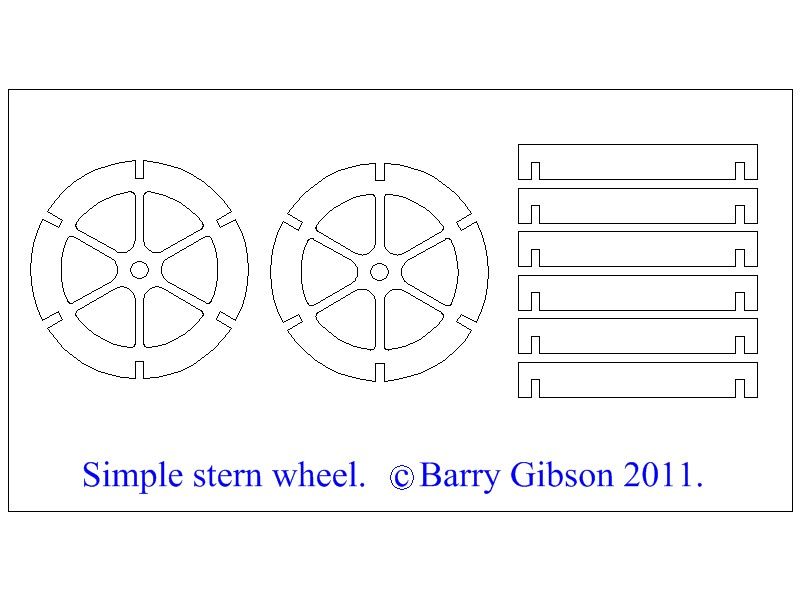

                                  I make the laser cut plastic paddlewheel kits for most of the companys list earlier. A suggestion for a simple stern wheel is below. 55 mm. wide by 50 mm. Dia.
                                  If that looks like some you could use I can work out a price for you.

                                          Barry. Like that design. I stern wheel boat with the drive on one side would enable the entire boat length to be used for the rubber motor.
                                          A problem I thought long and hard about when making mine was the method of winding up the motor. Twiddling a paddle with your finger for any length of time is a bit boring, and winding anything for 200 turns is mind numbingly so.
                                          A dog at the end of the shaft on a stern wheeler would allow the use of an electric drill, or possibly battery powered aircraft winder. OR perhaps a little permanent hand crank?
