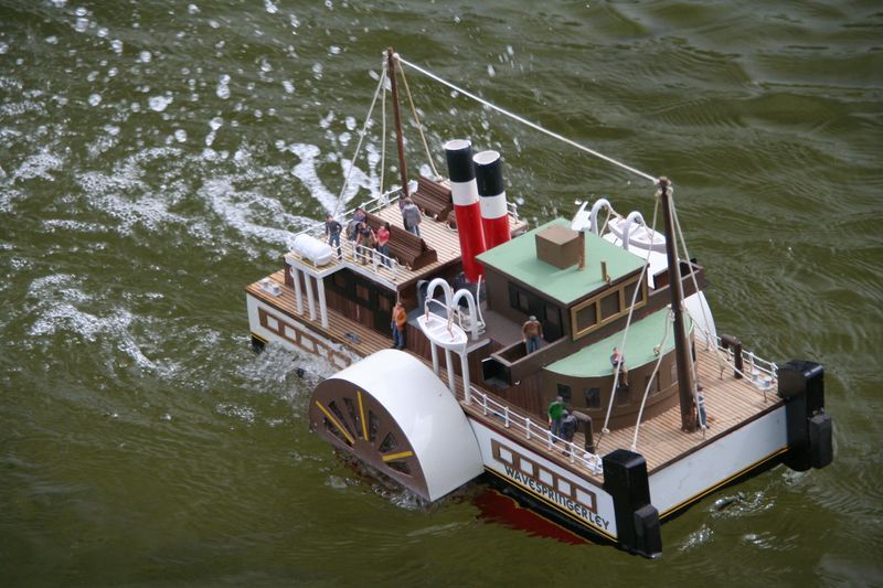

          You won't be the first, the late Ken Churchill built a very successful one a while back.

              Thanks for the picture Colin . It is exactly what I have in mind.
