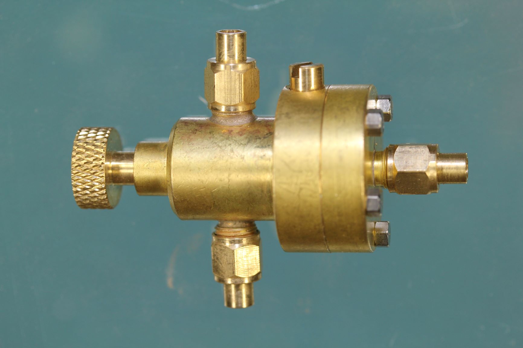

                          I did contact John at Miniature Steam re: your suggestion of a attenuator valve.
                          ­He replied: "I do not recommend a gas control valve on a 3" boiler. The savings in gas and extended run time are very limited. Gas control valves are more suited to our 4" boiler steam plant range. If you have your heart set on one we can supply and fit one.
                          What do you think, is it a nice to have not a must have (for a beginner like me).
                          Again thanks for your time.

                            #85828
                              Derek, Firstly I missed your question regarding the attenuator valve.
                              Personally, and I admit it is only my personal preference, I would always use some form of either electronic or mechanical gas control valve. I agree that gas saving may be minimal but I much prefer my own steaming to be slow and controlled rather than rushing around the pond simply to prevent the safety valve from lifting. I really do not like to see the safety valve lifting as it is not only wasting your gas but also your water and it just doesn't look like you are in control to me. I would far rather be able to manoeuvre around nice and slowly and yet push the throttle forward if I want. Also lifting the safety can spray hot water all over your model.
                              As regards the African Queen, I saw the movie only a few weeks ago and, as many have done before me, fell in love with the boat. It would make a lovely steam model subject but probably open up the arguments for and against weathering. There are advantages and disadvantages with the main advantages being cost and the ability to be able to use a smaller steam plant in it. Against that the Clyde, being a little bit bigger, possibly lends itself easier to modifications in the future and I think you will find that a Krick kit goes together a little bit easier than a Billings kit. This might make the build a little easier for a starter model.

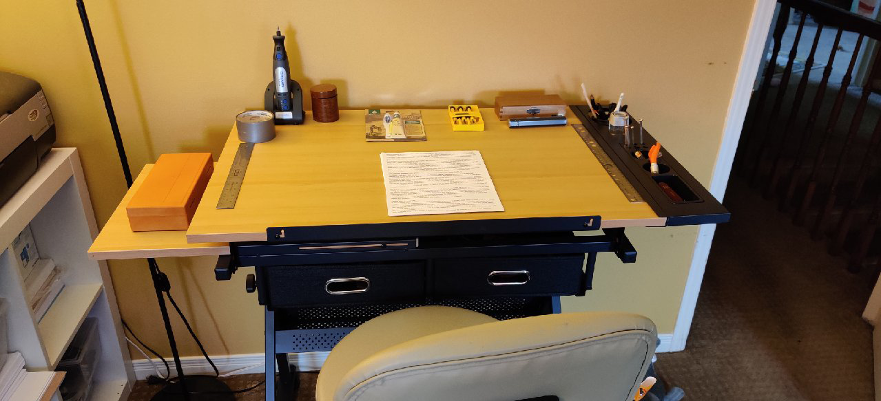

                                #86128
                                Derek Ellis
                                  @derekellis82329
                                  Richard,
                                  Quick question, my boat kit and steam plant are on a 3 week backorder from miniaturesteam (Aus). In the meantime I want to get ready with tools and glue for the wood boat/ABS hull/steam plant. Any suggestions ?
                                  #86134
                                    Hi Derek, Tools is a whole subject in itself, in fact I did an article on tools for model boat magazine a couple of years ago. Just some suggestions:
                                    Steel Rule, 6" and 12"
                                    Knives, I would go for a Stanley knife with a retracting blade for the heavier ply and a scalpel handle and a few packets of blades for finer work. Best blades are number 11s and number 10s.
                                    Good pencil, plastic and very cheap, propelling are good with a 0.5mm tip and medium lead inserts.
                                    Abrasives, massive range of ready made abrasive tools but a packet of assorted wet and dry grades is a good start. You can cut them up and glue the bits to pieces of wood to make sanding boards and tape pieces to a flat board to make useful sanding surfaces.
                                    Good cutting board, self healing mats are good, I would go for an A2 size.
                                    Glues, for wood to wood I always use some form of PVA, either a woodworking glue such as Resin W or one of the very good model railway general purpose PVAs such as Speed Bond. For wood to ABS and metal to ABS a two part epoxy is good, I always buy Araldite, which is more expensive but I know it is reliable and good quality. Roughen the surface up with some course wet and dry before assembling. Avoid the rapid variety as that tends to not be as water resistant plus the normal variety gives you much longer to adjust the positioning of things before it fully cures. Leave overnight.
                                    For the steam plant if MSM can give you exact dimensions of the base you can start to design the bearers to go in the base of the model. I would strongly advise that you design the model to allow everything to be removed on a single base. You then need just four simple screw fasteners to hold it down onto captive set screws. I would also use a very simple pin arrangement on the drive shaft so that does not require disconnection and a connection to the control valve and the servo using a clevis means that the plant can be removed in a couple of minutes.
                                    That should start you off.
                                    #86144
                                    Derek Ellis
                                      @derekellis82329
                                      Richard, Colin and others,
                                      Thanks for the "tips" — they are going to be very useful. Starting to put together things from the list I already had and what I need to get. (**LINK**) With the MSM "Wattle" kit on backorder, I finally got through to Krick and secured my first choice – "Borkum" and hope it is on its way with all the turmoil in the world – will be looking out my window for the DHL truck. can't wait.
                                      As we are all told to do social distancing, it is great to be able to follow a passion and yet be close to experts virtually who can help me on my journey – great to know you are all there. When I finish the project, I hope I will be able to show it off to you and my new club mates and sail the Borkum at the lake.
                                      Happy virtual sailing, be safe.

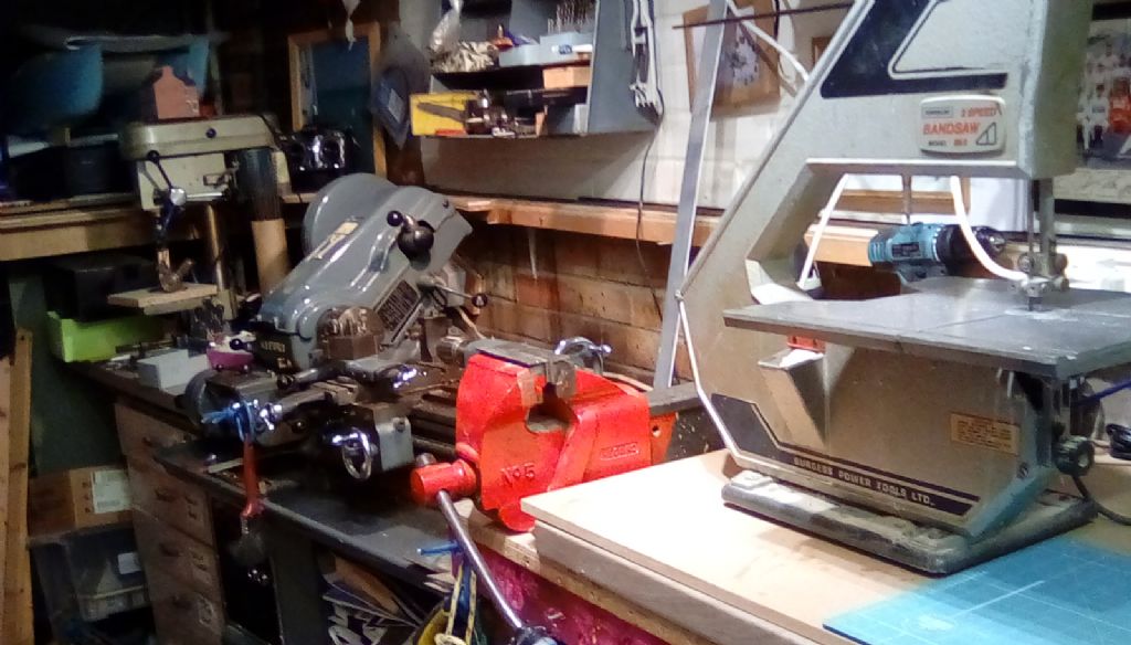

                                      #86153
                                        Hi Derek,
                                        Once you get carried away with the hobby you'll end up with this lot but you will never be boredimg_20200323_210358.jpg 😀

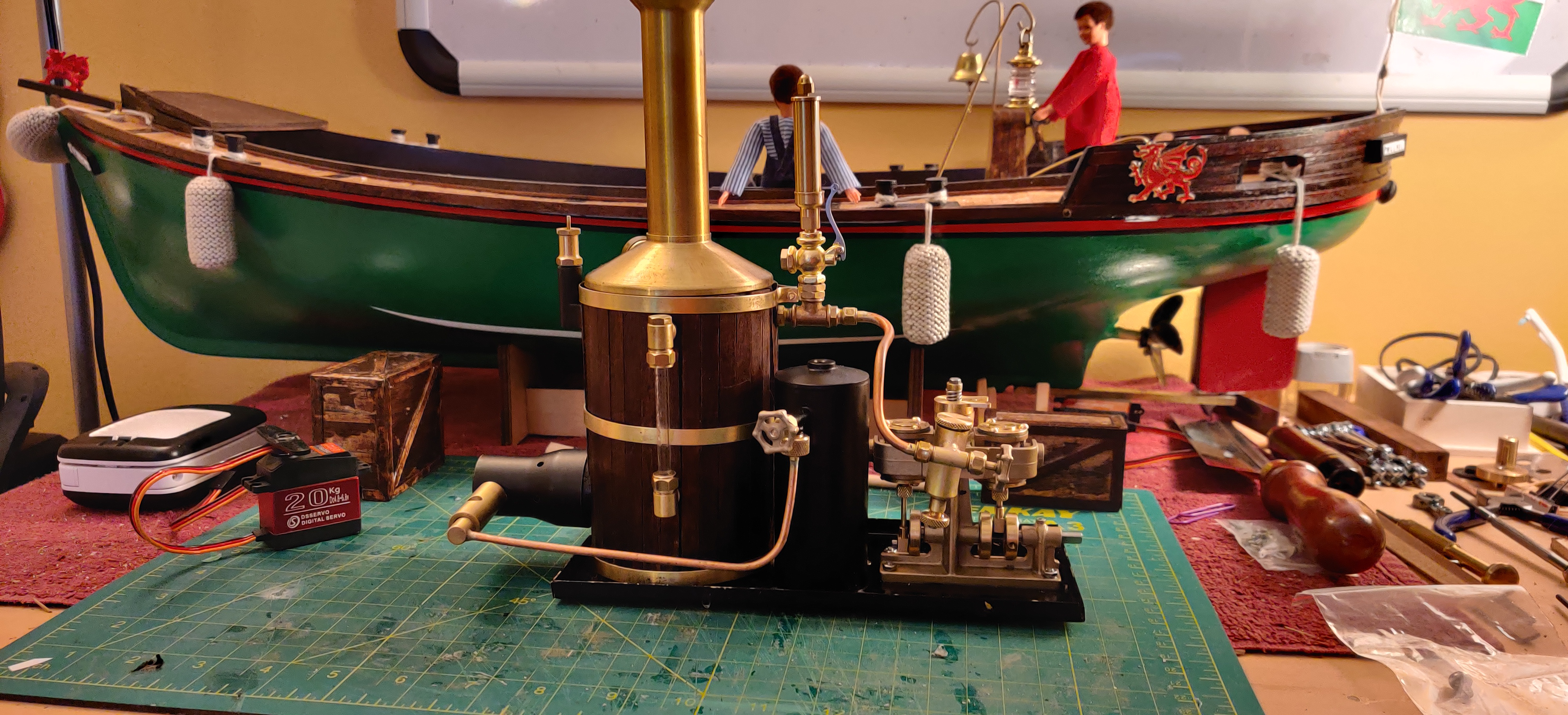

                                          #87934
                                          Derek Ellis
                                            @derekellis82329
                                            Richard/Colin,
                                            Here is where I am at with my version of the Borkum. Learning tons and making mistakes, but loving it – good for the soul in these trying times. Have ordered the 3" Clyde Steam plant form MSM and they shipped it 4 weeks ago. Problems with flights/cargo/postage to Canada due to COVID-19. Here's hoping it comes soon.
                                            Can't wait to spend the time learning how to run a steam plant.
                                            Cheers, Derek
                                            #87943
                                              Hi Derek, Glad to hear you are enjoying the build. I'm sure you will also enjoy the Miniature Steam plant and find it well matched to the Borkum.
                                              I actually really like the hull in one solid colour and it saves having to get the boot topping perfect! It gives it more of a workboat character which suits the model.
                                              I'm looking forward to seeing what you make of the plant and how it looks in the boat.

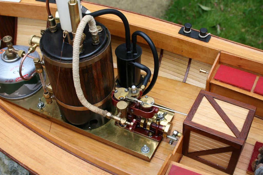

                                                #91015
                                                Derek Ellis
                                                  @derekellis82329
                                                  Richard Simpson et al,
                                                  FINALLY got my steam plant from Australia. It is a thing of beauty. Reread your article in Model Boat September 2012 and proceeded to fire my beauty up.
                                                  It went well for the first 20 seconds then the second cylinder stopped. http://www.morfa.ca/Cariad.mp4 .
                                                  After some great on-line help, I realized my mistake. I did not tighten all my screws/grub nuts and the flyweights loosened. I did have the degree wrong 1800 not 900 and found that all I had to do was find the flat on the crankshaft then tighten the hex nut. Once I did that it was success again. It runs very well out of boat. Next step to put it in the boat. **LINK**
                                                  Derek
                                                  #91016
                                                  Derek Ellis
                                                    @derekellis82329
                                                    Richard Simpson,
                                                    Questions:
                                                    1. Your article said the boiler is 60 PSI. My documentation says 35 PSI. That is what I am running. Was your 60 PSI due to yours being an evaluation plant?
                                                    2. My control arm that manages the forward reverse and speed points to the stern. When I try and adjust the wire to the servo it is not a clean motion. Is there a better way to adjust the steam plant to a servo. Your picture in the article has it has the control arm pointing to the starboard side. Can I change mine?
                                                    3. In your opinion, what is the best way to connect the steam plant crankshaft to the propeller shaft. Direction connection, universal joint etc?
                                                    Thank you for steering me to first the Borkum and then the MSM Clyde steam plant. Hope to get on the water soon.
                                                    Derek
                                                    #91017
                                                      Hi Derek,
                                                      To answer your questions,
                                                      1) As manufacturers are continually developing their plant and the article was now 8 years ago I would go by the latest documentation. I have checked with the Miniature Steam Web site where it confirms that the 3 inch boilers are tested to 60 psi and are quoted as having a working pressure of 35 psi. Technically according to UK rules this should be no more than 30 psi, unless you want to put your boiler through a hydraulic test of 70 psi. I am sure that if your engine works fine at 35 psi it will work as well at 30 psi, although slightly slower! Don't forget your safety valve cannot be set any higher than 30 and your pressure gauge should be marked with a red line at 30 as well.
                                                      2) Without getting my own Clyde out and having a play, which I might just do on compressed air this afternoon, I seem to remember that the control valve works in more than one attitude. If you have a supply of compressed air have a play, otherwise I'll see what I can find out. I am sure it works in more than one attitude though, in pretty much the same way as the Cheddar engines did. Therefore all you need to do is to rotate the control valve disc to a more convenient attitude.
                                                      3) My Borkum uses a very simple 'dog' clutch. When I first saw it I decided immediately to change it for something more sophisticated however as soon as I started to use it and, when I first removed the plant, I soon realised that it was extremely simple yet efficient and very convenient. I will try to dig out a picture but it consists of basically a pin located in the flywheel, offset by a few millimeters and parallel to the main shaft. The pin has a plastic sheath over it. On the end of the prop shaft is a small collar with a screw threaded into it, also covered by a plastic sheath. The length and position of the pins allows them to interfere when the engine turns. The collar on the shaft can also be adjusted to ensure no end play in the prop shaft and the plastic sheathing ensures quiet and smooth operation. Highly recommended.
                                                      I hope this helps and gets you a little closer to getting your Borkum on the water.
