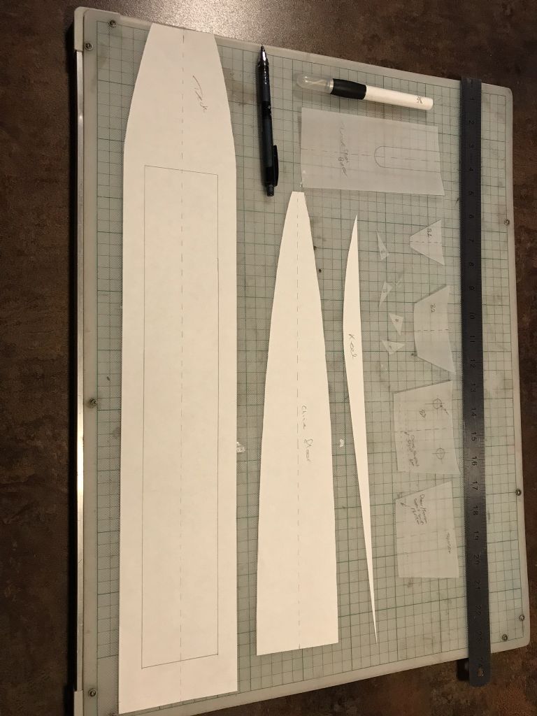

          Okay, so plan transferred to tracing and layout paper. All cut out ready to apply to the wood.
          Using balsa as per Glynn’s original design.

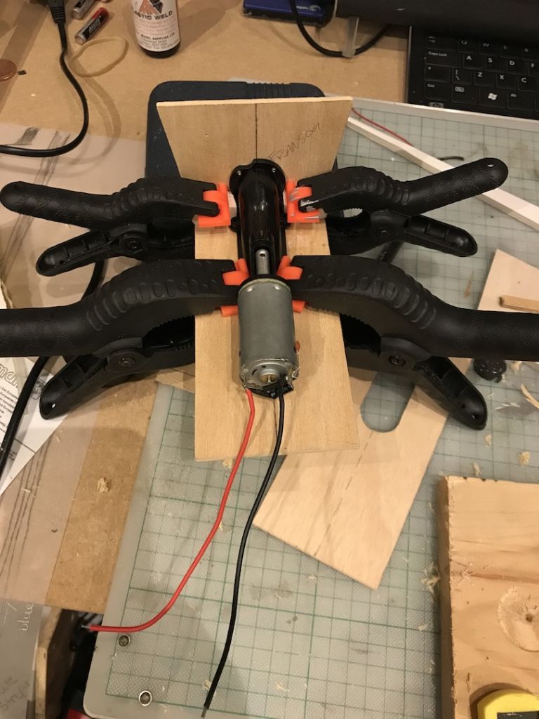

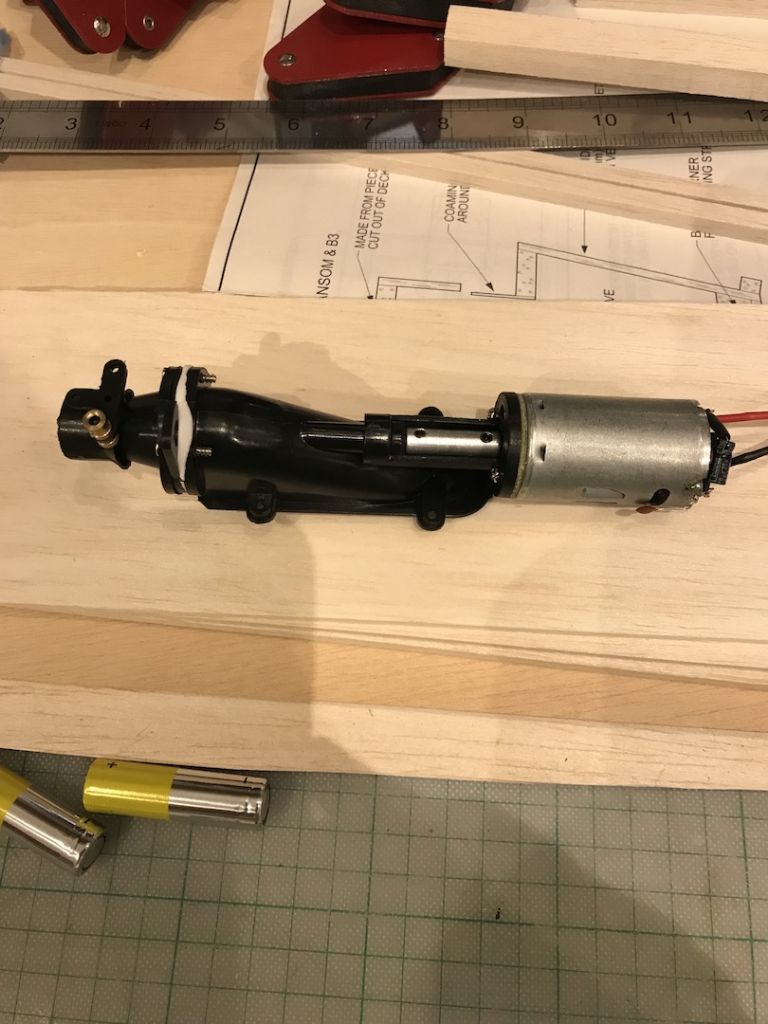

                  So a little photo update. Jet drive installed. Did not see Glynn's little note about leaving out until later un the build but hey ho. It is in and looks good. A bit on the heavy side but will see how it goes.
                  Shot of it in the drive bay.

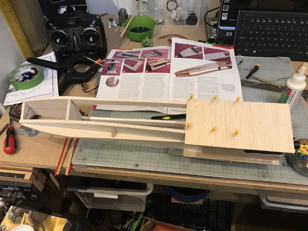

                  Started the side skins. From the stern forwards as per instructions.
