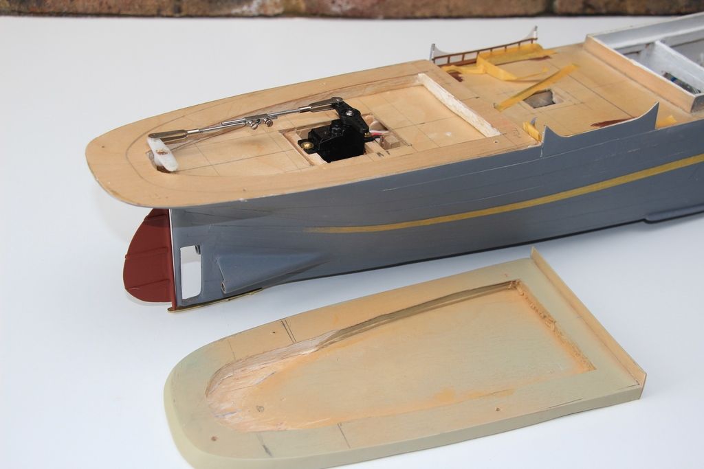

          #91585
            Snaps, ok, not quite 40 inches long, but showing the potential. It is very easy.

              Appreciate the response Ashley and a foam plug isn't something that I had considered and a material I haven't worked with before.
              Making a one piece hull and then slicing it, would be ideal but the upstand then has to be joined to the sides – because of the extreme tumblehome, the upstand either has to follow the inner contour of the upper hull (very curvy in cross section) or if the upstand is vertical, it has to be inset several inches as the beam at the cutline is about half the beam at deck level ! It would be stronger if it were moulded in one piece.
              On the negative side, I'm not very keen on doing a series of layups strong enough to support at least 10 pounds of external false keel and sanding the surface smooth . The narrow ram bow could also be a problem..
              Having said that, its making me feel that glass skinning a planked hull inside and out might be the easiest approach.
