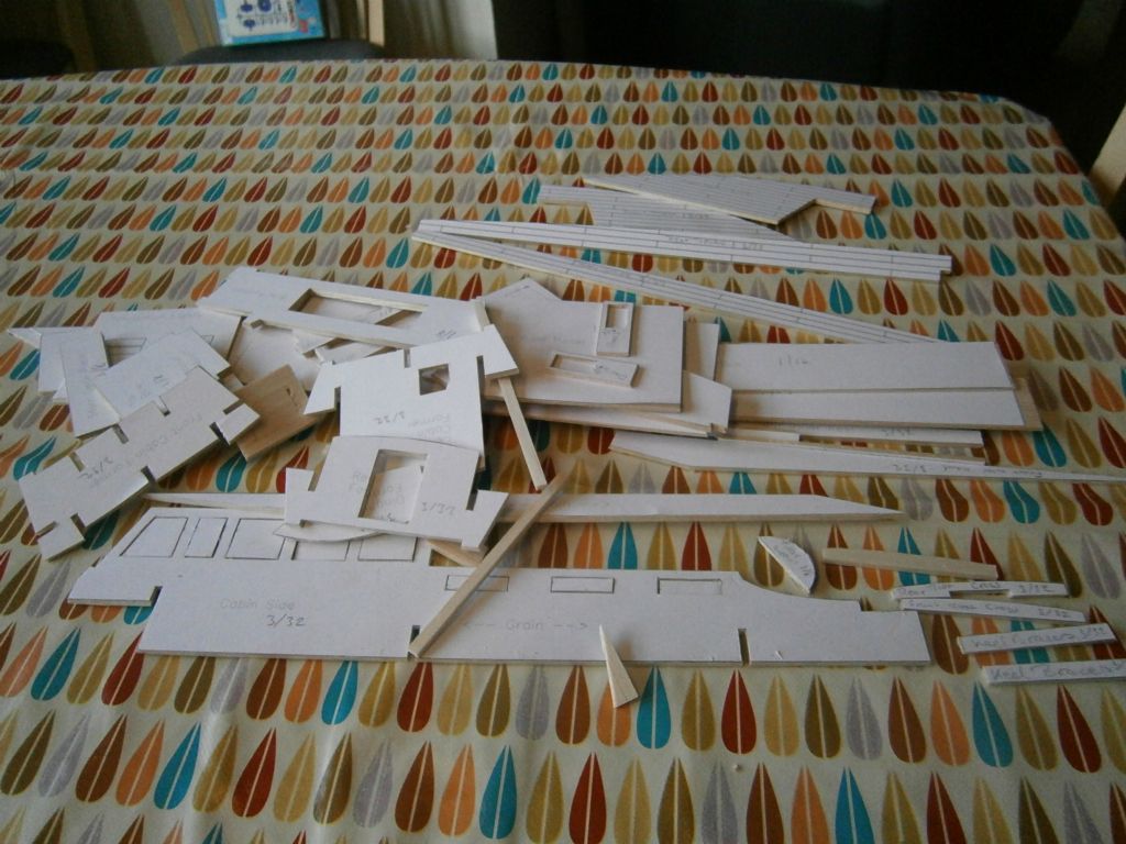

      So above are the plans printed and stuck to the balsa. Next comes the laborious task of cutting them all out. Boy is this bit boring. But we finally ended up with a load of bits.
      Bits and Pieces

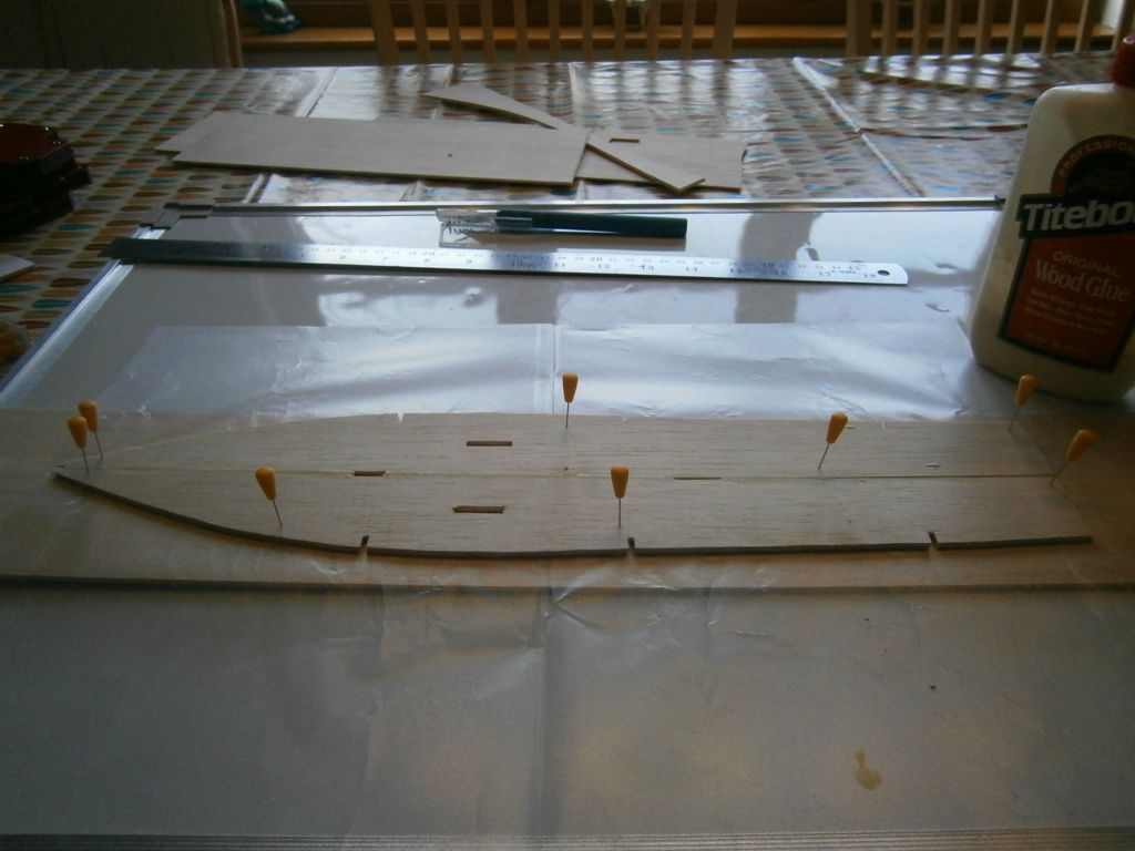

      So following the instructions closely, they are not very comprehensive, but that is OK it was a long time ago. I started at the bottom.
      Now we are cooking

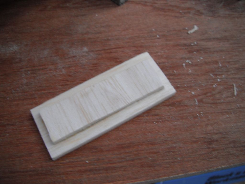

      After allowing to dry, next came the frame formers and a cabin side to hold it all together.
      And that is where I am at now. I have toyed with the idea of a small brushless motor, but given that there is not much room in there for ESC, motor, batteries and servos etc, I sort of came to a stop. After a quick thread chat with Dodgy Geezer I am now going to make a small rudder following his excellent instructions. I have printed the page with the shape and now need time to put it in practice. After a visit to Mick Charles models, I came away with the required brass plate and rod / tube ready to give it a go. While I was there he asked about motors and that brought up a discussion about brushless, but he actually suggested a different approach. So I now have a MFA 457RE260 motor which runs at 3- 6v and a Mtronics micro 10 speed controller to go with it. The battery pack is a 6v Nimh 1600mAh 5 cell pack. Not sure I have a charger for this one, but that is for later.

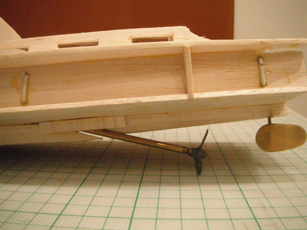

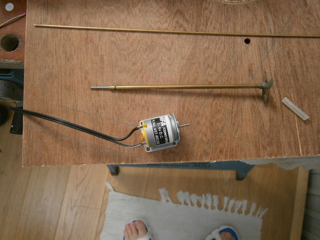

                Here is a pic of the drive line that is going to be used as per previous post.
                Running Gear

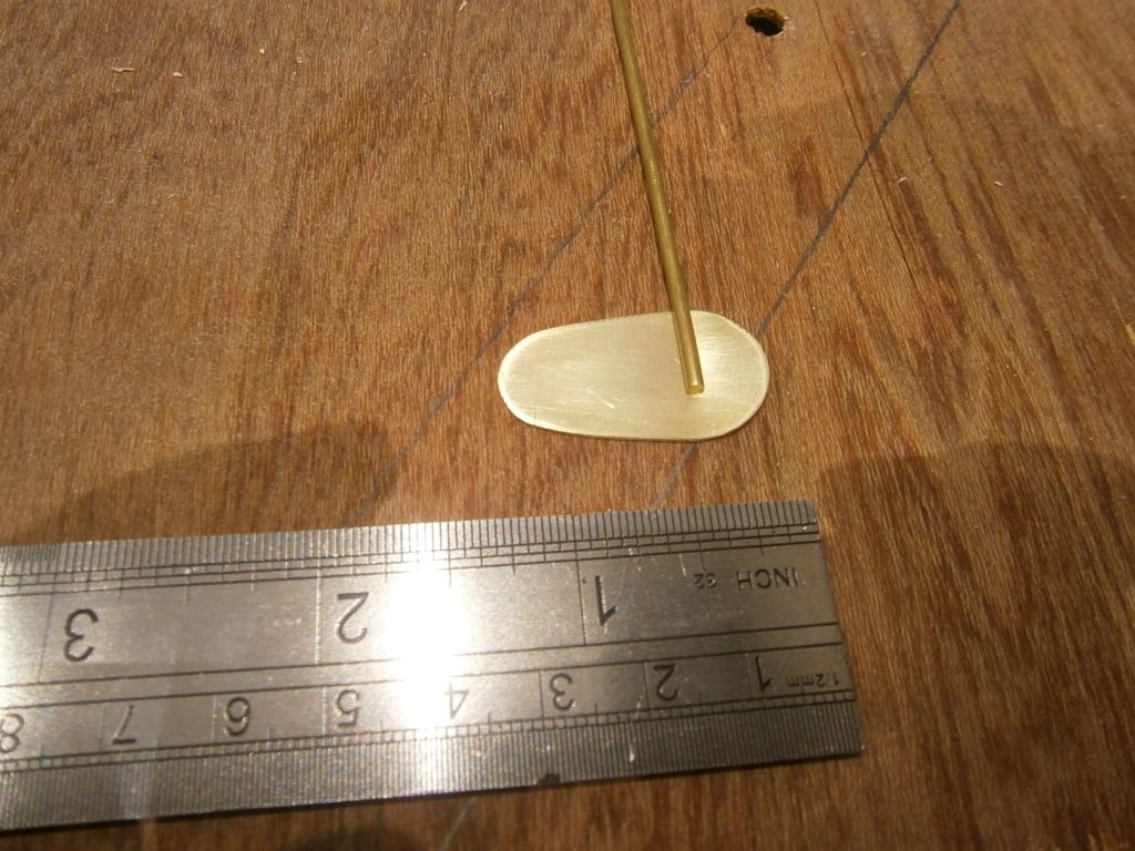

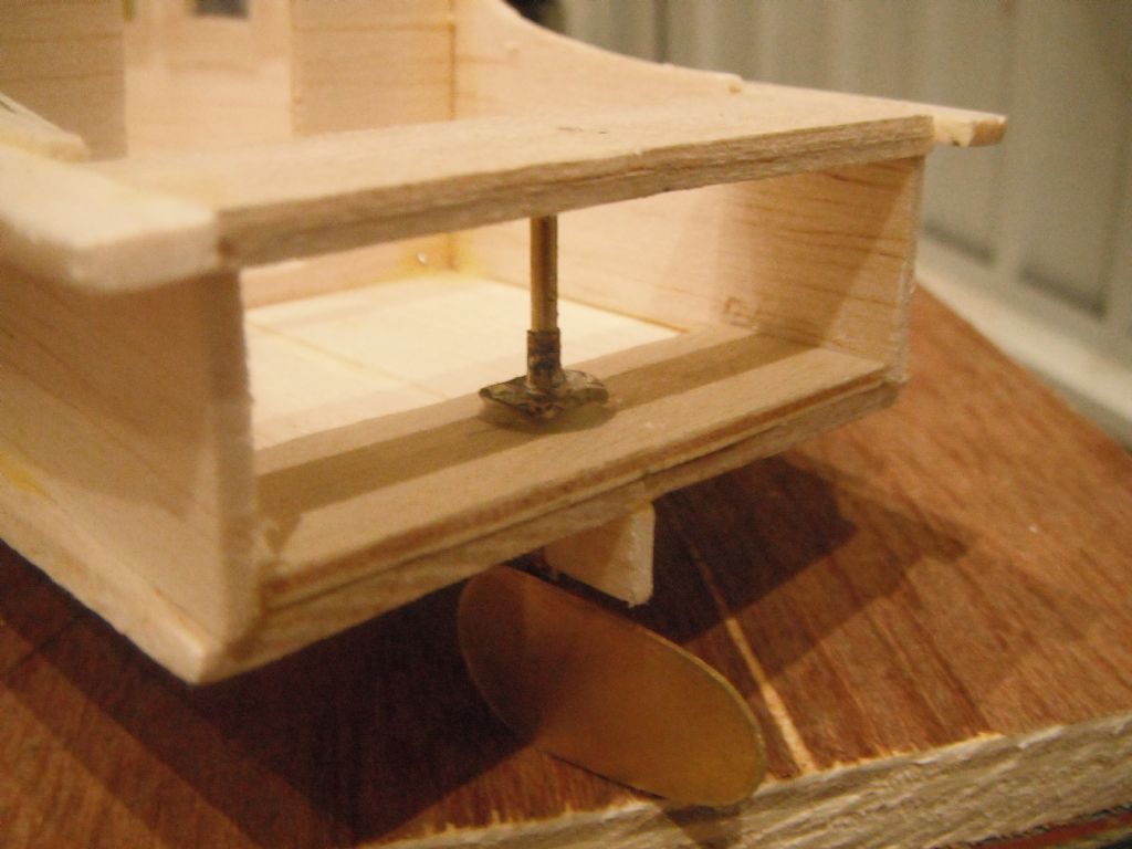

                I had a go at putting the rudder together tonight. Here is the rudder cut and shaped from the brass sheet. With the rod to be attached.
                Rudder prep
                As you can see the rudder is only an inch and a bit long, (technical term), so quite small, but then so is Triton.

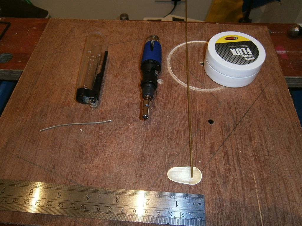

                Here are the tools to be used,
                Ready to solder
                That was fun, here is the soldered article.
                Rudder Nora I did it
                A little too much solder, but hey it was my first time, so be gentle. Given it a bit of a clean up and filed the rod a bit flatter, given the rudder a bit of a buff with very fine wet / dry. Must say it looks quite good.
                Now then. Did I ever tell you I hate Balsa. Well I HATE balsa. Too soft and easy to break. Fitting the front windows broke the side tabs where the rear / side deck fits. Never mind a bit of glue and no one will notice. Except I just told you. Oh well.
                On with the build tomorrow. although Dodgy I do have a question. The rudder on this thing looks quite tough to actually fit. I am going to need to put a scrap bit of balsa under the rear deck piece before the transom is fitted, but how is the rudder tube fitted through the hull bottom sheets? do you fit the rudder tube and then the hull sheets or fit the hull sheets and try to drill out a hole for the tube?

                  Andy. I would not bother filing away the excess solder., It is streamlining the joint! !
                      It's probably easier to do the drive train and rudder before the hull sheeting. You can be more accurate going through the keel. As Ashley says, you can use a thin needle file – though I tend to use a dental burr running at high revs – that will cut even soft balsa very accurately without any collateral damage…
                      But the key point about the rudder is – how are you going to connect it to the servo? These original eezebilts were not designed for radio control, and have no obvious place to conceal a servo and push-rods. The original rudder tube just goes right up through the deck, and then the shaft is bent over to form the tiller, which is a spring fit onto a balsa pressure plate.
                      Have you thought of where you are going to put the servo? If you don't want it out in the open, one thing you could do is run a 'closed-loop' system as illustrated here:
                      Spool to the bottom of this page to see a possible installation….

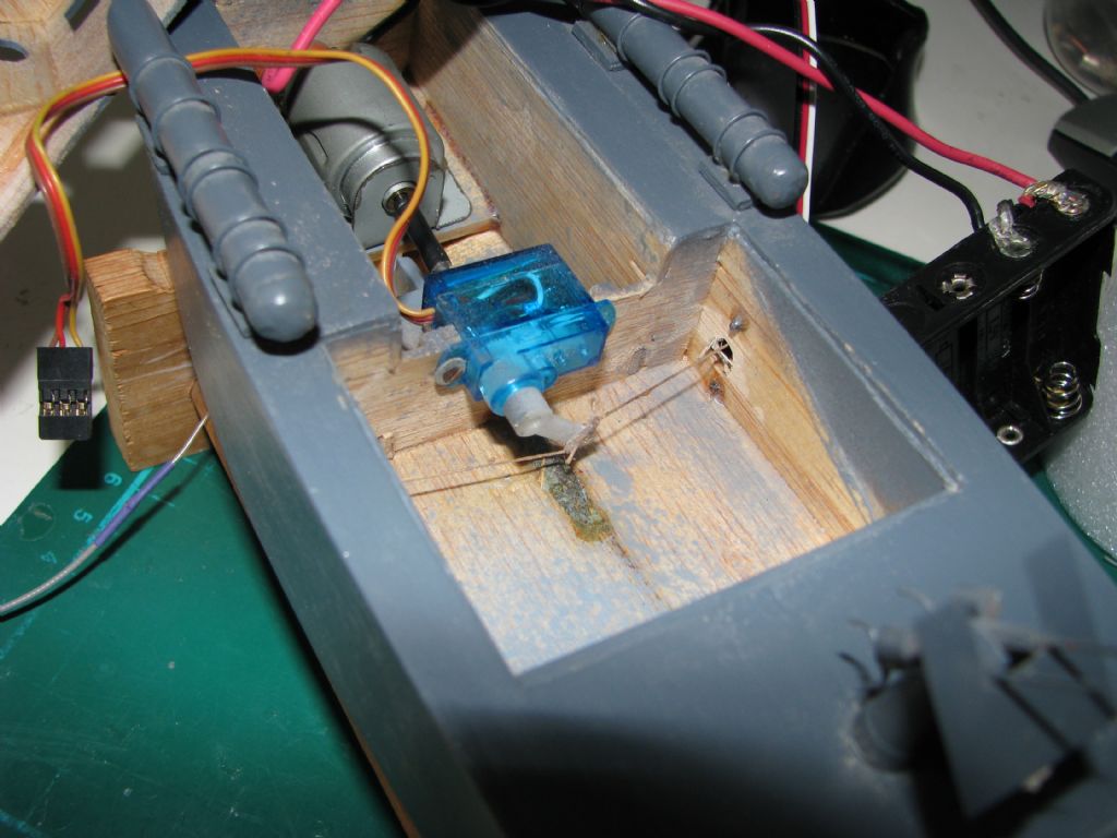

                            Here is an installation on a Terrier, which is about half the size of the Triton. It's worked reliably for years (looks it!). Assembly, as you can see, is a bit like watchmaking, but:
                            1 – it is small and light
                            2 – it means there is no requirement for a pushrod down the centreline of the boat – and these small EeZebilts are packed!
                            3 – It's cheap (standard EeZeBilt requirement)

                                        I see your concern. The posts are quite wide – they are freestanding posts on a demonstration/test rig I set up when I was developing the idea. The Terrier has very little room as well, and that actually uses a small bit of copper wire (household 13amp) attached to the side of the inner frame.

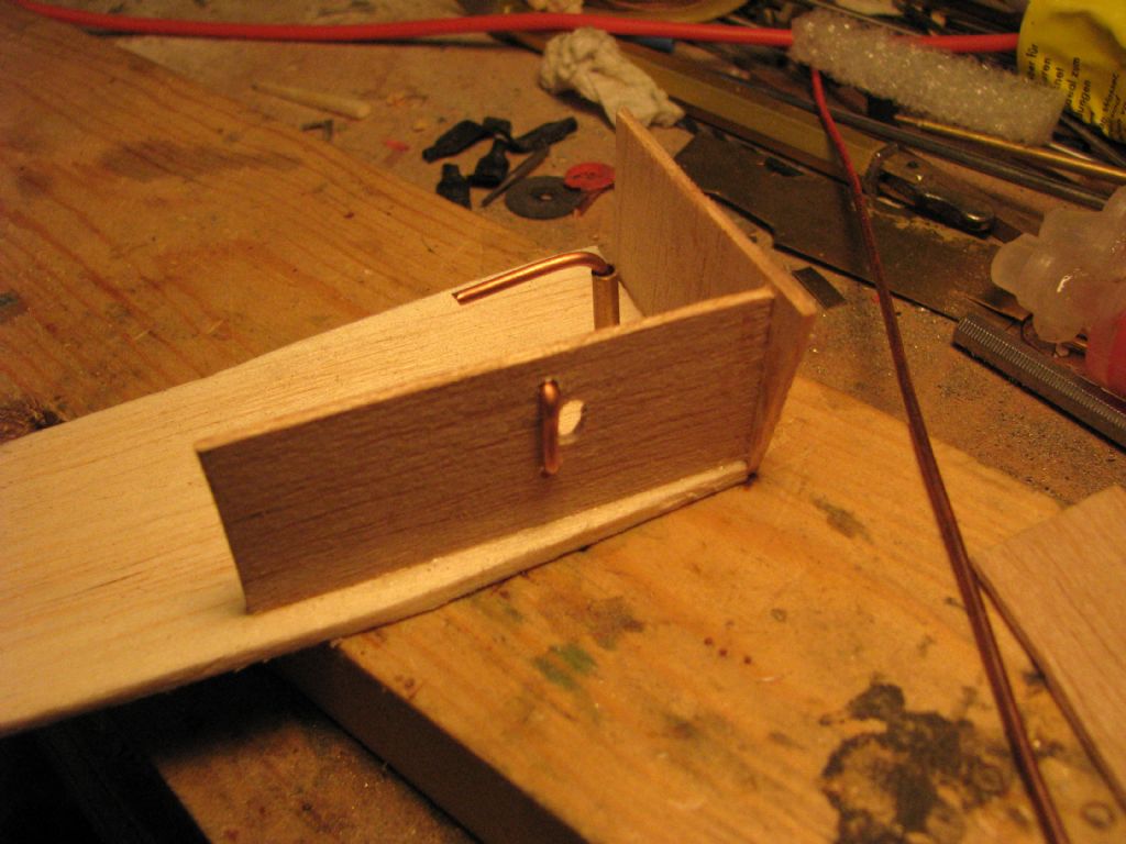

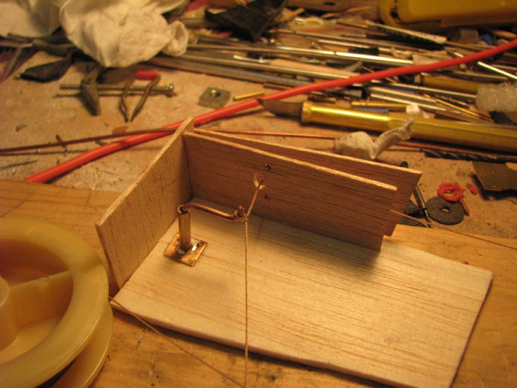

                                        It's a bit hard to describe precisely. I will make a simulation of the stern of a Triton and provide some pictures. You will see that , at the limit, the only space that is needed is space for the thread (Carp Dacron Trace, 8lb):
                                        A quick emulation of the Triton stern. Note the Rudder tube with a little patch soldered to it, to help the glue hold it in place…
                                        First, we drill 3 holes as indicated. I made the middle one too big…..
                                        A short length of copper wire is bent to fit in the holes, and glued there…
                                        Now the Dacron trace runs easily on the copper wire, and doesn't cut into the balsa. Note the upturn on the tiller arm, to stop the thread running off the end if the glue fails. I didn't bother to glue this demo, of course. If you look closely at the Terrier pictures, you will see the two little holes, top and bottom, where the copper runner is mounted behind the balsa. You do the same at the other end, where the thread comes out of the wall to connect to the servo.
                                        Since the original EeZeBilts have very little space for a central push-rod, but most have this 'twin side-wall', this is a very handy technique for connecting the rudder servo to the rudder…

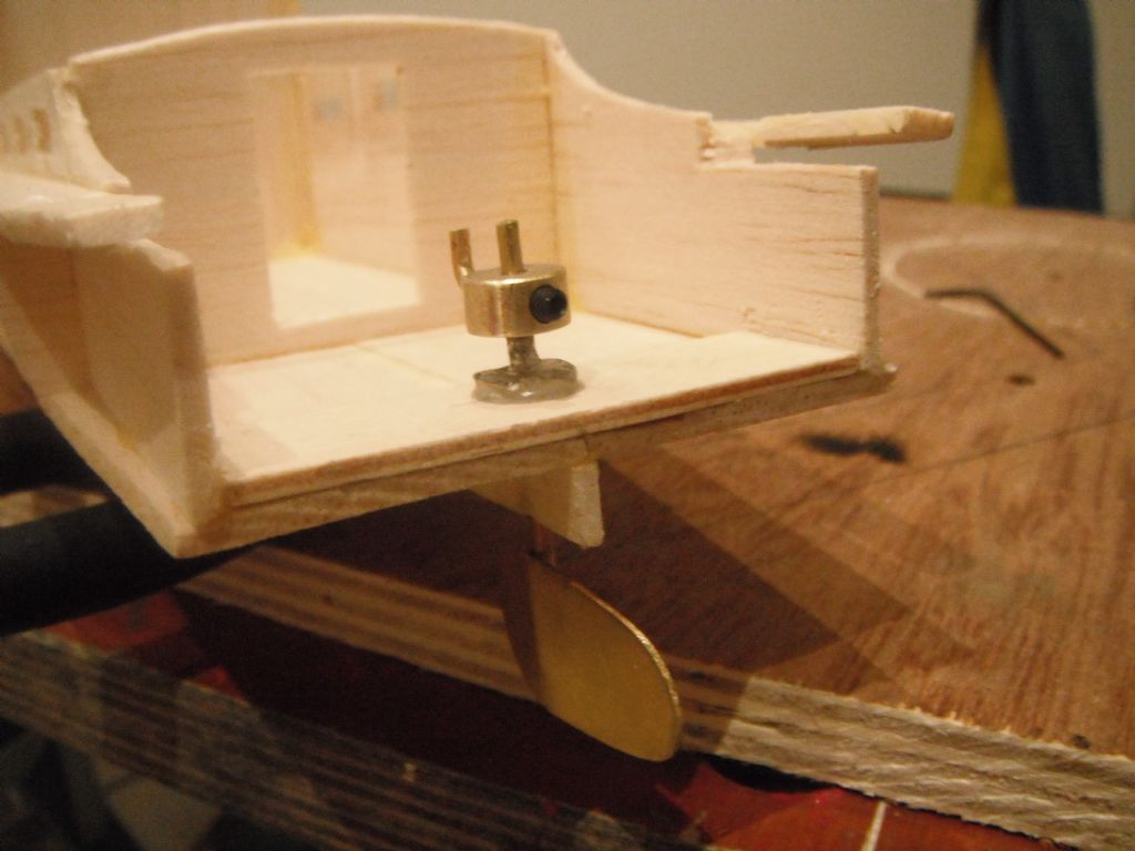

                                            OK, it's been a while but managed to get a bit of build time in. Mainly in dribs and drabs, but any build time is good time. So what have I managed to do so far. Well I am glad you asked.

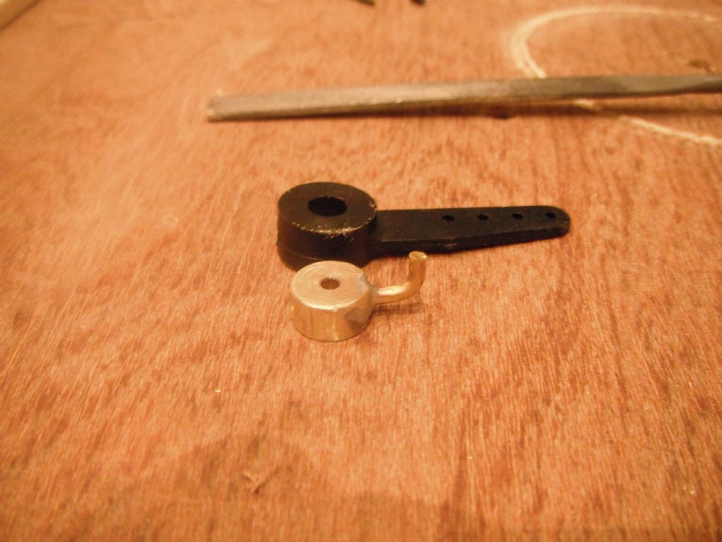

                                            After soldering the rudder, how hard can this be, I decided to give the rudder arm a go. So, found a long plastic arm, way to long, which had a brass insert and grub screw to fix it to the servo. Great off came the plastic bit, bent some brass rod to shape and soldering torch out.
                                            See this soldering lark is easy, should do it more often. So now I have a a rudder and arm, now need a rudder stern tube to put it in.

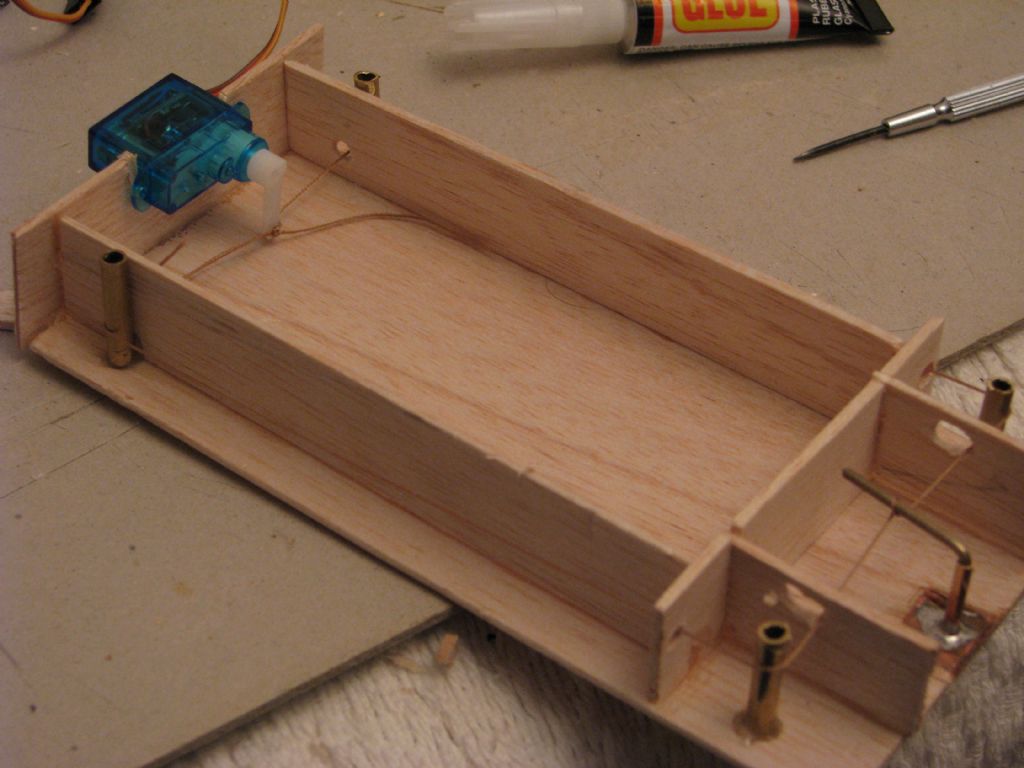

                                            This is a spade terminal usually used to make electrical connections, with the spade cut off and drilled to the size of the rudder tube, soldered on and epoxied in place. Here it is all in place.  Those eagle eyed amongst you will notice I had to strategically remove the rear deck plate.  God I hate Balsa, but it is easy to cut out bits and redo.

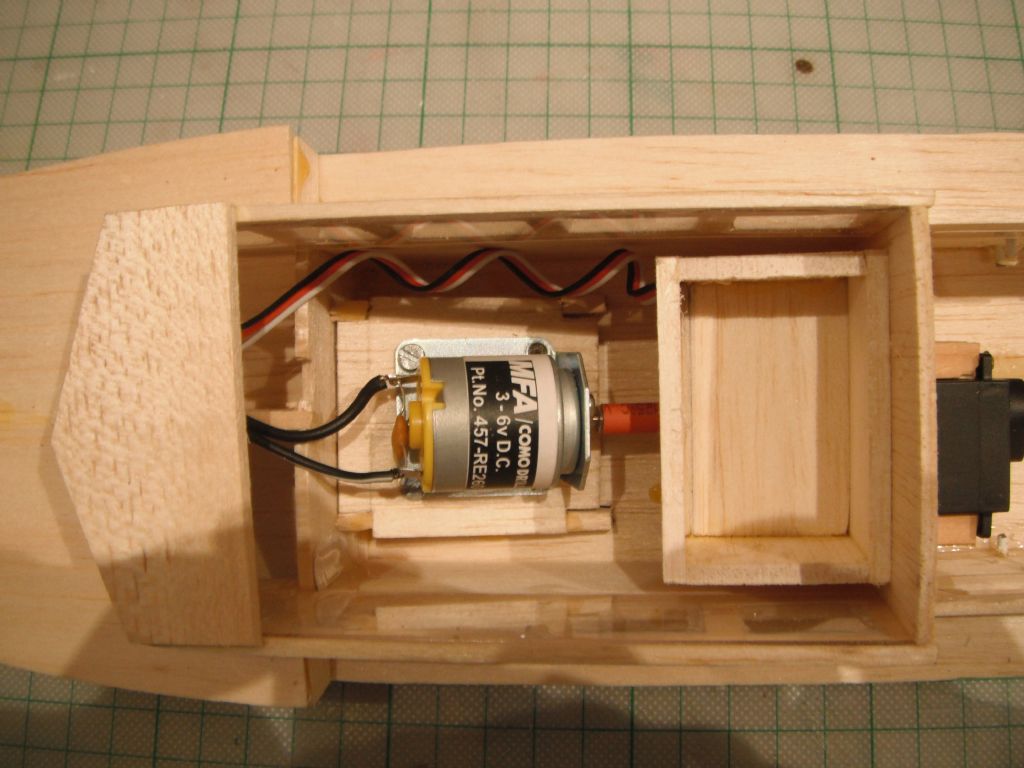

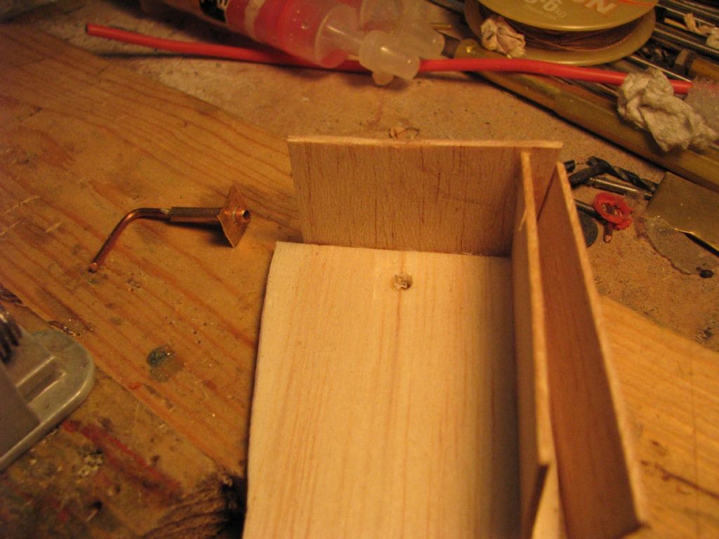

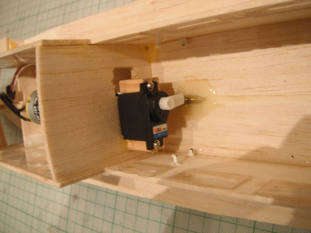

                                            Next on to the motor mount. Mounting plate with nuts epoxied in place ready to take the nuts to hold the motor down.

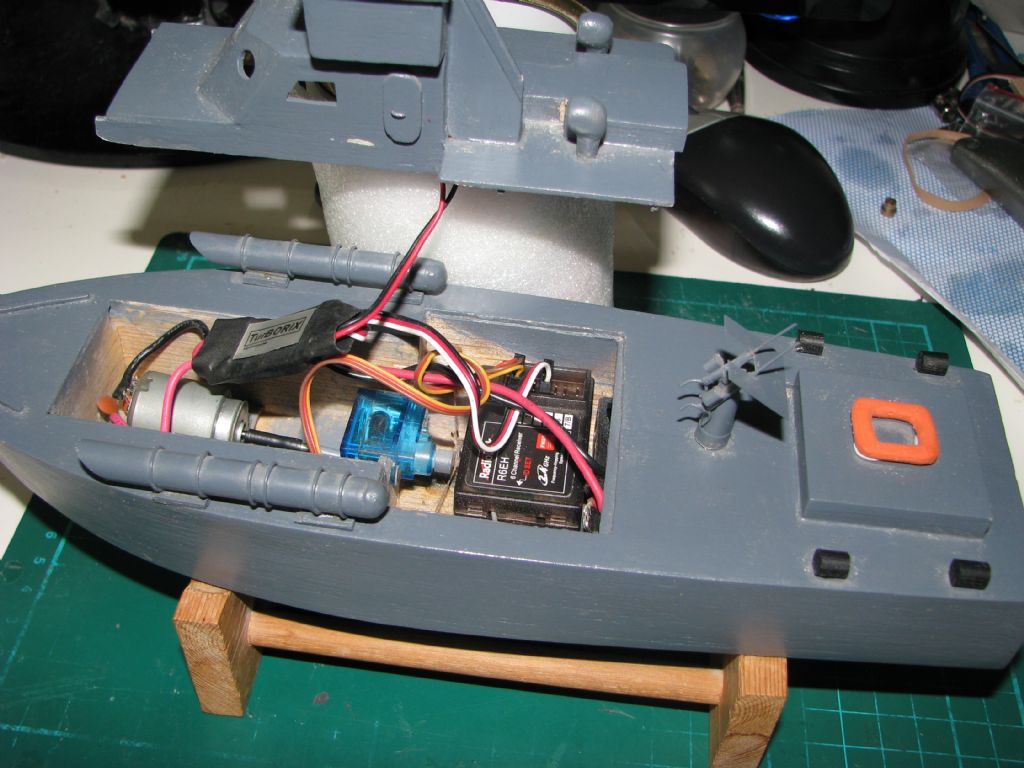

                                            With the motor in place it is on to the rest of the electrics and rudder mechanism. So, a box to hold the receiver was built and attached to the bulkhead, and a mount for the rudder servo built and glued in place.
                                            The white things poking through the side are the runners for the rudder servo pulley system,
                                            Above you can see them glued in place, they will be enclosed inside the hull sides. Thanks Diede, should work a treat. Now just have to string it up and test it.

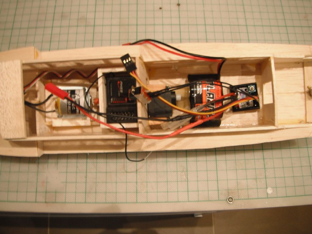

                                            Had a test fit of the battery, receiver and ESC.  It is really tight for space in here.

                                              Ok, so question. Once I run the fishing line round, is it one long run or two separate runs. One each side. How tightly should it be strung and what is the best knot to use. Ok so that is four questions. Any help appreciated.
                                              Andy
                                              #57968
                                              Dodgy Geezer 1
                                                @dodgygeezer1
                                                Once I run the fishing line round, is it one long run or two separate runs. One each side. How tightly should it be strung and what is the best knot to use. Ok so that is four questions….
                                                How it works for you, of course, but this link (scroll to the bottom) says how I did it.
                                                I ran a single length of this lovely floppy dacron trace (not monofilament nylon!) from the servo arm, round the 'sliders', one loop around the tiller and back to the servo arm via the other side 'sliders'. I knotted both ends to the servo arm and put a dab of superglue on them.
                                                Now the trace was a bit loose. So I swung the tiller arm to one side until the trace was almost falling off, and put another loop around the tiller arm. I kept doing this until the trace was quite tight, though easy for the servo to move. Then I centred the servo, centred the tiller arm – the loops simply run round the arm – and when I was happy put a drop of superglue on the tiller arm loops. That freezes everything in a perfectly central position. Thereafter, if I'm unhappy with the rudder centering, I adjust it via the transmitter trim….

                                                  So had some time in between family cycle ride and local village fair to string the rudder assembly. Well, it works, surprised myself. Only had the monofilament fishing line but used a couple of fancy knots, double Davy on the servo end and a marlinspike on the rudder end. Not too tight, but tested it and happy to say it actually works. Would take a photo, but cannot reply see the fishing line very well.

                                                      Ok, had a rethink on layout. Micro Viper sits quite nicely on top of the receiver, is this a good idea? Will it get too hot?? Not sure???
                                                      New Layout

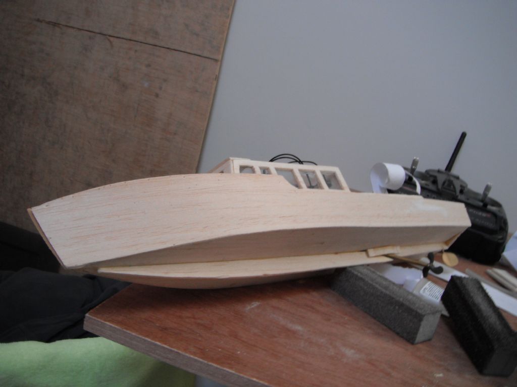

                                                      Next up skinning the thing. Sides first, bit of a gap at the bow. Sort that out later.
                                                      Sides on

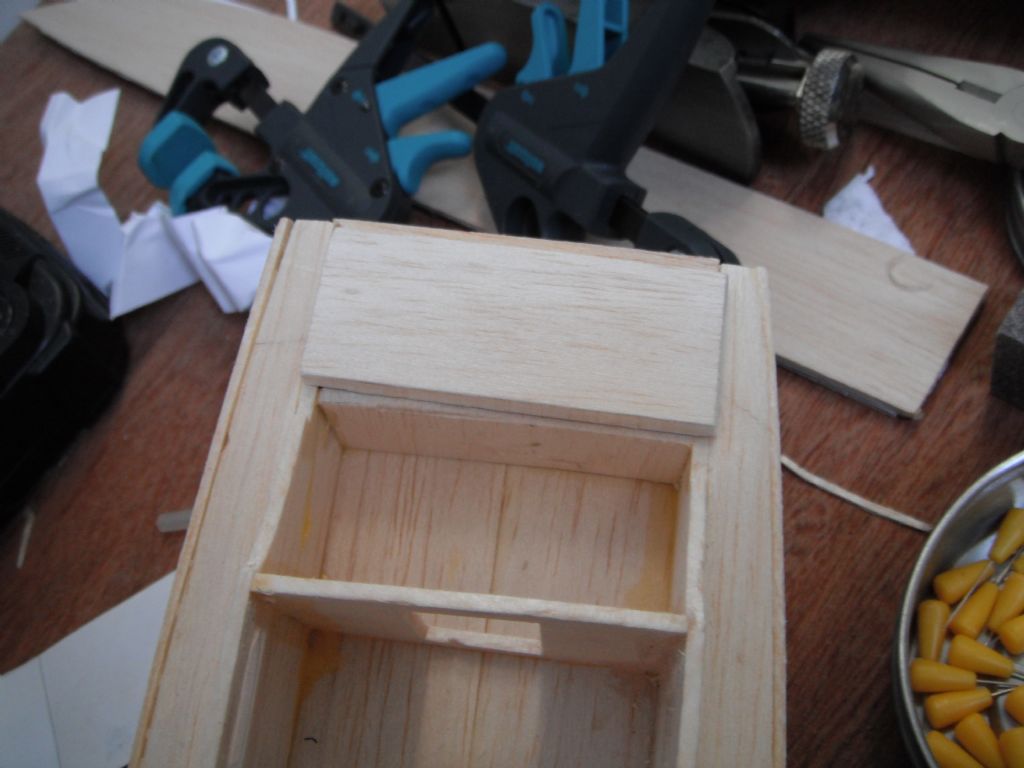

                                                      You remember I had that trouble with access to the rudder assembly, well, sorted now. Cut a hatch in the back didn't I. Now just need a hatch.
                                                      Oops again
                                                      Oh look. A hatch, glued a piece of balsa slightly oversize onto the piece that came out of the hole. I know what you're think, is it blurry or is it my eyes. It's your eyes, just kidding, waterproof camera with a really hard shutter button. Does it get adorned with stuff, painted a different colour? Who knows.
                                                      Rear Hatch
                                                      Hatch in place, fits quite tight actually, if a little wonky. Precision, not on this one, still learning. Have to watch painting it, as it might not fit after.
                                                      Hatch in Place

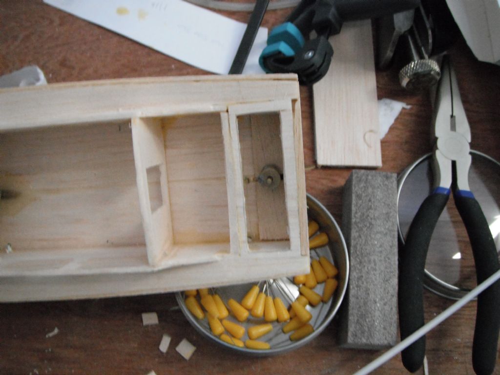

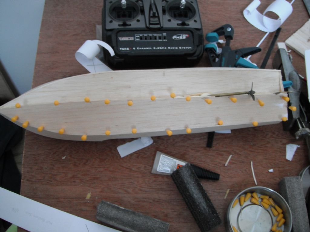

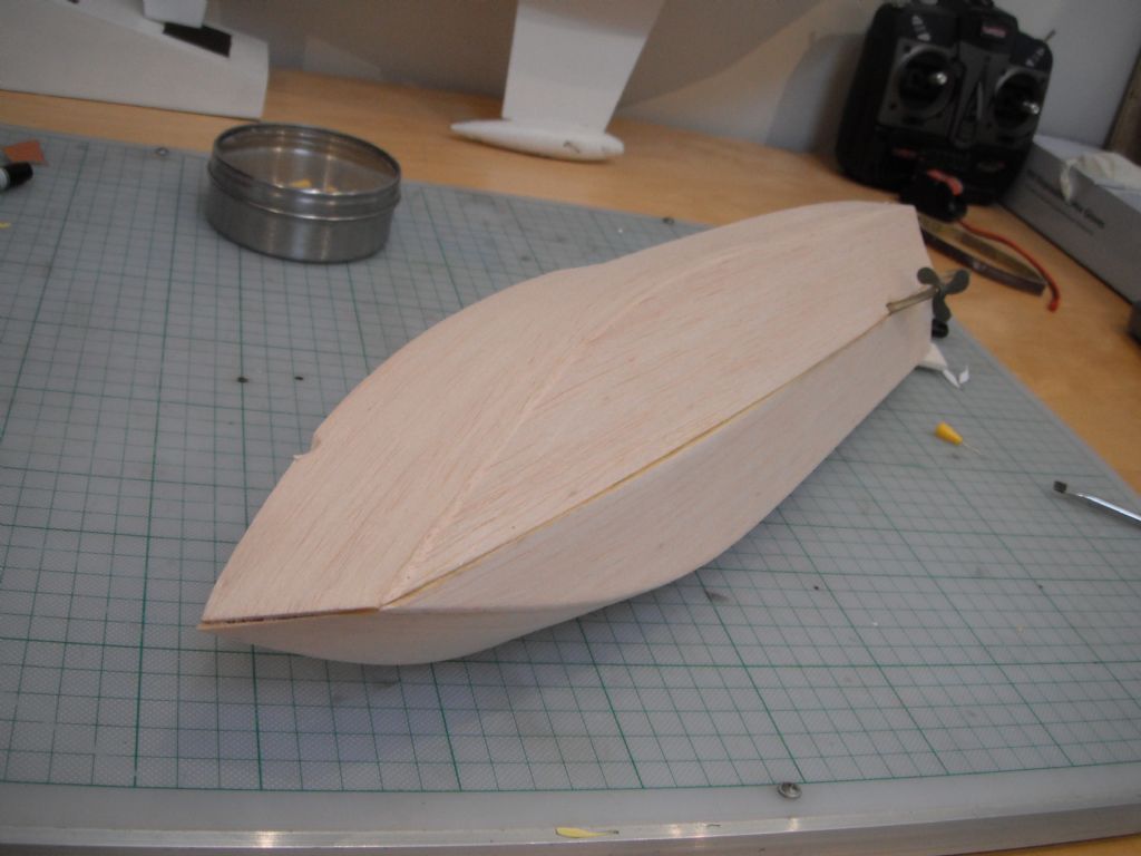

                                                      Now for hull bottom skins. Tricky to fit these as they needed a bit of cutting out at the propshaft and rudder tube. Looking a bit like a hedgehog with all the pins in it, but holds them in place while the glue cures. Now to the problem with the glue. I use Titebond II, which is yellow. Dries really hard and is not very forgiving. What do other people use, I have seen some using normal wood PVA, blue or green, but is there a real preference?
                                                      Bottom Skins 2
                                                      Glue dry, pins removed. she looks like a boat now. You can just see Goblin in the back ground, awaiting new sails and a paint touch up. Isobel has chosen a new colour for the top half, but more on that in the Goblin thread.
                                                      Back to Triton.  Need to fit the outer keels, front and rear. Now we will see if it is all square and in line. Well not far off, Keel is slightly off, but a bit of fiddling about straightens it up, a bit.
                                                      Prep to rub down

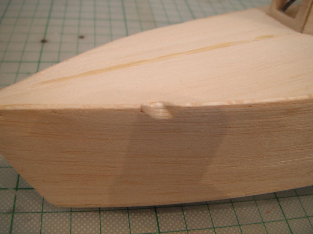

                                                      Now for the filling and rubbing down before the next stage, sealing and painting. The gap at the bow is bigger than I originally thought. I have some Deluxe Materials White Model Lite filler. Thought it would be better than the twin tailed lightning from across the pond. Oh, don't start that again, wot me.
                                                      Rub down in Progress
                                                      You may not know this "but I HATE Balsa", have I mentioned that. Well as you can see, I dropped it whilst filling the pin holes etc. Not to worry a bit of P38, no that is not right, Lite filler will sort it out. I hope.
