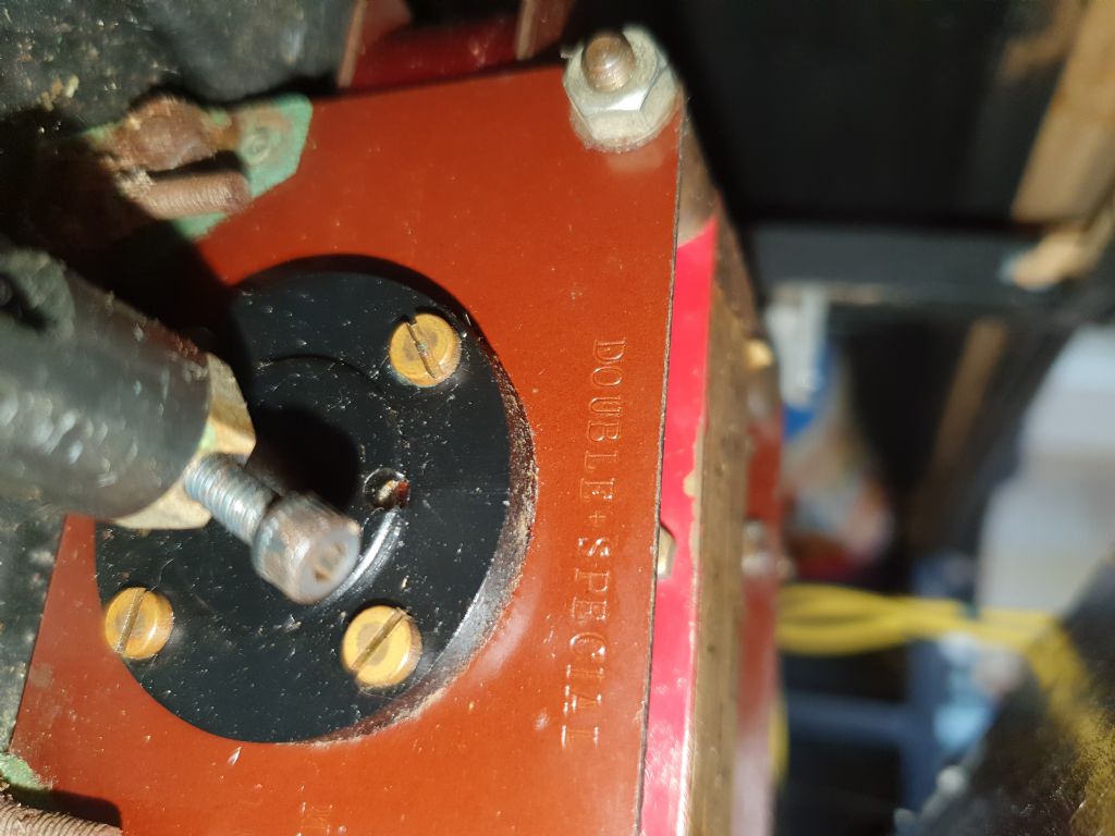

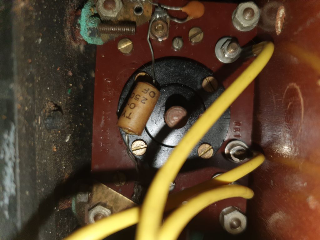

                              Perhaps another silly question, but my motor has three terminals on it marked common, forward and reverse. As I mentioned earlier, it has been set-up so that one channel controls the motor speed and a second channel controls forward & reverse. Would that make it compatible with a forward and reverse ESC?
                              Thanks for all the help thus far!
                              Cheers, Jake
                              #90430
                              Malcolm Frary
                                @malcolmfrary95515
                                That sounds very much like a motor from a different age. Almost certainly not compatible without a collection of modifications. Any other labels, like make or model?
                                Present day motors just have two wires, direction of rotation is decided by the direction of the current working against the direction of the permanent magnet, which is fixed.  Older motors from the days when high power permanent magnets were not easily come by had a field coil to do the fixed magnets job which could have two windings, one for forward, the other for reverse.
                                With a well hidden motor, this might need some serious digging.

                                  Hi jake,
                                  Sounds like a Taycol motor, I have one, absolutely no idea how it works or how to wire it up, yes 1960's finest 😀

                                    Thinking back to past conversations (something over ten years ago now) that I've had about Taycol motors, they were not particularly radio control friendly, being very good interference generators. The answer was a pair of Schottky diodes rated for about the same as the possible output power of the ESC, one for the "Forward" terminal, the other, connected facing the other way, in the lead to the "Reverse" terminal. I think most of the information ended up here – **LINK**
                                    Add to that that the controllers were generally not up to the abilities of modern ones. It was generally thought wonderful that you could actually cause the motor to turn when you wanted it to. Being able to reverse it was a bonus. Getting various speeds was almost beyond wonderful.

                                      Thanks chaps – you are quite right about the motor – and that link you posted Malcolm is extremely helpful so thank you for that. I managed to move the mount board enough to get a picture of the beast. A proud owner of a 1960s Taycol Double Special (sorry about the orientation):
                                      I know I can get that motor changed (and I may do that at some point) but I would like to see how the old girl runs as it is. The motor runs in forward when you connect to the 'com' and 'fwd' poles and in reverse when using the 'com' and 'rev' poles. Since the polarity of those connections do not matter I was mulling over whether I could use a switch between my new ESC's +ve output to switch between the motor's 'rev' and 'fwd' – pretty much the same setup that my uncle had. The left joystick would give rudder and throttle control and a separate channel operates reverse. Not ideal obviously and I can already tell when I am testing that I have plenty of interference, but I will see how I go with that!
                                      What would you guys do?

                                        Someting that you should never ever do with a brushed motor is lube the commutator. Unless you have a Taycol whose brushes really do need regular oiling.
                                        The simplest way to make it compatible with a modern controller and get the benefits of modern control is to invest in a pair of Schottky Diodes, as suggested in the link I offered earlier.
                                        As the motor works, it may be that the conroller is at fault. Since it was of its time, it could well be repairable with a screwdriver and file (I'm not familiar with that one), unless there is another problem. One such problem might be that the control just won't work with a modern radio – I would not reccomend using a radio that old anyway, technical sandards and legal requirements have changed a lot. Without going the diode route, a double switcher would give basic forward – off – reverse and work from a modern radio.
                                        After writing that, I looked for the "MFA Electro boat throttle".  It looks like a considerably later, but still early, electronic box.  It could well be that it was dropped in as a modern replacement for whatever was there before, found to be incompatible with the motor, and the whole project consigned to the attic.  The ESC, provided its plug will fit a modern receiver, should be testable needing little more than a battery and a modern motor and, as a way of keeping life fairly simple, a servo tester.

                                            Thanks, I shall have an in-depth read. One question…are the diodes for supression or something else?

                                              The diodes are to allow the current to only go where it is needed. The original, un-dioded version required that the battery supply would be connected to either the forward or reverse terminal through a switch, either manually operated or controlled by another channel.
                                              As originally supplied, no matter what the direction of the current, the motor would always spin the same way and only changed direction if the current was passed via the other terminal to use the other field coil. Thus it needed a controller for speed on one channel and anothe control channel to operate the switching device.
                                              A modern ESC reverses the current according to the information on just one channel, which for this type of motor gives a choice of forward or forward. Each diode directs the current to the right terminal for the wanted direction of rotation. Instructions in the link that both I and redpmg pointed you to.
                                              On most boats, suppression is done by capacitors. Modern motors with just two terminals, one component across the two terminals is usually enough, but some theoreticians insist that an extra two are needed between terminals and case. A field wound motor will need two capacitors, two on the common terminal with their other leg going to the other two terminals. A Taycol will benefit from a shot of oil on its brushgear and commutator, unlike any other motor.
                                              I suspect that back when the "new" ESC was installed, the required diodes had yet to be invented. The MFA box might still work, but there is no saying what might have happened to it while the attempts to get it working with the wrong type of motor. A pair of Schottky diodes of at least the current capacity of the ESC that you are going to use are needed. No need to bother about their voltage -the available ones start well above the voltages that are found in model boats.
