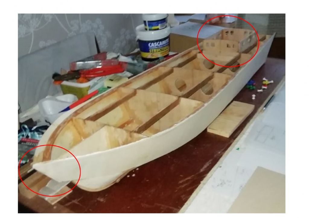

                      Hi Mike
                      The reason behind my original question about being specific about MTB 49 as there is a discrepancy between MTB 49 and the photos in your album.
                      I have copied the photo and highlighted the areas that dont fit with MTB 49, a squat superstructure at the stern and, from this angle, the bow seems to be a different shape.
                      All the best
                      #89959

                        Hi Paul,
                        The photo you are looking at is the hull of RTTL launch which I have almost finished.
                        I have not uploaded any photos of the MTB 49 but will do shortly.
                        Kind regards, Mike.

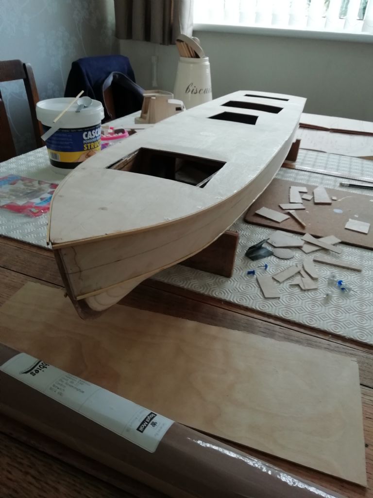

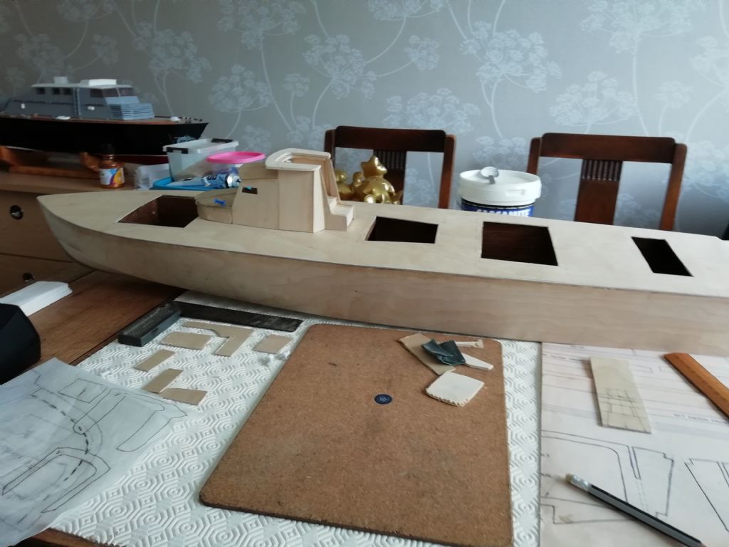

                          #89963
                          Michael Cole 8
                            @michaelcole8
                            Hiimg_20200714_134602.jpgHi Paul,

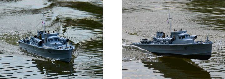

                                Hi Mike
                                Have you seen this website link
                                The chaps on these sites might also have valuable insight into your problem
                                Edited By Paul T on 14/07/2020 14:41:47
