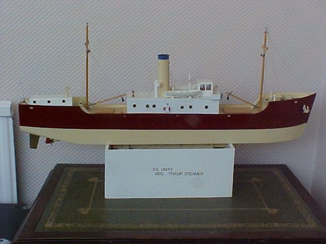

                      Hi, Andy a large motor is less trouble i have a Mabuchi 540 in my SS Unity it is geared 2 to 1 and runs for ages on two sub cs in parralel the weight of the motor gives perfect ballast and a spot on scale speed.
                      GordonSS UNITY
