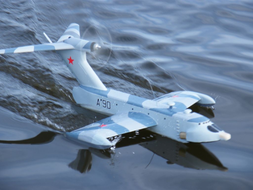

                  Motors whining, yes.. when I fitted a brushless motor and esc to my Ecranoplan, there are musical tones produced to indicate the correct programming of the esc…and this noise comes from the motor!! the motor is (electrically) exited to produce specific tones…amazing.
                  Had my little new landing craft out with a JP aircraft style 2800hz ESC and did notice any whine..perhaps though I have a toddy motor and so it is not that noisy?
                  #44271
                  Looverlijn
                    @looverlijn
                    Ecranoplan…Is that the strange Russian craft that neither floats nor flies but uses "ground effect"?
                    Love to see a pic of it.
                    Paul L
                    #44273
                      In my album, unfortunately it is a sort of skimmer, as a model, it does not actually do wing in ground effect, that would be a bit difficult! Ashley
                      #44278
                        Not going at full speed, but a taster of the beast on the pond.
