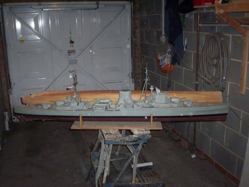

          Just as a taster, my Nelson, pictured, is 44 inches long, has two low power 540 motors and twin 30mm props. BUT my HMS Manchester type42 destroyer at 57 inches uses two 555 motors and 40mm 5-blade props.
          HMS Nelson 7

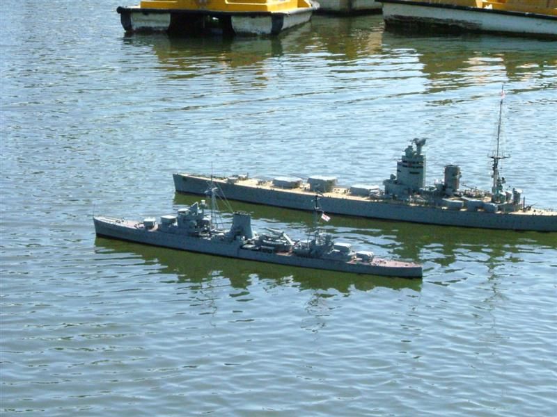

                    I think you only need 380 – 400 size brushed motors, this is my 48" HMS Diamond with 2 400 size motors with 30mm props and really moves swiftly as a 1/96th scale destroyer should 😀

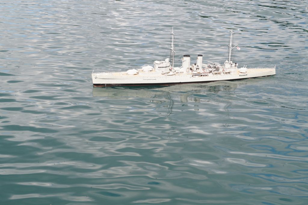

                            copy of dscf0497 (medium).jpghi ya there, are you building HMS Hood from the old nexus plans – now Taplett – that's about 52 – 53 inches long. If I remember rightly, she is built bread and butter construction. If you are, is there no suggestion as to what size motors you should use? What also has to be taken into account are the materials you are building with, if you are building bread and butter.
                            I have built several 4 shaft models, but, slightly larger than what you are contemplating – I built HMS Exeter and HMS Ajax – both are 4 shafts. They are 72 inches long and have 4 x 500 motors in them. One has a mixer combined speed controller in it, where the other one I opted for what is called tank steering – this is where one stick controls 2 motors on the port side and the opposite stick controls the other 2 motors on the starboard side.
                            This can give quite spectacular turning abilities – what you must also bear in mind is you will need to play around with which way the props turn. If I remember rightly, the Ajax turns better with the props turning inboard (in other words as you are looking from the stern of the model – the props turn anti-clockwise – throwing a wash onto the rudder.
                            Just some food for thought.
