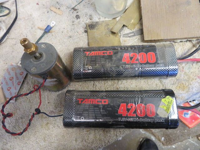

                          so the next question is………I bought this set of batteries some years ago for my ST 200 Sea plane tender but only ever sailed it once and the batteries were put aside and sadly overlooked. I have tried to charge them with a 50mah charger that I use for my tx/rx batteries, and it is either not pumping in enough juice or the batteries are now in a state of permanent comatose ………..is there any way of resurrecting them, or will they just become more weights for gluing decks down.
                          picture is of the two battery packs and the Buhler motor I will be using.
                          cheers for all your help and knowledge. neil.

                                      Like I said, ring CompShop and have a natter with Iain, if you can get hold of him. 18v is a lot of NiMH cells but that's not necessarily the most cost-effective way of getting there. All you need is a pack which will deliver that voltage and handle a discharge current of 1.5A reliably. They needn't be Sub-C size NiMHs.

                                              wont need to run the motor on 18v Dave……just sufficient for short blasts to either get out of bother or ti find the wind…………
                                              if its dead calm on the day i'll be thumbing a tow off one of the bigger lads, lol…..
                                              just need two packs of similar size to those in the photo to fit either side of the drop keel box which runs from the deck to the keel and splits the fore part of the hull into two halves

                                                  i'll give component shop a call nearer the time, or knowing me i'll end up with another set of knackered batteries that I forget to look after…..no hurry. still need esc's and batteries for my Shannon that sits like a nun in a beer house on my kitchen table. lol.

                                                    A 50mA charger will take at least 84 hours to charge a 4200mAH battery. To mess with a well known phrase, "You're going to need a bigger charger".
                                                    Would I trust a PP9 or its associated connectors with an important job? No. As mentioned earlier, They don't store that much power, and they are not intended to run a motor under load. Even in portable radios, if higher power was wanted (think "boom boxes&quot you would be using half a dozen "D" cells. You could do a reasonable job of driving a boat with rechargeable D cells, which worked better than the single use type, but the holders and connectors were always a problem.
                                                    #88007
                                                      that might be the problem Malcolm……..as I have only ever charged them for a few hours and then tend to forget that i have left them connected to the charger and turn the power off………..what a dummy. I shall see what can be done.
