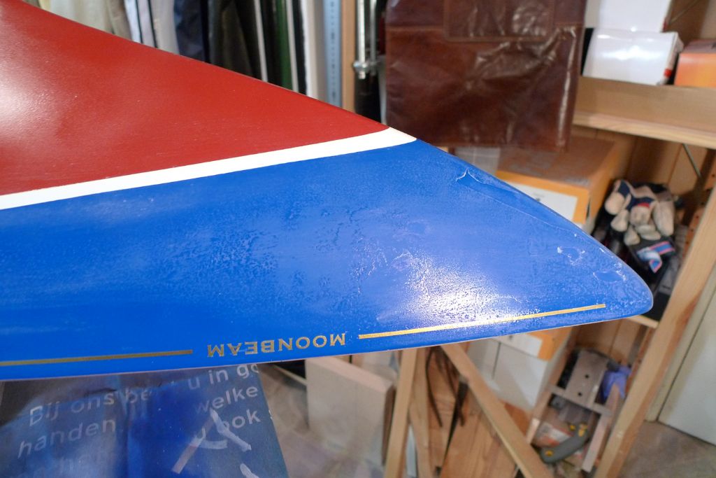

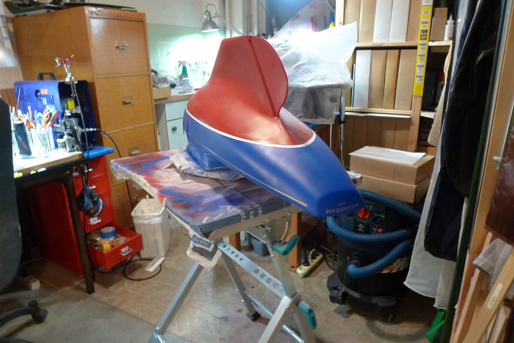

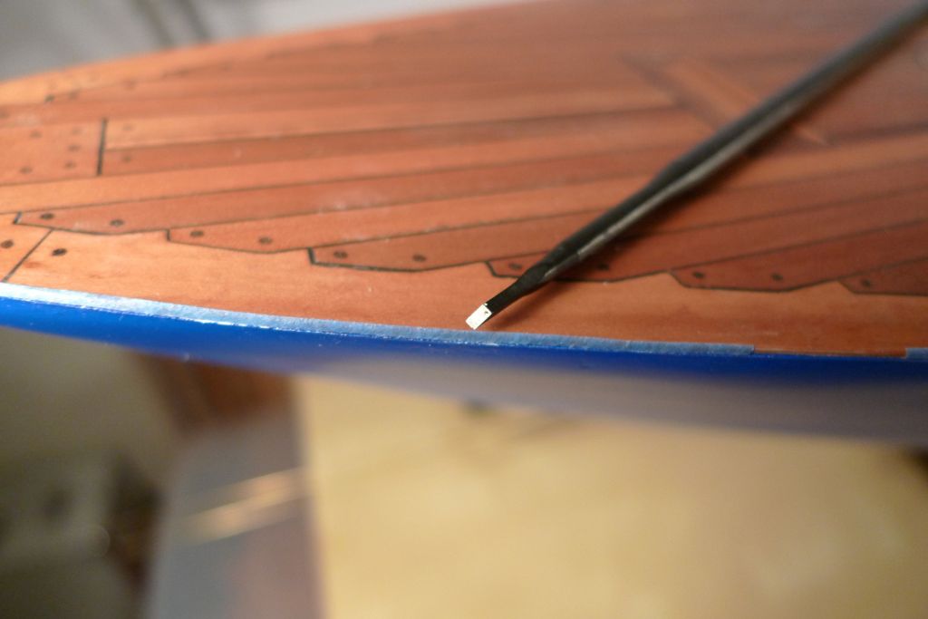

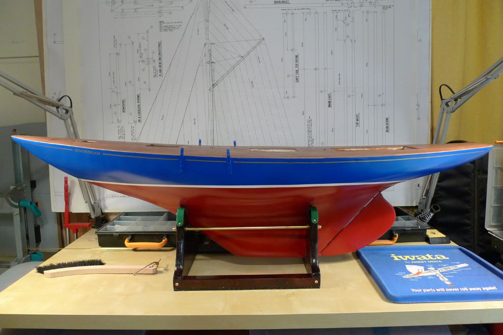

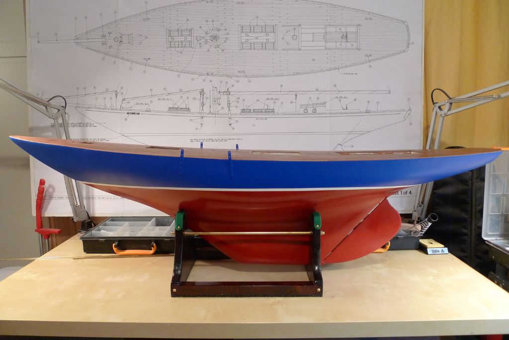

      Having slept on the matter, I went down today for a renewed look at the state of the paint line, and found it nearly good enough.
      An hour spent with a 1 mm chisel, used backwards as a scraper, allowed me to remove any paint that had strayed above the desired line, after which it was easy enough to mask off for a second time …
      … and then fill in with blue paint those parts of the line that still needed improving.
      The end result is still and most emphatically not perfect …
      … but it is now good enough to do me, and so will do
      To be continued …

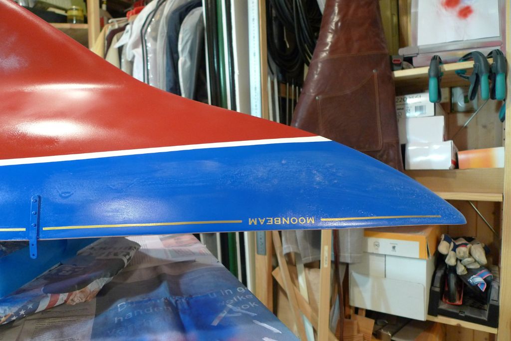

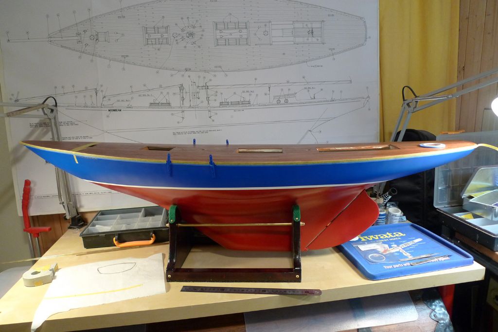

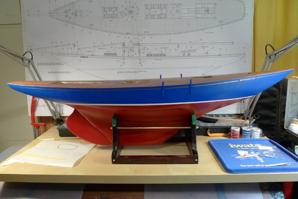

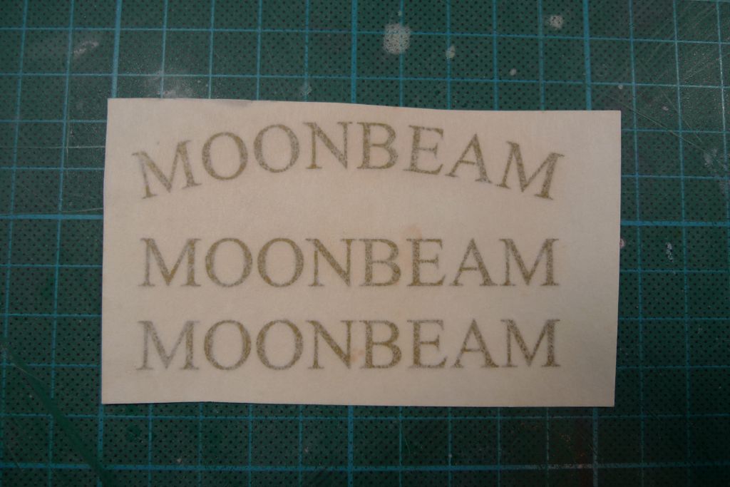

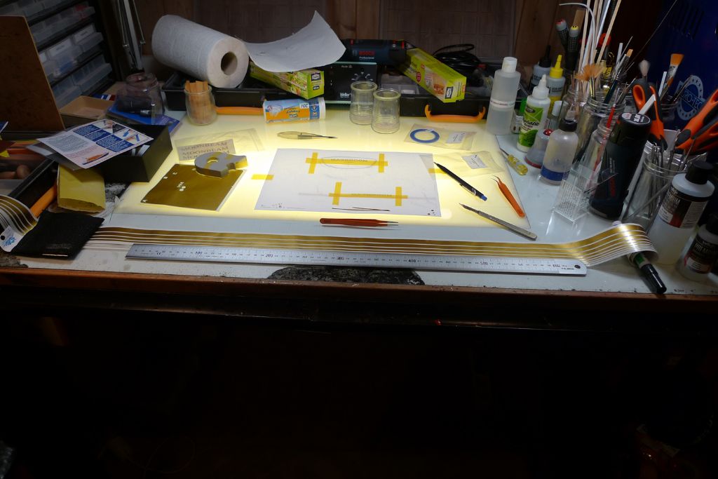

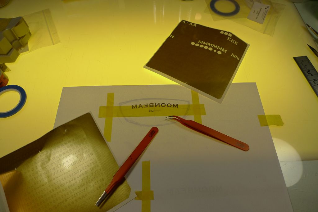

        With the paint job finally having passed inspection, it was time to get to grips with the name.
        The kit comes with ready-made lettering, with which I am – alas! – less than completely taken. For one thing, I find it over-large with its 10+ mm high letters, but also I don't really like the kerning very much.
        I therefore decided to use BECC vinyl lettering instead, and after some consideration opted for their new line of Copperplate Gothic Bold in the 6 mm size.

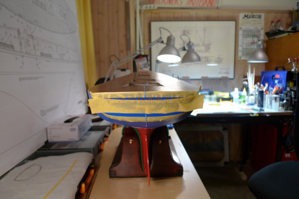

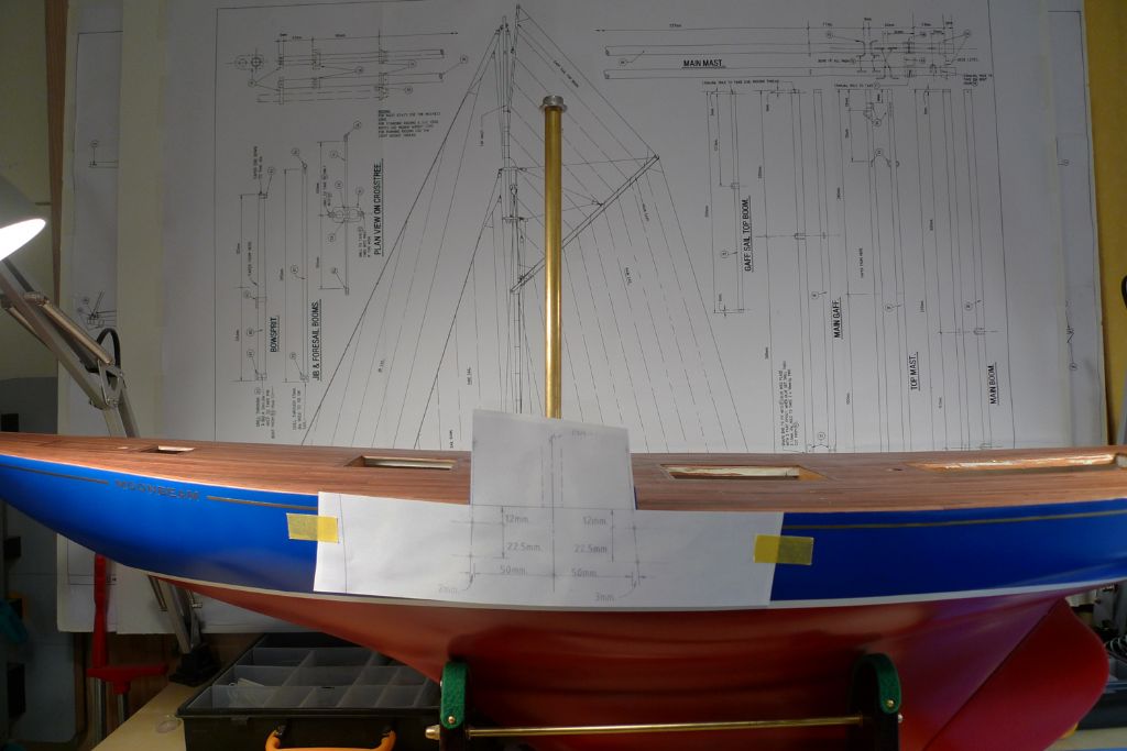

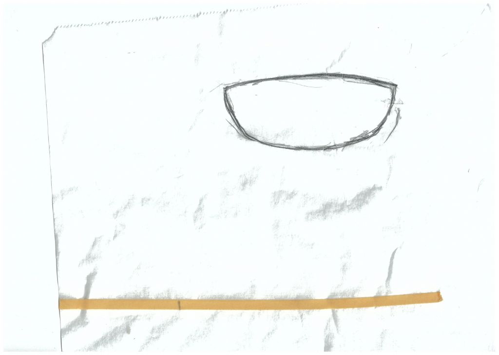

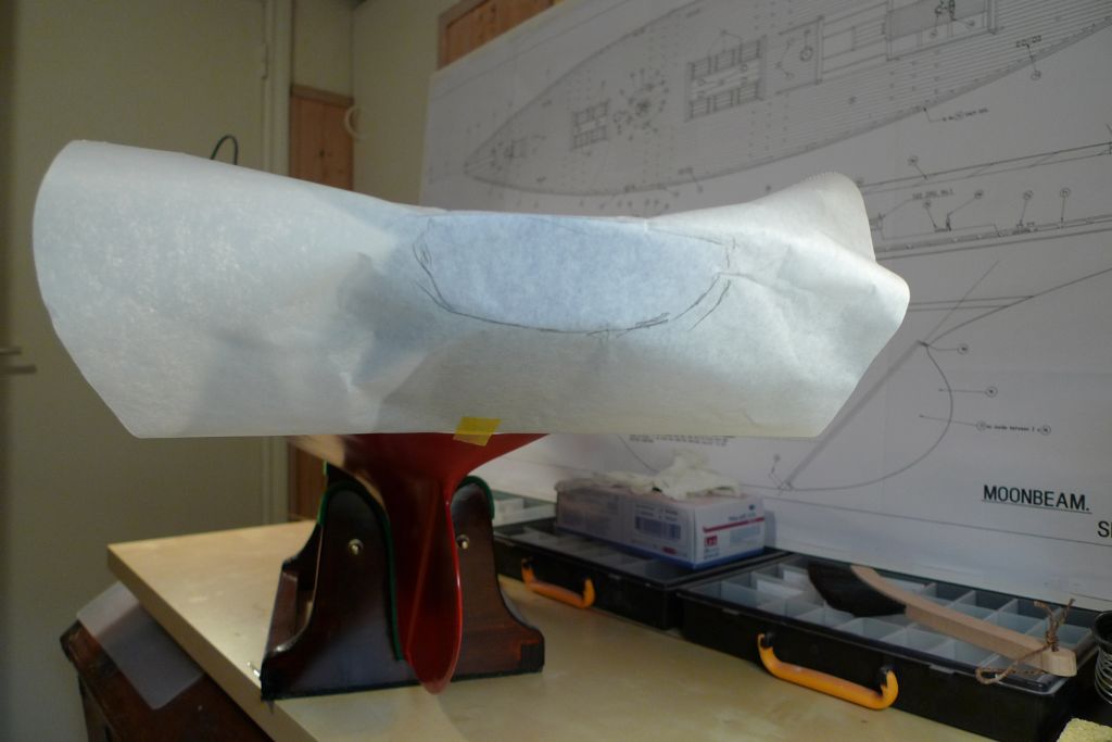

        However, before any letters even approached the hull, I got out some greaseproof paper, onto which I traced the shape of the stern counter.
        I also marked out the sheer line at the bows with some masking tape applied to the same piece of greaseproof paper …

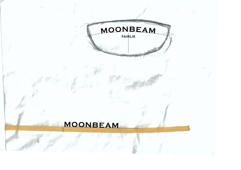

        … whcih was then scanned …
        … and mounted in an InDesign document.
        After turning the image until the counter was level, I created curved lines to follow the camber and the sheer, and then typed in the name along these curves.
        I also decided to give her a port of registry, and for this purpose selected Fairlie on the Firth of Clyde in Scotland. This is of course a complete fantasy in that, as far as I've been able to ascertain, Fairlie never had a ship's registry like e.g. Greenock or Glasgow did. However, Fairlie is were William Fife constructed and built the real-life Moonbeam yachts, I, II, III and IV, just over a hundred years ago, and while this Moonbeam is not a scale model of any of those (but in fact a replica of a circa 1913 pond yacht), she does actually to some extent ressemble them. So, in homage to the genius and skill of William Fife and his workmen, I decided to have my Moonbeam registered in Fairlie anyway.
        Anyway, the document was printed out and brought down to the workshop, where I taped it upside down to the lightbox. A piece of masking tape with the sticky side up was then taped down onto the paper, and the letters applied – again with the sticky side up – to this tape with the print-out as a guide.
        After marking out where the name should sit with some more masking tape …
        … it was then easy enough to just apply the tape with the name on the backside to the hull …
        … and, after pressing down lightly on the letters, to remove the tape backing, leaving the name applied to the desired spot in one single operation.
        To be continued …
        Mattias
        Edited By Banjoman on 03/11/2016 21:35:05
        #68450
        Banjoman
          @banjoman

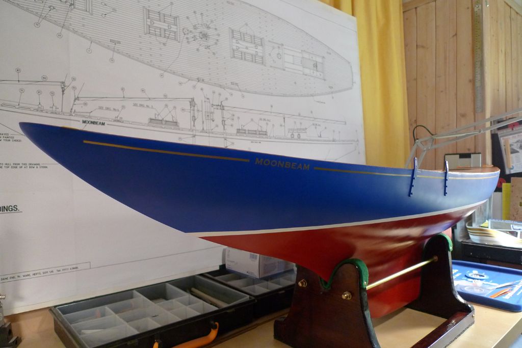

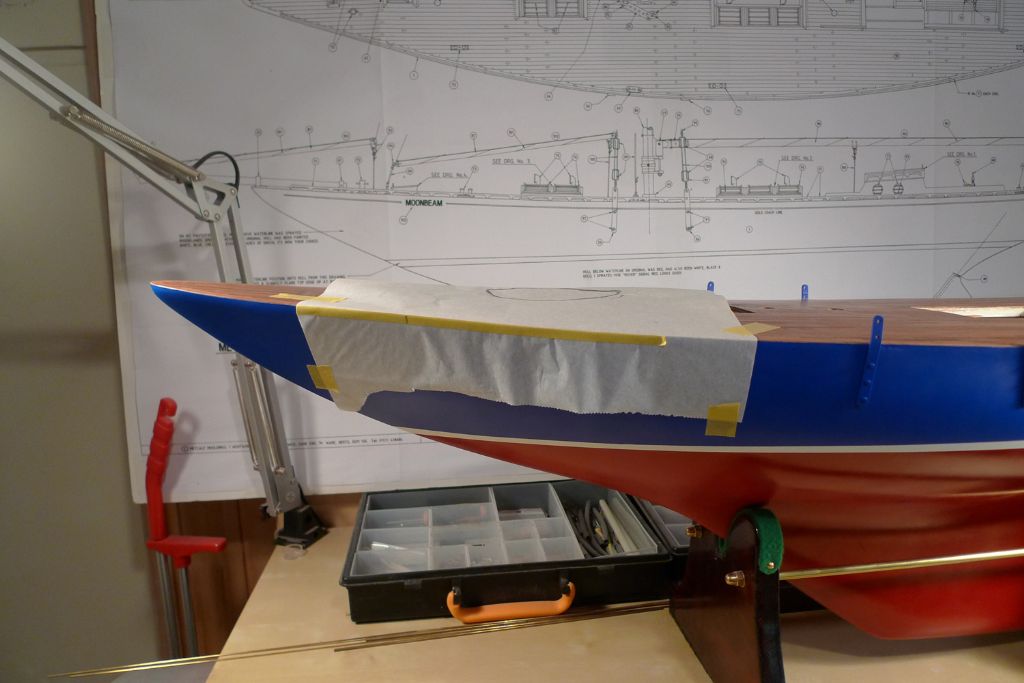

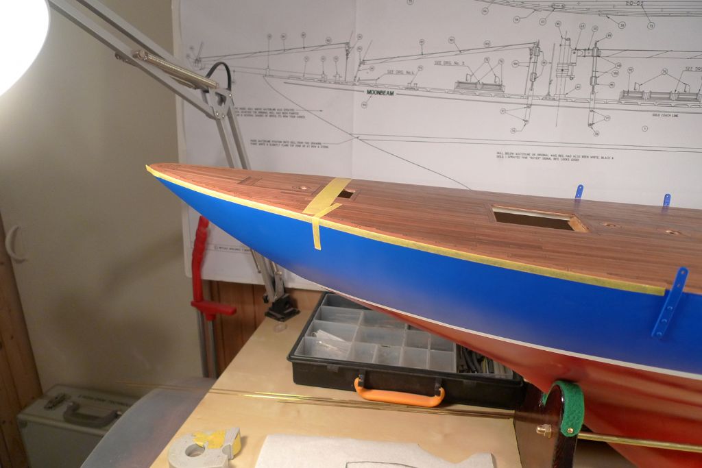

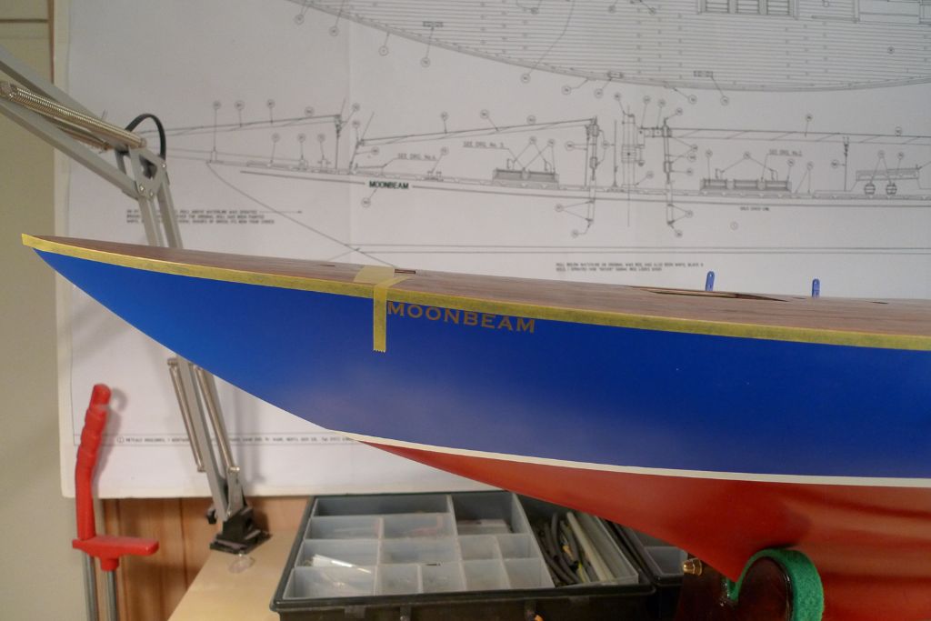

          With the name applied omn the port side, I added more masking tape all along the upper hull on that side; first some 6 mm Tamiya and then some 3 mm washi …
          … after which I measured for and cut off suitable lengths of 2.1 mm wide gold trimline …
          … that was put on to the hull just touching the lower edge of the masking tape …
          … thus producing a gold line 9 mm below and parallell with the sheer of the deck.
          To be continued …

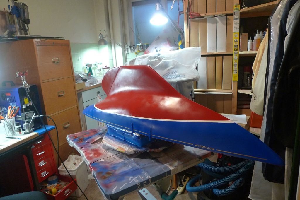

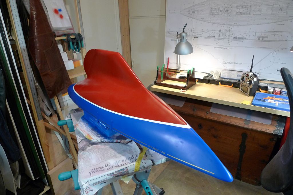

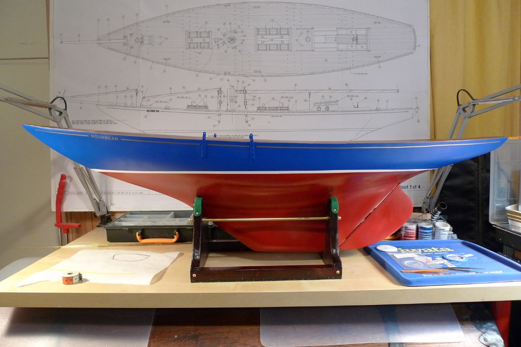

                First up, I replicated the name and trimline work on the starboard side …

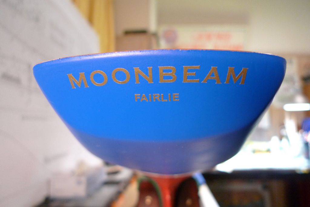

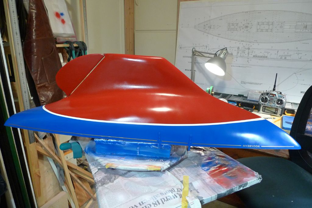

                … and then set about assembling the letters for the stern …
                … again using some masking tape to create guidelines …
                … with this fairly pleasing result.

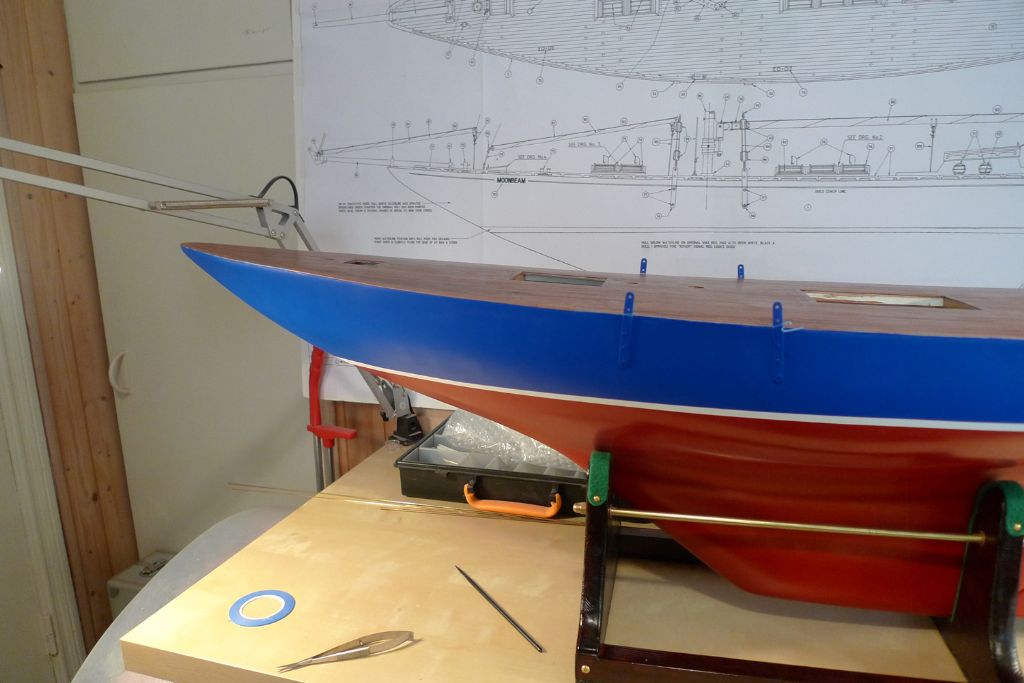

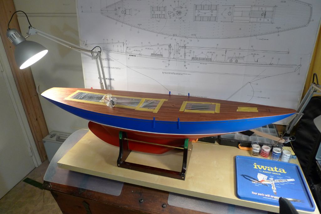

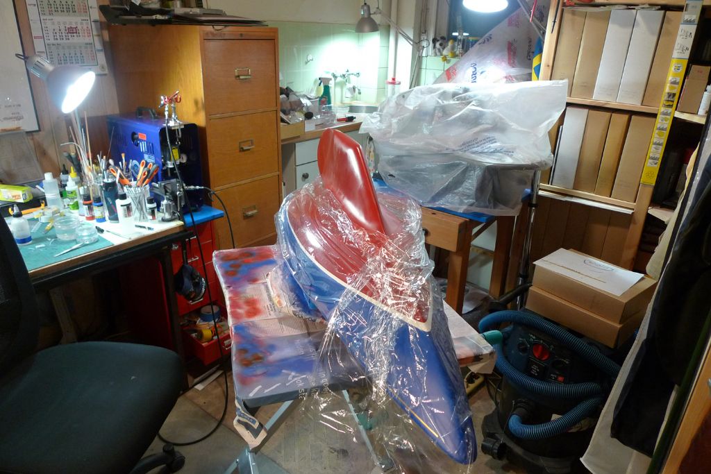

                It was then time to prepare for the final paint job on the hull, i.e. putting on some clear varnish.
                I thus masked off just the hatch openings – the deck shall also be varnished, so any small overspray that would land there would not be a problem at all.
                The hull was then turned upside down once more, hopefully for the last time.
                At this point I noticed that the stand had made some small scuff marks in the paint on the keel, what with the weight of all that ballast, so I rubbed the spots in question down with kitchen roll paper …
                … quickly wrapped the rest in clingfilm, and gave touch-up things up with some more red paint.

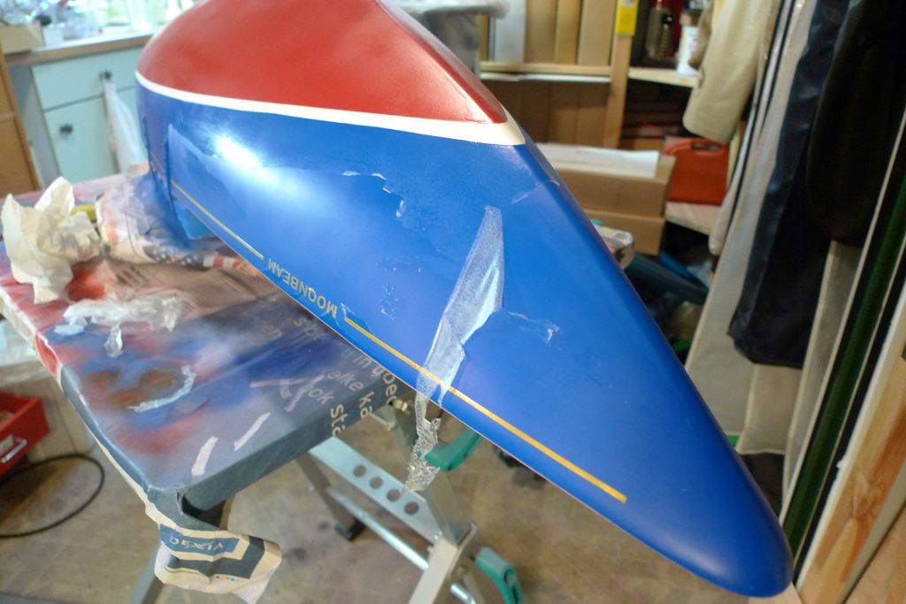

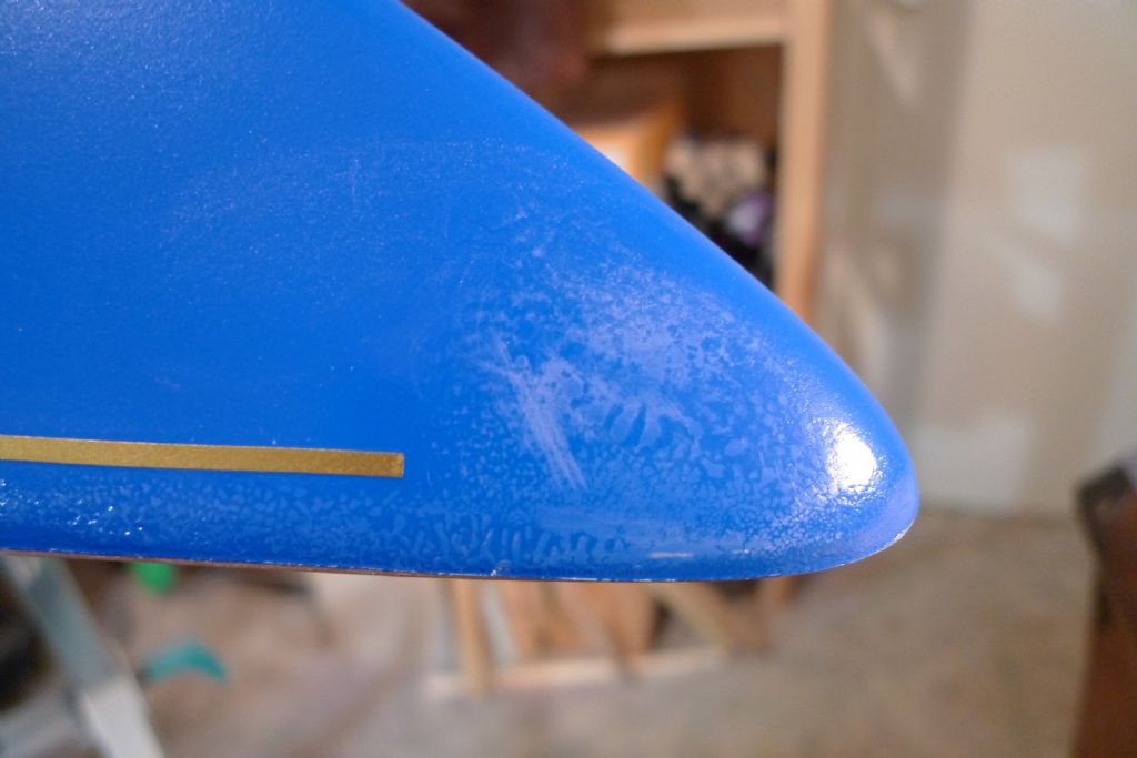

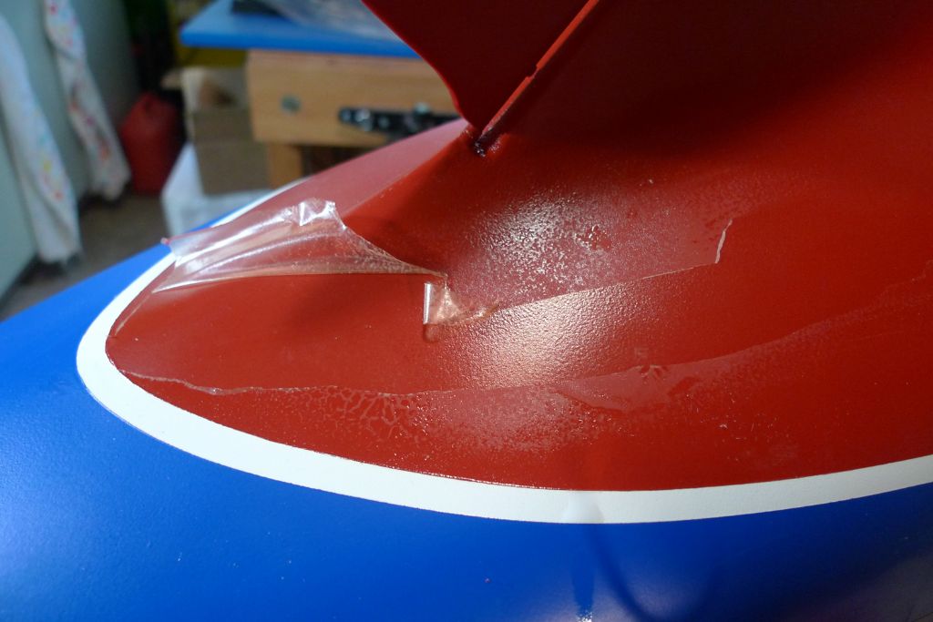

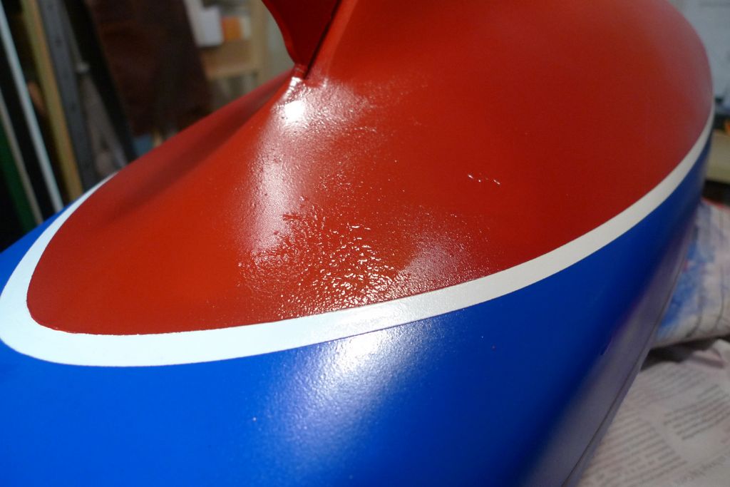

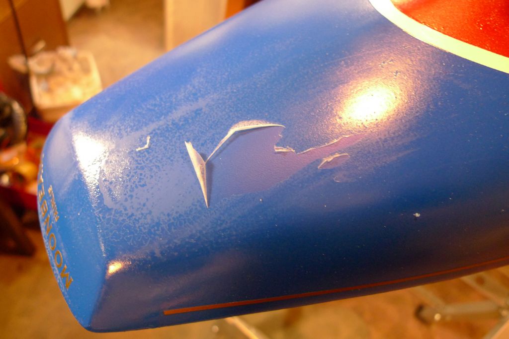

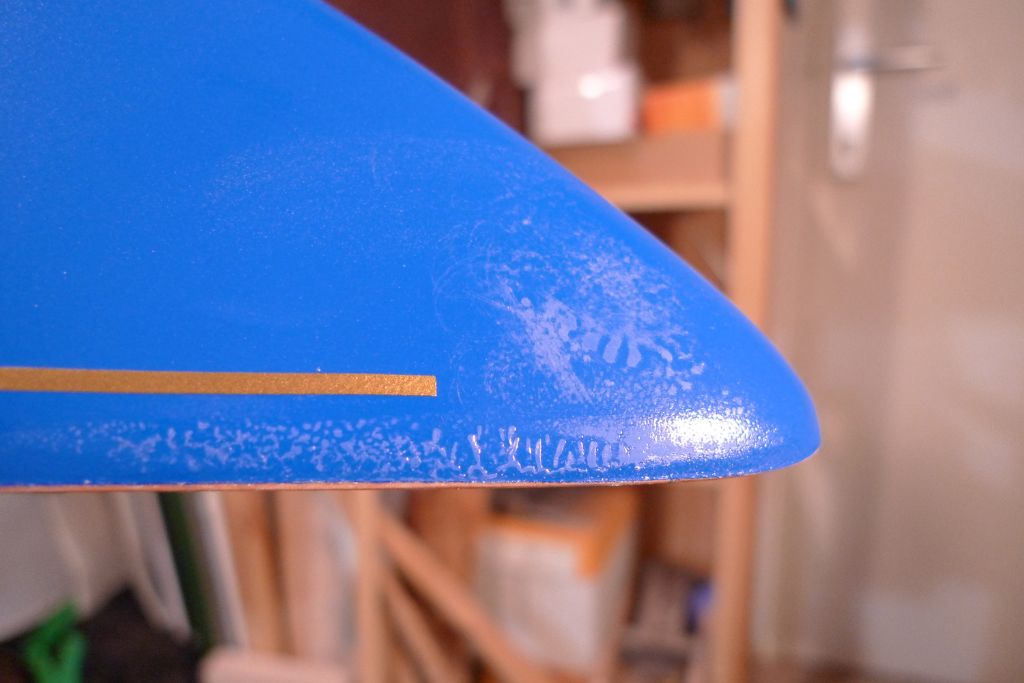

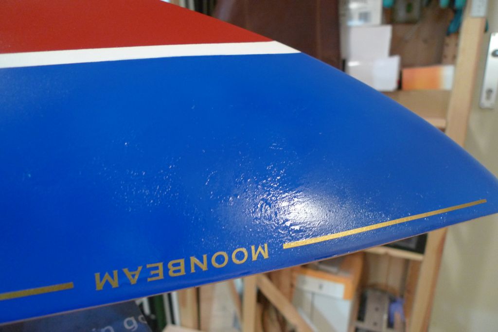

                When the paint was dry enough, I started to apply the first coat of varnish, which is when everything went completely pear shaped!
                I had quite forgotten that the varnish, although from the same brand and series of paints, is rather more liquid than the colour paints, and so (a) requires much less pressure from the compressor, and (b) will form runs much easier.
                I used much too much pressure, and and had far too much varnish blown on, which subsequently began to run and otherwise deform.
                In other words, I now have a number of areas around the hull with runs or just horribly unequal varnish …
                … while in some places I even fear that the underlying paint may have risen.
                In any case, the whole thing looks awful – and reality is rather worse than what I've managed to catch on photo – so it very much remains to be seen what can be done.
                Tomortrow, I'll have a good look and, if it is dry enough, will first see how much can be remedied with simple but very, very careful sanding.
                Another thing that can also be done is to, even more carefully, remove and/or smooth down as much as posible of the offending varnish with a cotton bud dipped in methylated spirits, which dissolves both varnish and paint.
                Both methods will have to be used with extreme care, if the underlying paint is not to be too damaged, not to mention all the letterwork, but if neither works out well enough, I shall have to remove all the letters and trimline, sand down to and reapply the red and blue topcoats.
                Oh, bother. Rats, even.

                  Well!
                  (he said again)
                  After writing my previous post, I went down for a last look before bedtime, if nowt else to make sure that I would have some proper nightmares about bad varnish tonight, and lo and behold! The self-levelling qualities of these paints and varnishes never ceases to amaze me, and while there are still a quantity of blemishes as a result of today's botched job, they look much less bad now than what they did even a couple of hours ago.
                  Yes, I have my work cut out ot get at least a decent surface finish out of this debacle, but in just a few hours it has gone from looking neigh on impossible to just a job of work to be tackled with patience and good humour.
                  I think I shall be able to forego some of those nightmares now

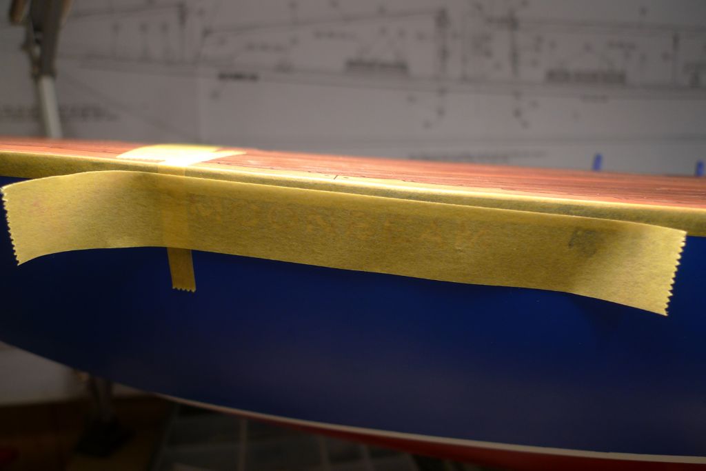

                      As for the recent sticly tape around the top edge, I was not all that nervous; the paint was quite dry and stable, and Tamiya tape is of course well known for being just the right amount of sticky. Still, as you say: removing masking tape from a painted surface is a job that usually comes with at least some trepidation …

                        This morning I returned to the workshop, and started sanding – very carefully, of course – with some 600 grit paper …
                        … when all of a sudden a phenomenon, familiar from when I had my varnish incident on the Eilean Mòr-build (**LINK**), occurred: the paper began removing the varnish in strips!
                        I immediately knew that because I had put on the varnish much too fast and much too thick yesterday, it had not married with the underlying paint, but just formed a film.
                        This in turn of course meant that large swathes of the varnish could very easily be peeled off …
                        … leving the paint underneath perfectly intact …
                        … and completely removing all the unsightliness!
                        A fair amount thus came off just under the fingers …
                        … but where this was not enough, I had a further trick up my sleeve. By applying water to the edge of the remaining varnish, some will be pulled in under by capillary power, after which rubbing with ordinary kitchen roll paper will loosen yet another swathe.
                        I kept this process up for some four hours or so, going round the hull several times, until no more varnish would come loose. Some were thus left in situ, mainly along the bottom of the keel, where it had gone on much thinner, and thus attached properly to the paint. Here I just rubbed down the edges until they were completely invisible …

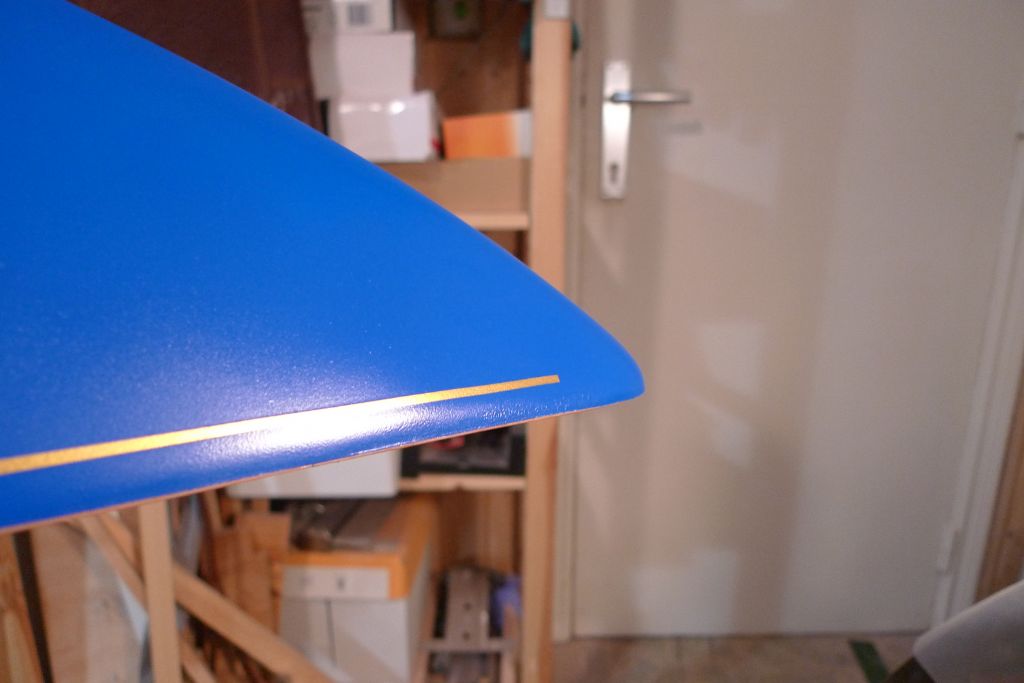

                        … and then proceeded to spray on the first coat of my second attempt at applying varnish! Needless to say, this time I had the compressor set to a much lower level of pressure, and put on only a very thin coat.
                        Once a certain number of such thin coats have gone on, I'll go over everything to check whether there are any spots where the red or blue paint needs touching up just a little, but at least I am back on track again after last nights scare and I count myself very lucky indeed to have gotten off the hook so easily …
                        To be continued …

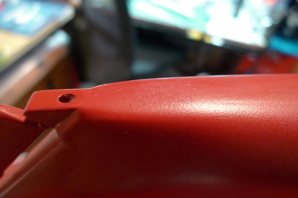

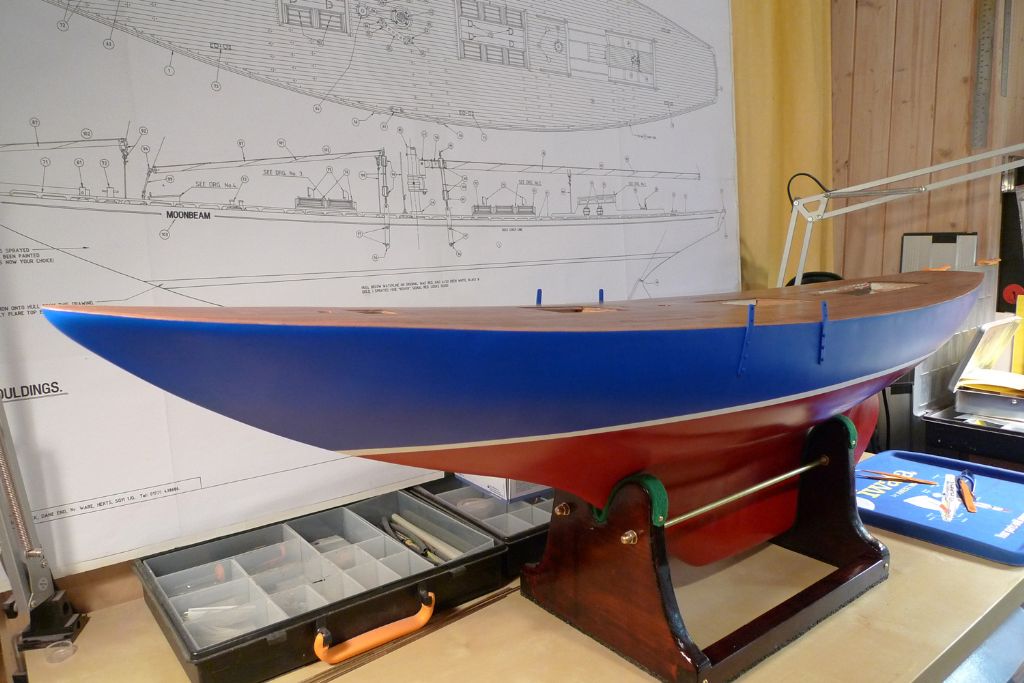

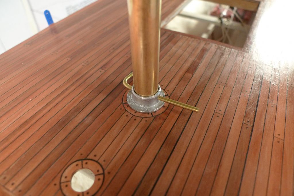

                                      When applying a coat of varnish Monday evening, I had another instance of crinkly varnish; however, after it had been left to dry for 48 hours …
                                      … it was easy enough to sand down …
                                      … and re-varnish. Before applying any varnish, though, I also went over the whole surface with first some 000 steel wool and then a piece of kitchen roll, to flatten and prepare the surface.
                                      Including the re-varnishing coat just mentioned, I had, as could be seen from my very advanced high-tec tally system, applied a total of eight coats of undiluted varnish.
                                      I now applied a further three coats, thinned down with one part reducer to three parts varnish.
                                      This makes the varnish slightly slower to dry, which improves even further its already excellent self-levelling properties and thus gives a smoother and glossier final surface.
                                      And final surface it is! After the third coat, I looked and found it good enough. Huzzah! Possibly even jolly good
                                      There are still a couple of spots along the topsides where there are some very discreet but nevertheless curtain runs of varnish. These, however, I will leave as-is for the time being, and look at again once the hull has been turned right side up. If I then think that they need dealing with, they can easily be sanded and re-varnished in conjunction with varnishing the deck.
                                      That is some time in the future, though — the hull will need to be left up-side down for at least another two weeks, to make sure that all paint and varnish has gone off completely and formed a hard enough surface that the weight of the ballast pushing the keel against the stand won't produce any marks.
                                      This is probably the main disadvantage with the paints I use — they have a number of excellent properties, but being water-based PU acrylics, their use involves a fair amount of time spent watching paint dry. Oh, the excitement!

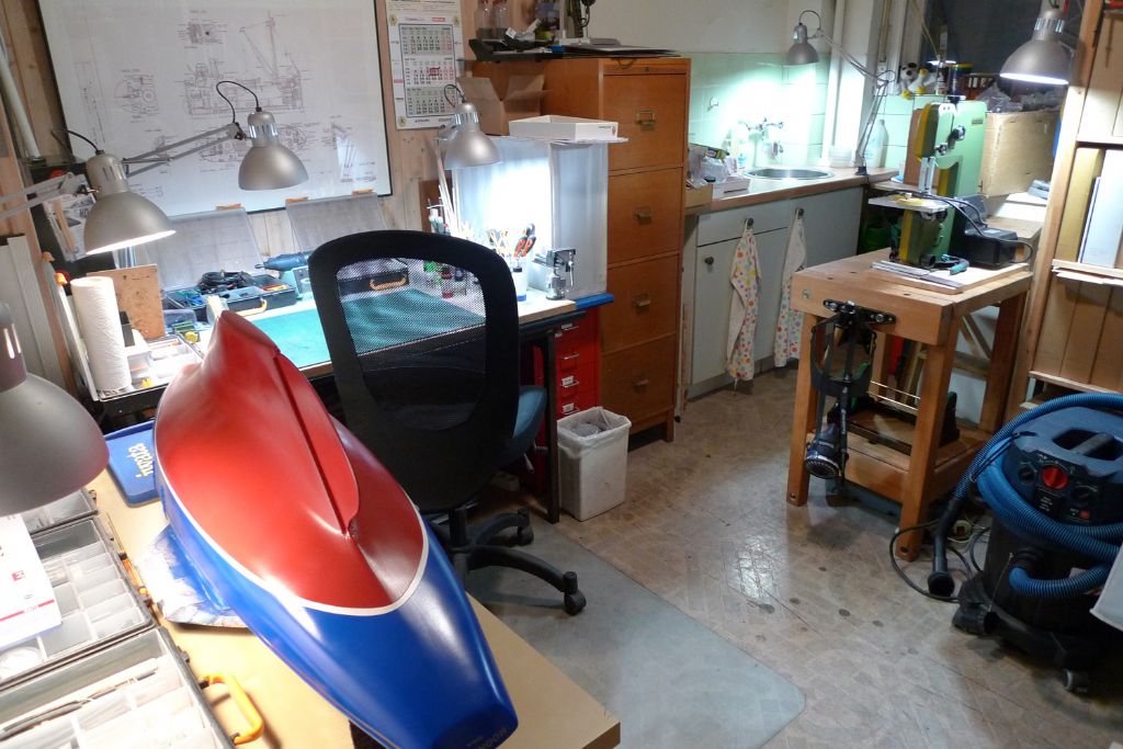

                                      No real worries, though: I shall spend some the intervening time by cleaning my workshop and then start preparing the white metal fittings.
                                      To be continued …

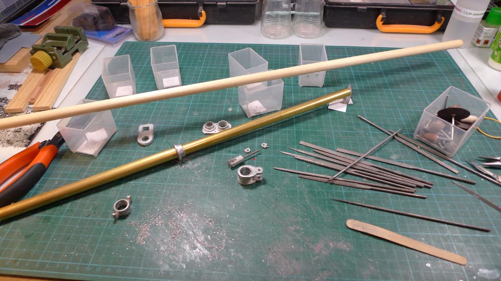

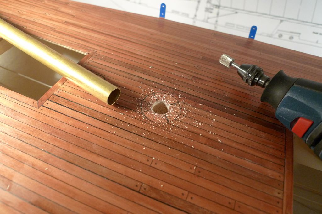

                                                    Over the last two and a half weeks I've had hardly any time for building at all — a family visit, band rehearsals and gigs plus life in general has occupied pretty much all of my spare time — but then on the other hand this has not been entirely a bad thing as it has helped me resist the temptation to turn the hull over too soon.
                                                    I did, however, find a few moments and used them to break out the mast and mast fittings. The white metal castings needed some fettling, and I also began preparations for some planned reinforcements of the mast step in the form of two brass tubes, one 17/32" and the other 1/2" o/d, with the smaller being a nice slide fit into the larger.
                                                    However, what with lack of time and also the need to have access to the mast step hole in the deck in order to progress, I did not get very far until yesterday afternoon, when I finally found some time again, and thus decided to turn the hull back the right way up — hopefully for the last time …

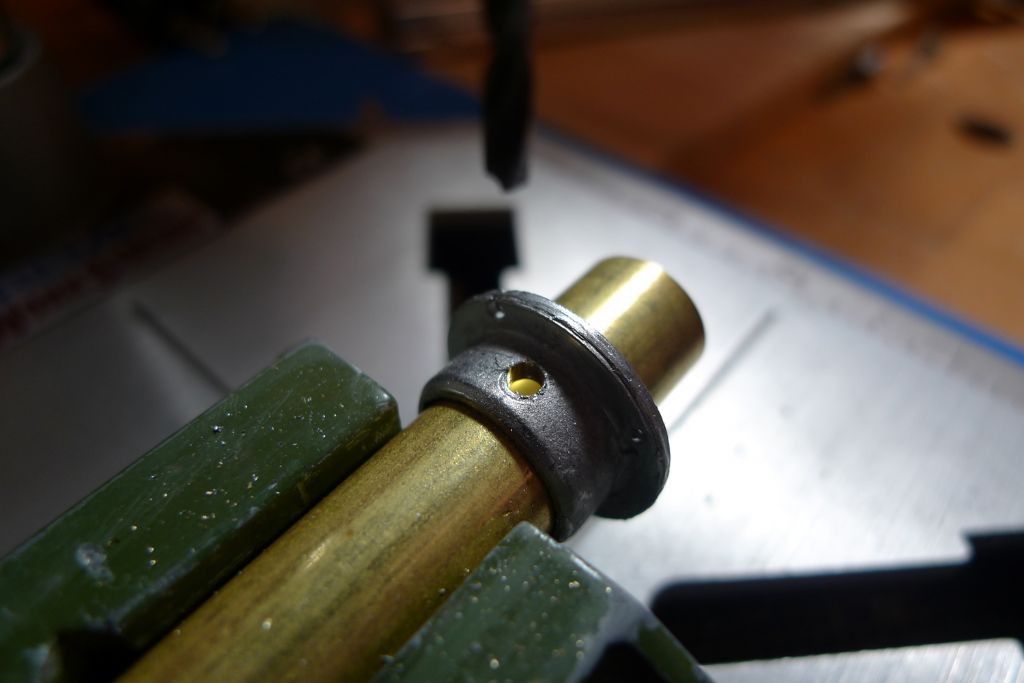

                                                    Anyway, instead of going with the kit instructions and just inserting the wooden mast end into the step drilled into the wood mast support block, I have decided to line the step with a piece of 15/32" brass tube. I had already during construction drilled a basic 12 mm diameter hole into the support block at more or less the correct angle, which now had to be enlarged by about 1.5 mm to take the 17/32" brass tube.
                                                    This enlargement of course had to be done in such a way that the mast, when stepped into the hole, will sit by itself at more or less the correct angle, so I temporarily added the extract from the plans that indicate the angle in question, and kept trying the brass tube up in the hole as I gradually removed the necessary amount of wood with a router bit in the rotary tool at fairly low revs.
                                                    When I was happy with the mast step hole, I dryfitted the white metal mast base ring to the lower end of the brass tube, and then drilled through both all the way with a 2.5 mm drill …
                                                    … to produce a hole for a mast pin (the overlarge one seen here is just temporary, and not the finished article).
                                                    I should add that the deck has not yet been varnished, just given two coats of sanding sealer. Before varnishing, I would like to prepare and drill for all deck fittings, as it'll be much easier to sort out any dings or scratches from that job if no varnish has been applied.
                                                    To be continued …
                                                    Mattias
