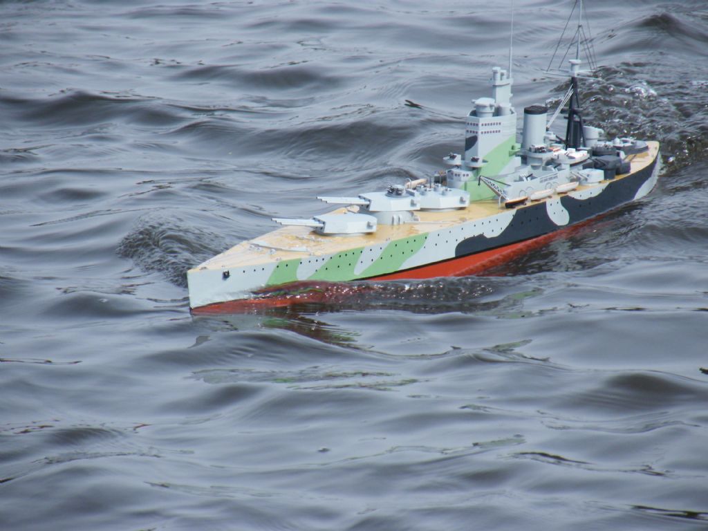

                                Good work there Josh. I would add more fibreglass and rub down until the deck is fixed in place, just a thought, as then the deck will blend in well with the sides.
                                ​From experience I know it can be hard to flat down fibreglass as it always seems a bit tacky and it is very hard. For my HMS Nelson, I roughly flatted the sides with course wet `n`dry, and then scraped a wodge of p38 filler straight from one end to another with a long straight edge. This evened out the hull sides nicely and flatting off was then relatively easy.
                                ​AshleyHMS Nelson 10
