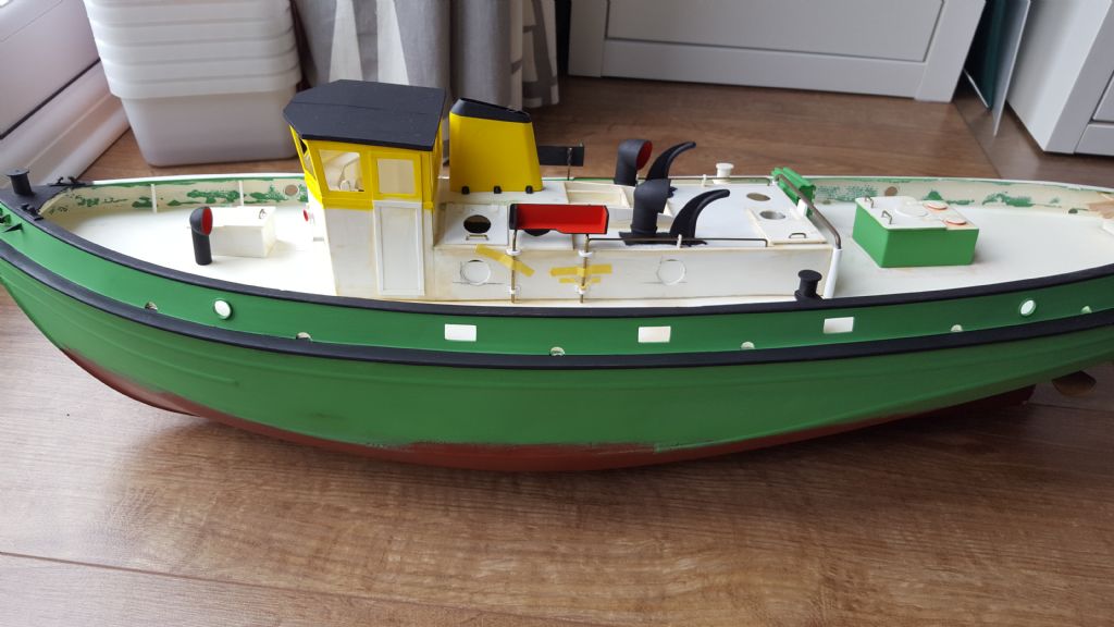

                          #94587
                          timg
                            @timg12590
                            Posted by timg on 19/03/2021 18:46:25:
                            Hi All
                            Picture attached ( hopefully)
                            Just a few coats of paint to see what it looks like on the hull , pretty happy with the result, it does look a bit lighter green outside ( depending if the sun is out).

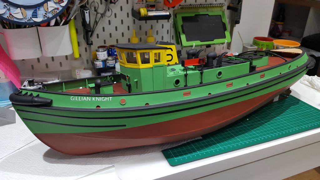

                            #96384
                            timg
                              @timg12590
                              Hi All
                              My build is moving along (very slowly due to it being silly season at work) looking abit more like a tug
                              #96390
                                The green has worked out very well and suits the model. I'm sure she will look the part on the water.

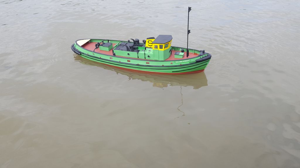

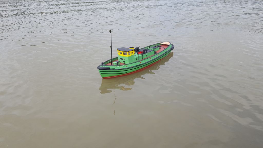

                                  #97442
                                  timg
                                    @timg12590
                                    Hi All
                                    A few pics on the pond from a couple of weeks ago, now quite finished yet, a little more information needed on the steering components/deck fittings . I'm happy with the result so far.
                                    Thanks for looking
                                    #97443
                                      She looks superb. The green works perfectly and makes for a really eye catching and unusual model.
                                      #97653
                                      timg
                                        @timg12590
                                        I should have added the model / vessel details
                                        The real tug
                                        50ft motor tug built in 1963 by Drypool Engineering & Dry dock company in Hull ,for Gilyott & Scott freight company. She still operates up and down the river Hull for her new owner John Dean tugs.
                                        The model is 1/24th scale , 27.5" long grp hull, most parts are scratch built .
                                        I live in Hull and see the tug most weeks although she now has a completely different bridge after a refit a few years ago, which may be a future project .
