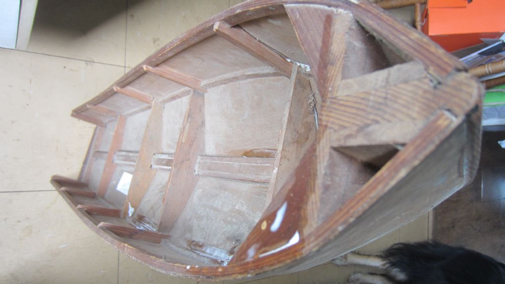

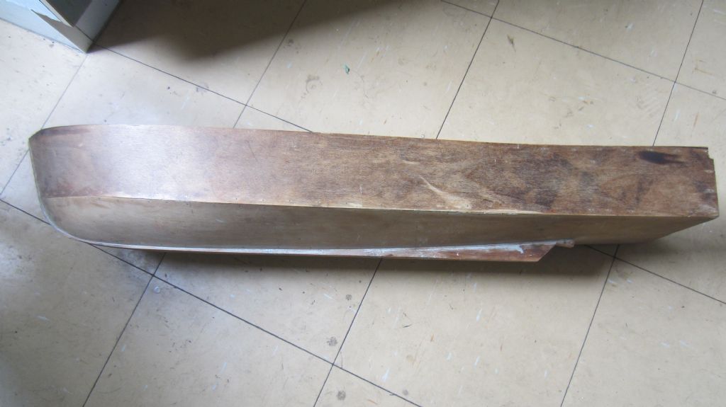

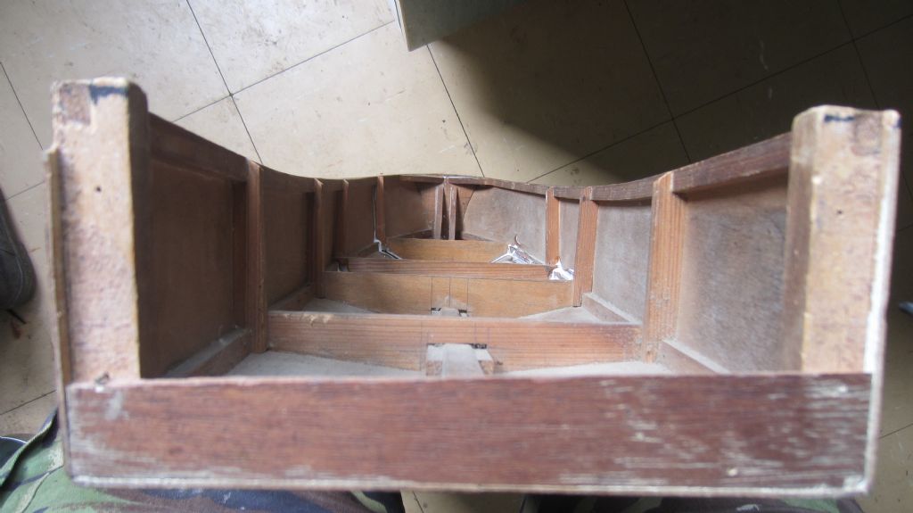

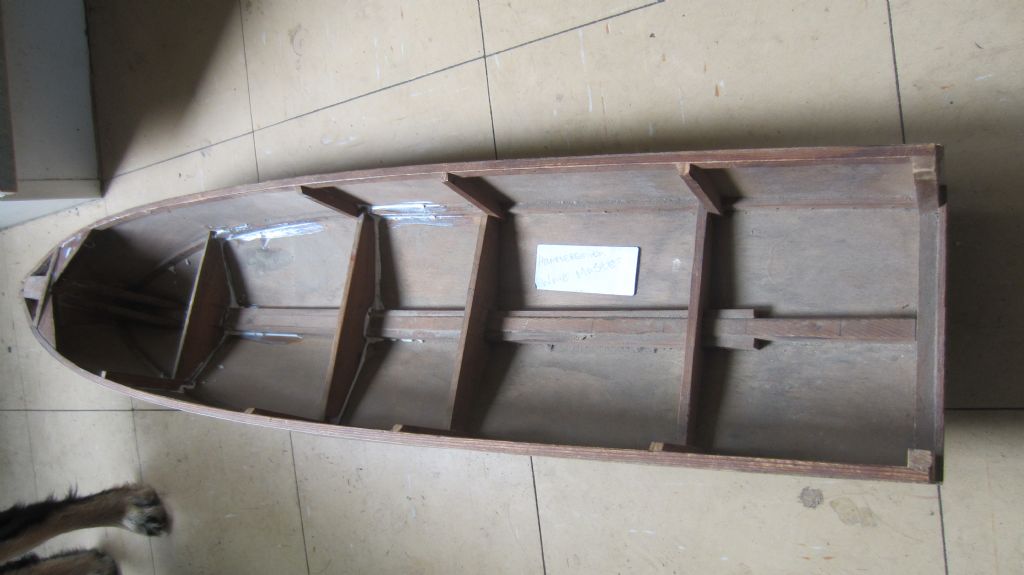

      Hi all yes
      I was given this hull by our lads scout leader a few years ago and after asking elsewhere was told it might be a Hammersmith Wavemaster. I wont be rushing anything, I have a RC Tiger Moth scratch build and my motorcycle projects underway too but I'd love to get a boat built and on the water so I always have something to do.
      I've built 1:1 iron hull narrow boats but wooden RC boats are a bit different.
      I'm not sure whether to go for the 50's style as intended or a more modern style img_2099.jpgimg_2100.jpgimg_2101.jpgimg_2102.jpg

          Hi M,
          Assuming the Wavemaster was a kit, I don't think your hull shows any signs of being built from the usual plywood bulkhead s etc in a kit, but the timbers at the bow make it look scratch built, it would make a good basis for a Norfolk Broads cruiser?
          Regards R

            Thanks for your reply Ray. Identifying it is only of partial interest but trying to find plans that it might have been built from has been a trial. How to go about finishing it would have been revealed. like I say, I'm new to model boats. Should I fit any strakers? Flat deck or cambered? Any stringers to support the deck? Plans would have been good but I'm no stranger to overcoming such obstacles.
            I'll take a look at Broads cruisers.

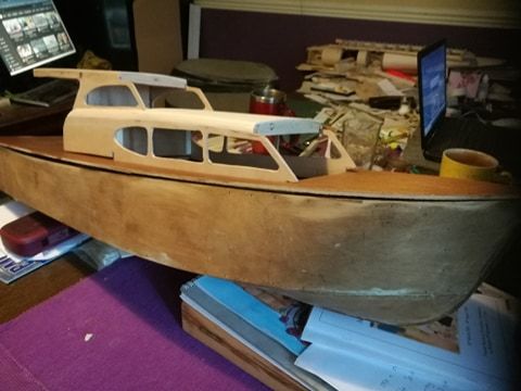

                      Progress. Roughly assembled to see how it sits. I found an instruction manual on a facebook page with close to accurate outlines of components for the kit. I like the shape of the cabin and the hull is similar but narrower, so some modification needed. Still lots of sanding to do, shaping windows.

                      #91388
                        That looks like a nice balanced design plus you have lots of choice for colour schemes if you look around online.

                          Thanks Colin. The cabin is loosely based on a Chris Craft. I'm trying to find pictures or plans for scratch built hulls that are similar to this so I can get a clue which way to go. Do I make solid bulkheads or make stringers to support the deck? The sides are pinned in place so I think I'm going to fibreglass it. Being my first build I don't want to make a mess of planking it
