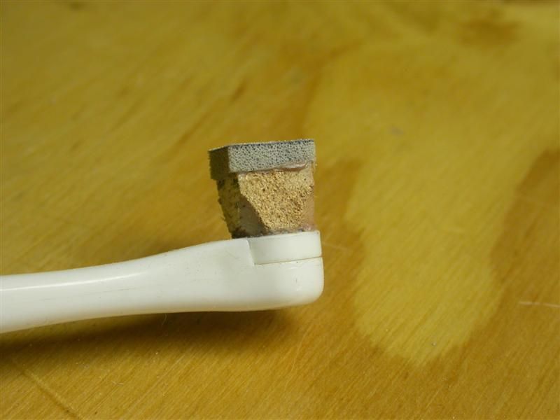

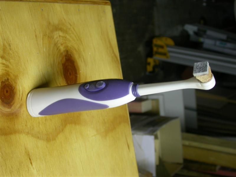

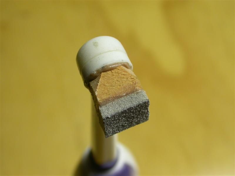

      Hi folks. I have been wanting to try this for a long time, so when I spotted a cheap battery powered electric toothbrush on Dealextream, http://www.dealextreme.com/p/2w-electric-toothbrush-blue-white-2-x-aa-80925 For $6.50 US. I thought that I would give it a go.
      I cut the bristles off the brush head with a craft knife and glued a small cube of wood on, then glued on a 10mm x 10mm x3mm piece cut from a foam sanding block.
      It works well at sanding small recessed surfaces that you cant get much of a stroke to hand sand.
      That is all.
      David.
