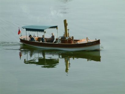

        #22552
          Hello Phil
          Can you post a picture of this crackin` model please…………..I`m very curious!
          #22564
            It’s in the August edition of Model Boats Bob, and posted as a website article for subscribers only.
            And yes, a working steam launch built from card is certainly something out of the ordinary!
            #22567
              Just a picture …………..please
              #22568
                Will this do?
                #22570
                  Yes, thank you, Colin
                  And that`s made of paper?……As Phil says……It`s a cracker!

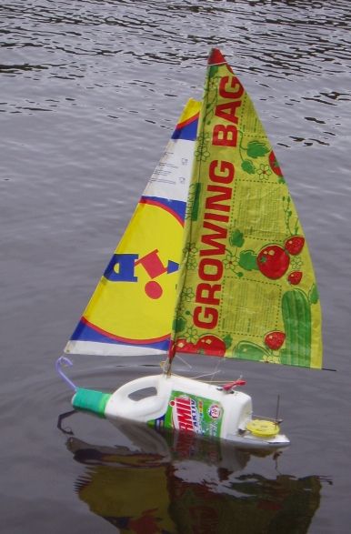

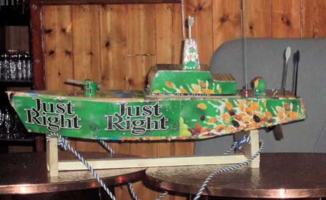

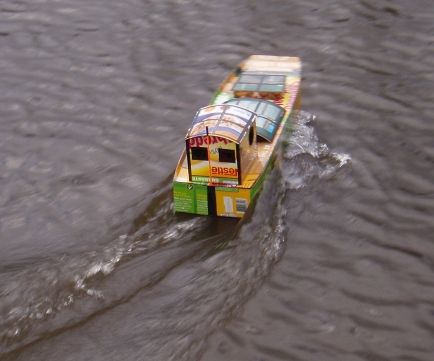

                          Thought you might like to see some other paper boats,they were participating in one of the Commodores challenges a few years ago and I might add they can still be seem sailing on the lake to this day.
                          Even got the writing just right hasn’t he
                          This one as got a really good turn of speed, made by our Club 500 Sec.
                          And last but not least a re-cycled boat from an earlier challenge to really get you thinking , no paper but from re-cycled rubbish
                          Martin’s one of our best recycler’s
                          Hope this has got you thinking a bit more, who said model boating was expensive!.
