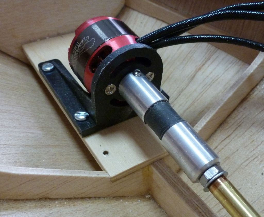

          Robin
          I removed the threaded prop adaptor from my Leopard motor, turned the motor around and used a standard plain flexible coupling on the other end of the shaft.

                    If looks like an m5 thread, how do I remove threaded prop adaptor without upsetting my new motor?
                    #69407
                      If you look at the motor you'll see that the prop adaptor has a cruciform plate which is screwed to the red motor case. If you remove the four Allen screws then this plate can be taken off. You then mount the motor with the other end of the case as shown in the photo of my installation. The shaft is 3.17mm diameter (aka 3.2mm nominal) which is a standard coupling size. **LINK**
