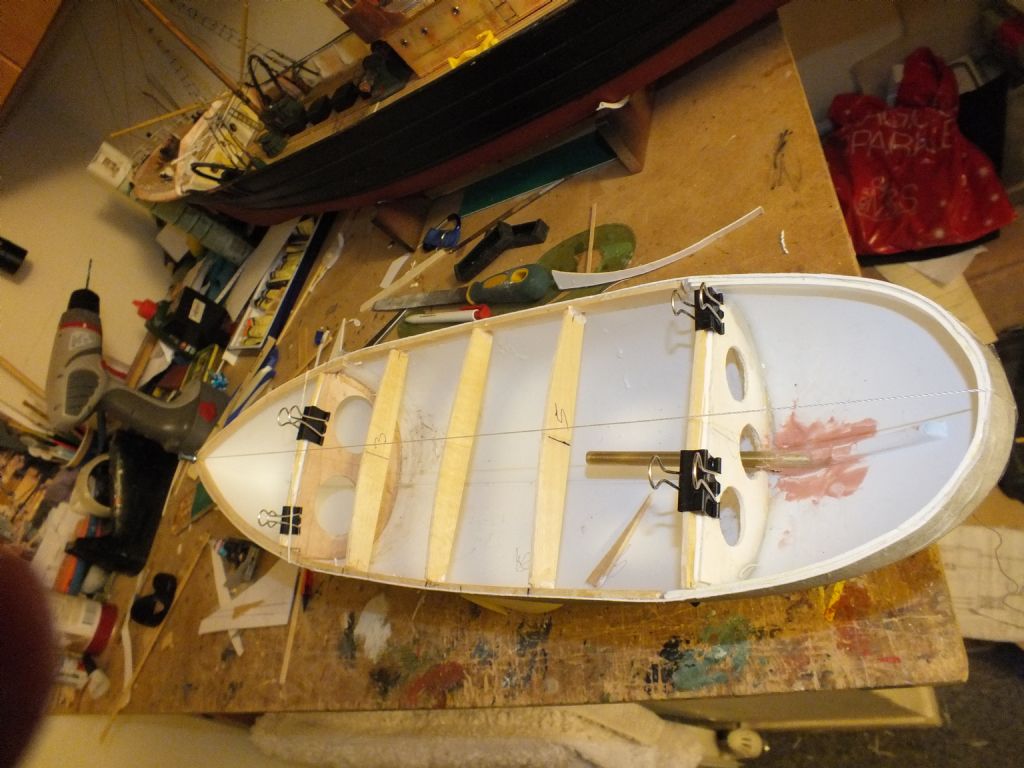

              HI ,
              GARDSMAN PILOT BOAT, using syrene hull work so far , along side north sea trawler my nightmare build , but coming on ………..Larry…

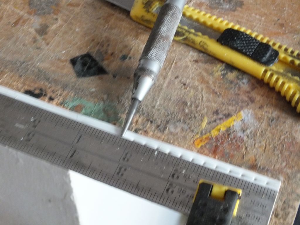

              #38048
              LARRY WHETTON
                @larrywhetton68737

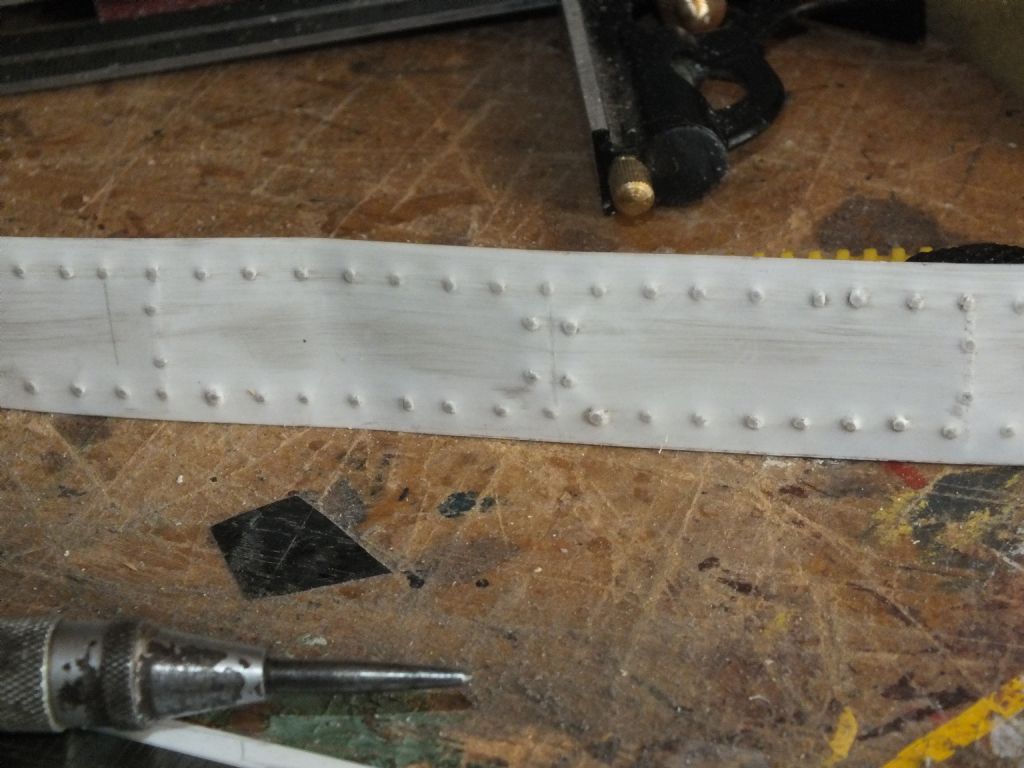

                photos of rivetts , simple jig for spacing , fun to do ….Larry…rivetts
                rivetts
                rivetts close up
                #38049
                  Well done, Larry!
                  This should be interesting!…….Are you using Litho? As it doesn`t look like card
                  I would suggest you stop plating just below the water line, as the curves get very tricky
                  Take your time and maintain accuracy

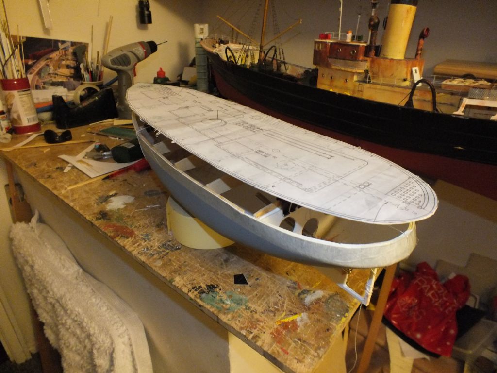

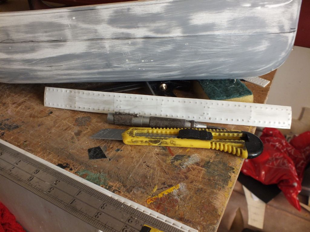

                    Thank yo , for comments using …..point 5 styrene sheet have stuck some on hull……
                    will post photo tomorrow, for more comments hope you aprove cheers Larry…..

                      Larry, I think styrene sheet may be too soft and will damage easily?

                            #38070
                              Hello Tony
                              I soon realised the merits of card plating over a semi finished hull!
                              What`s the point of all that filling and sanding just to make it look like a FG jobbie?
                              I used card about 0.012" thick and PVA

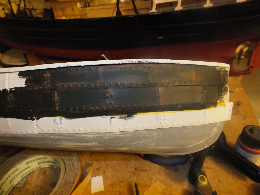

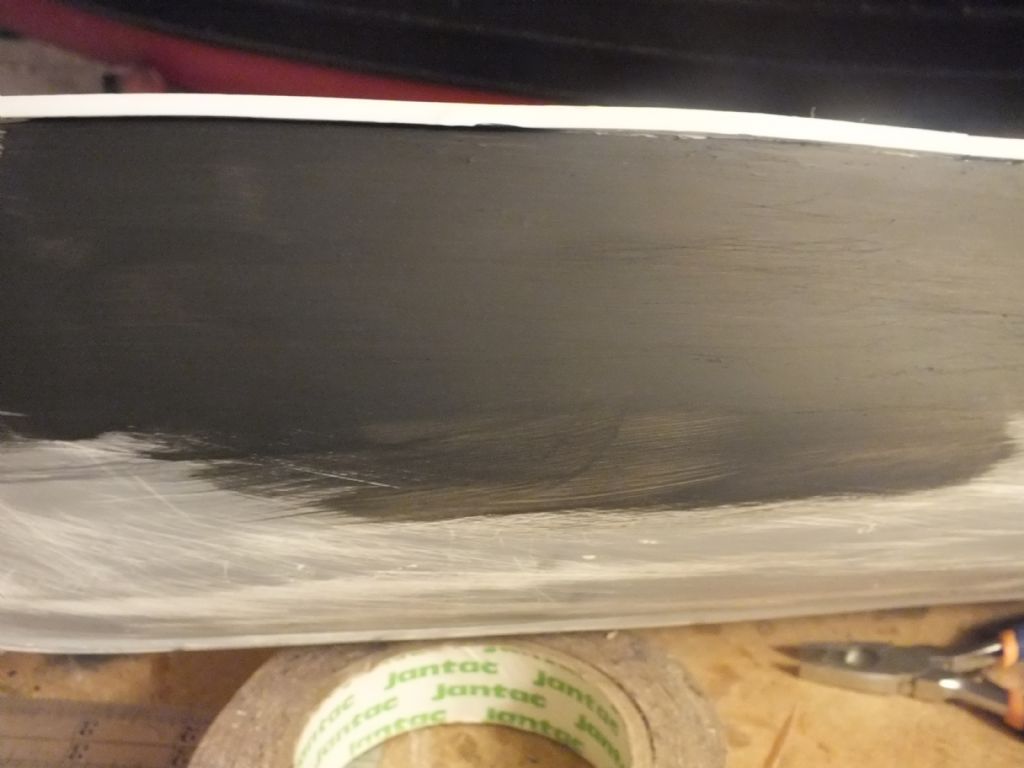

                                Hi all back on with rivtting detail using styrene stuck to hull with double sided tape calledJantec ,
                                from my building consruction day used to stick water proffe membraines seams sticks
                                like ..#### to a blanket, done a before and after demo showing plain hull painted black and a
                                rivett detail with bit of weathering , i now wich one i like , right Bobyes…..
                                comments please see picks anthother picture is the deck coverd with iron vener wich will planked with maping pen lines………..Larry
                                #38089
                                  Hello Larry
                                  The rivetted section wins hands down!
                                  Don`t really fancy the tape idea?…….I recco PVA and plenty of varnish, later on?

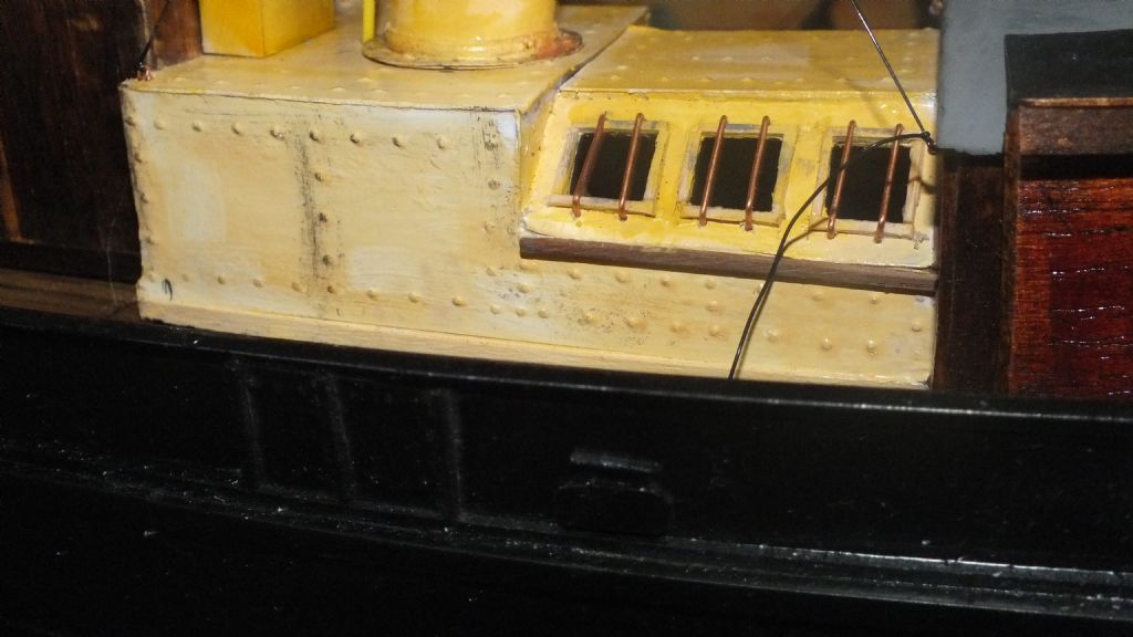

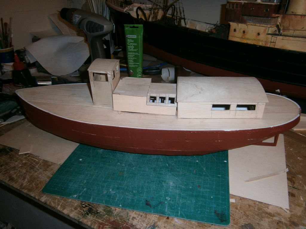

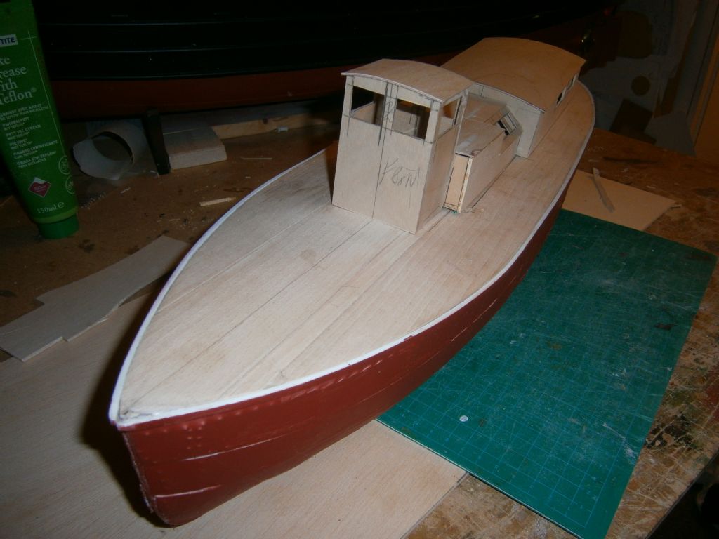

                                      A ….bit more going on deck houses ………Larry….
                                      #38177
                                        Well done, Larry
                                        Protruding rivets look really nice when painted

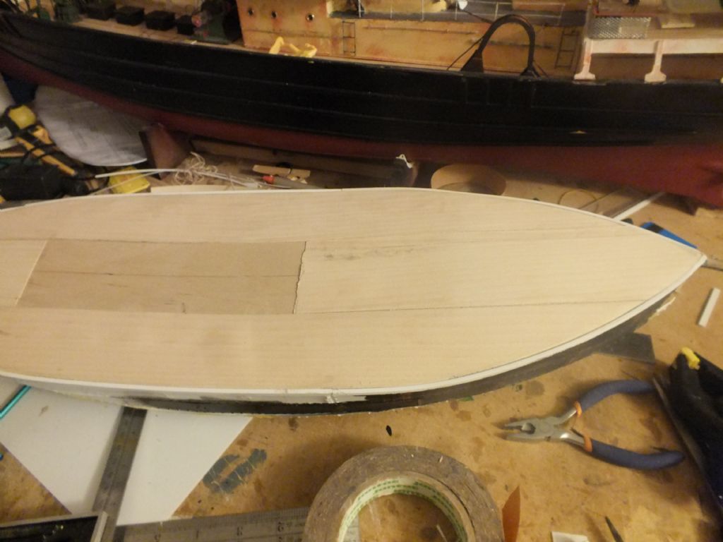

                                        For the deck, you could use stiff card with the planks drawn on and glued down with PVA and a few coats of varnish. As I did on Jeanie Deans and GE
                                        View of deck
                                        bOB
                                        #38190
                                        LARRY WHETTON
                                          @larrywhetton68737
                                          Hi Bob thank you , deck looks good and , its cheap to………… nice finish , Larry..

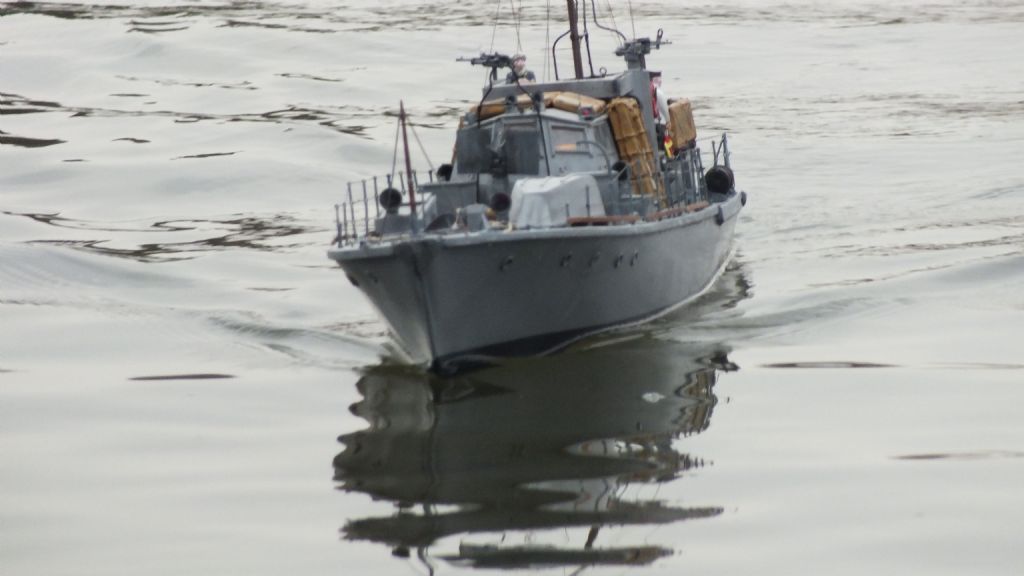

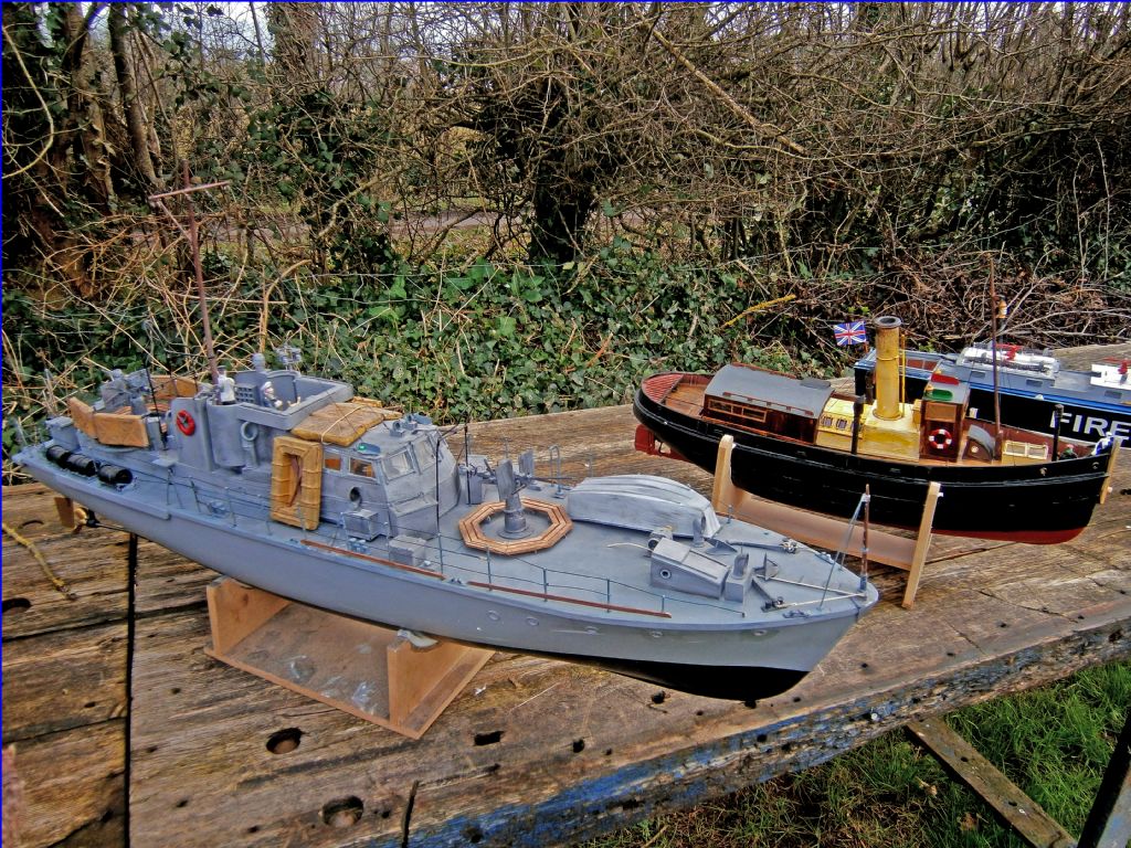

                                              Hello Again,

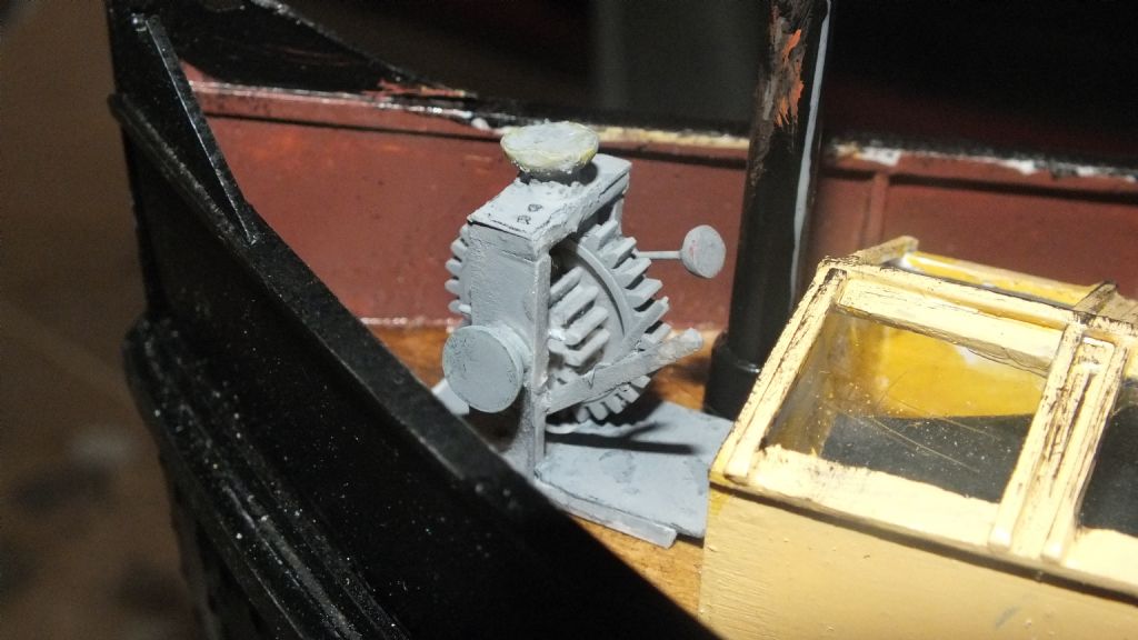

                                              a bit more progress , deck structures complete scratch built winch ,in primer
                                              dont macro pictures bring out the blemishs , but will be all right at the end…
                                              pleased with rivetts and funnel….. RC works next and a bit of snaging to do …..
                                              weather not helping…………cheers Larry……GAURDSMAN
                                              GUARDSMAN
                                              GUARDSMAN
                                              GUARDSMAN
                                              pilot boat gaurdsman The real boat
                                              GUARDSMAN
                                              GUARDSMAN

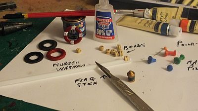

                                                    Thank you for nice comments , be doing a bit of scratch building , I/E p/s and running lights,
                                                    using odd bits from my bibs and bobs,
                                                    photos show the items used …….flag sticks from discarded jubille flags maping pins
                                                    wooden beads , boot sale map pins worked in drill , rubber washers for life buoys,
                                                    cheaper than bought items , and lok to bad when tidyed up and fitted,
                                                    and a nice way to spend a cold afternoon ……..what you think ……..LARRY….lights2.jpg

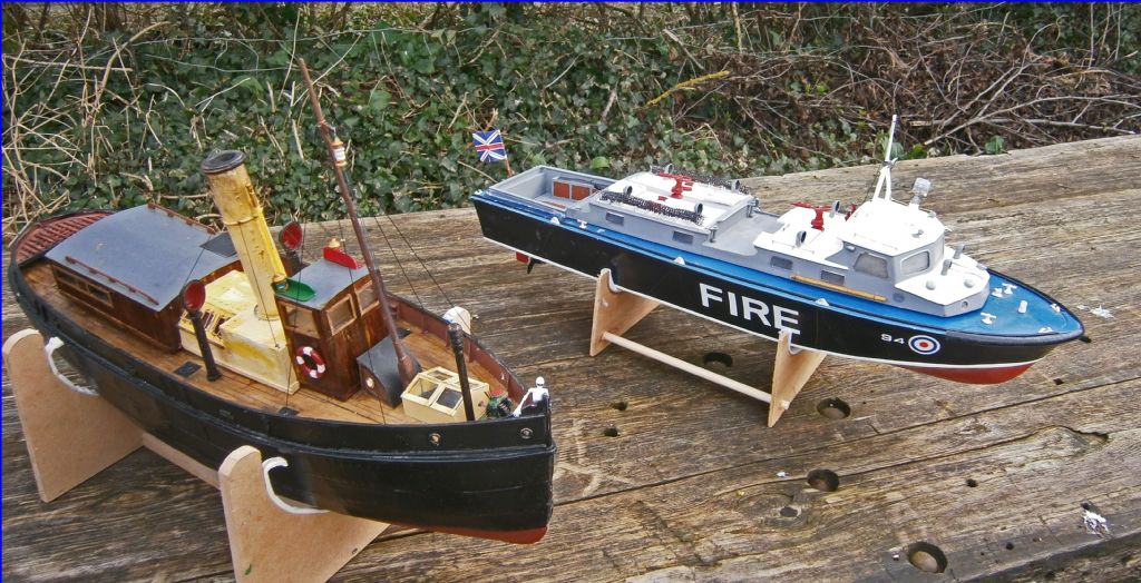

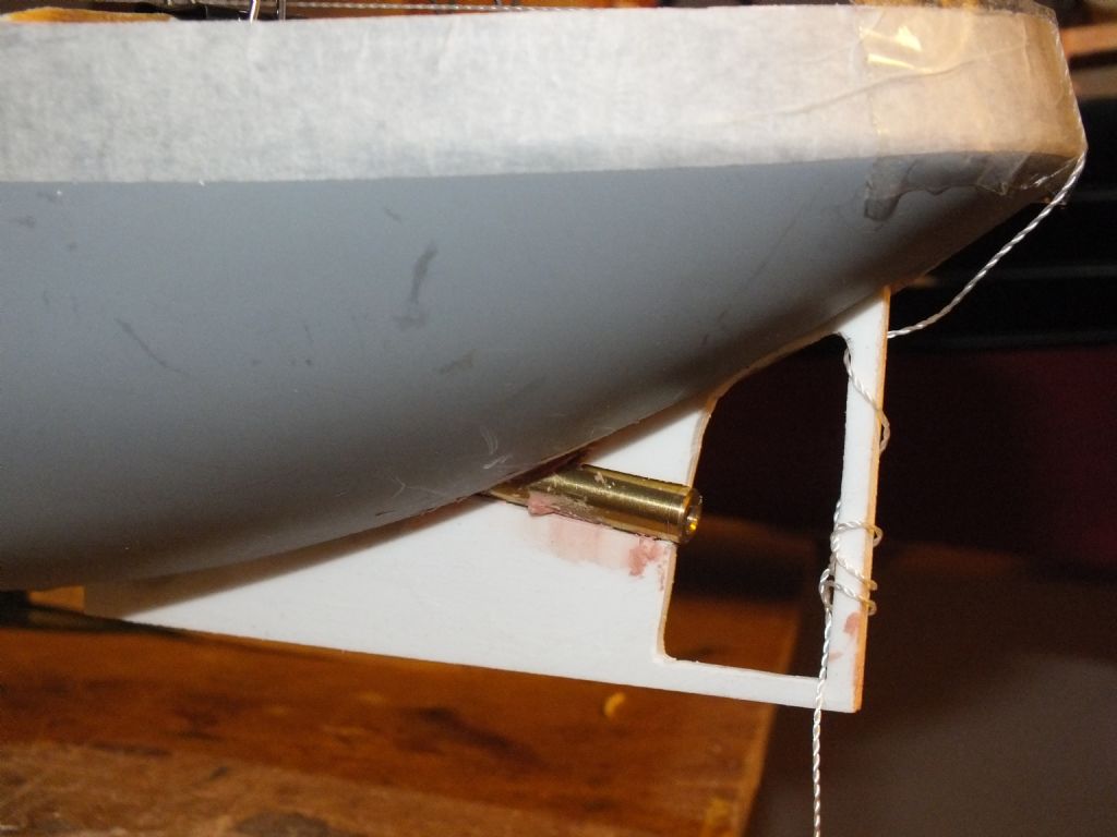

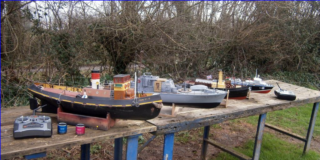

                                                      I had a day on the pool with grandson Alex, had few boats to give a airing GUARDSMAN
                                                      ballest test , needed a needed about 2lb and as water ingress at shaft end back to the work shop…
                                                      Fireboat the aquired boat for Alex back end rebuilt new 400 motor fitted 15amp ESC 9vlt batt pack
                                                      turning 30mmm xprop , it realy went well Alex now hooked on model boats,
                                                      HDML needed a airing to try out installed ACTION bits a duel prop ESC , and a sound box mp3
                                                      player sought from China cost £6 bought 3 0f them , worked realy well …
                                                      a free sound bites of the net….
                                                      and it was time to give John King a chug around , goes for ever on 12vlt set up ….
                                                      i have posted a few pictures …Alex now wants to build is own boat ,
                                                      i think a Glynn Guest plan is on the cards …….
                                                      cheers Larry…….
