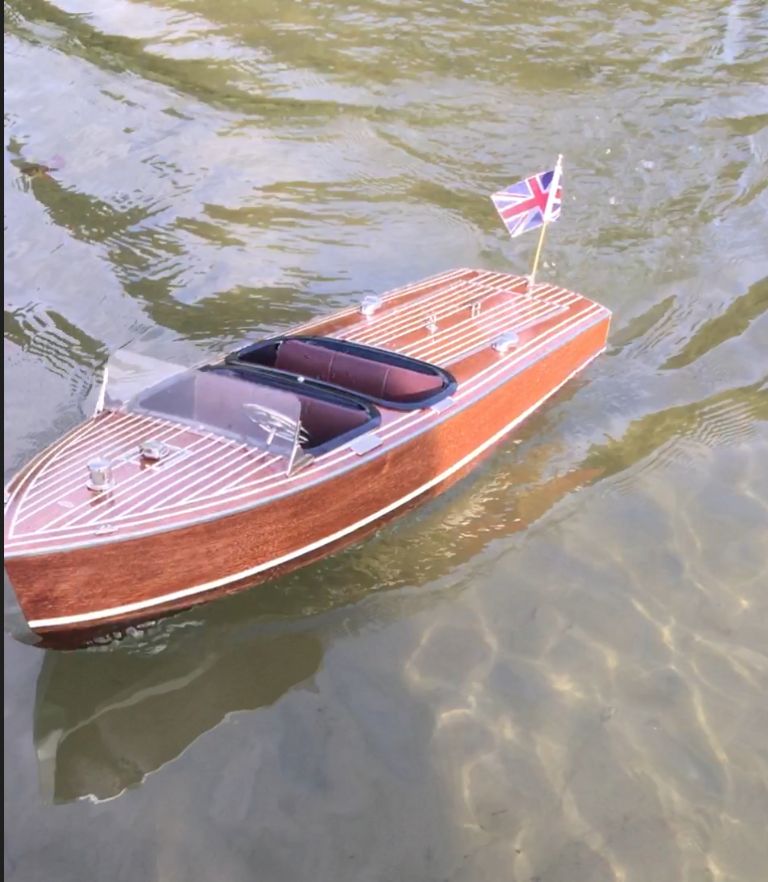

                Took the boat out for its maiden voyage and its awesome, got quite a crowd at the local boating lake! It definatley needs updating battery wise the nicads didn’t last long at all! what would be reccomended as just a battery upgrade for now until the pennies allow new motor and esc etc

                  For a cheap upgrade get a NIMH from overlander or component-shop, You can get 3700mAh packs for reasonable money. Big step up over nicads capacity wise and can be used and abused in the same way.
                  Got any pictures?

                      Looks fab. Get a driver!!
