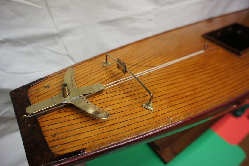

                      I'm currently re-fitting to sailing trim a 36R for a lady in Wales. I've had to make several pieces of deck items and, I thought, invented the reverse Braine quadrant due to lack of deck at the stern behind the rudder post, when I found a picture of a 1930's yacht with the same conversion done.
                      Here's that picture with the quadrant elastic engaging beam foreword instead of aft the rudder stock due to limited deck space.

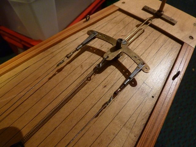

                      And here's my version of the quadrant, using the one supplied, I soldered a foreword beam to engage the elastic ahead of the rudder stock.

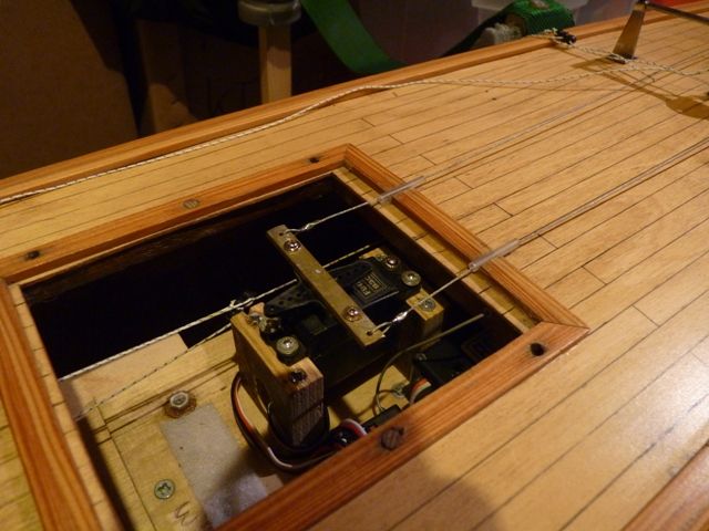

                                  Attached are a couple of photos showing the rudder servo installation on Pond Princess. Its a reasonably simple way of allowing the yacht to be sailed under basic radio control if you don't have a pond suitable for free sailing.
                                  The control wires are brought over the edge of the hatch area through a couple of small pieces of plastic tube which act as a seal and are trapped under the hatch when it is screwed down
                                  Note the corrosion on the threads at the clevis adjusters is due to the nasty salt water Kim uses in his lake in Ramsey.

                                    Gareth, salt water just loves clevis pins, I would get the nylon ones! And I like the temporary r/c fittings, just what I intend on the latest restoration, a 36R so as I can assess mast position and such. Temporary lines to the Braine for steering and sheeting too, just to override any settings made to keep it from the sides and returning to master.

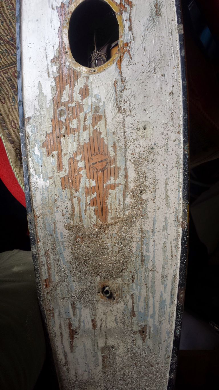

                                          What a heathen somebody was, painting over that nice lined and varnished deck.
                                          Gareth
                                          #55754
                                            On sight of that I was reaching for my furniture scraper! Please let us see a picture of the deck without that blistered gunk.

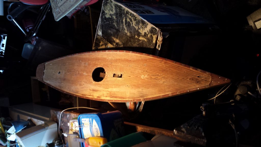

                                                Thank you, John.
                                                #55763
                                                Kimosubby Shipyards
                                                  @kimosubbyshipyards
                                                  Absolutely glorious to discover that under the paint. Perhaps an owner wanted to disguise the model?
                                                  A thorough clean up, then a decent varnish coat. Now I'm wondering what the hull will be like.
                                                  And before you ask, not heard of a J Roach, yet, can you post the wording, can'y quite make it out from your photograph, thanks.
                                                  Kim
