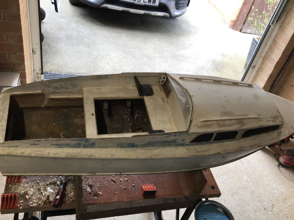

      I’ve created a new post for this as I had mistakenly titled the original “Huntress Rebuild”
      Fairly slow progress at the minute, the good weather has meant the garden is getting priority over boat building!
      I have stripped out all the internals and have started rubbing down the old paintwork.

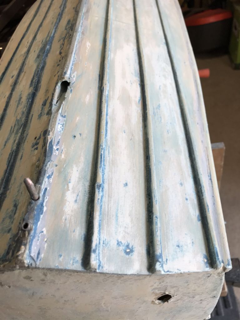

      I did resort to using Nitromors paint stripper and an orbital sander After realising that hand sanding alone was going to take a very long time…

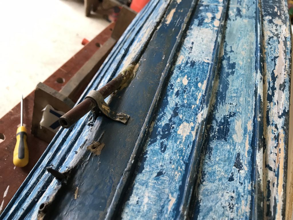

      The old BA threaded prop shaft and tube came out without any significant damage so the new 5mm replacement should slide in quite nicely.

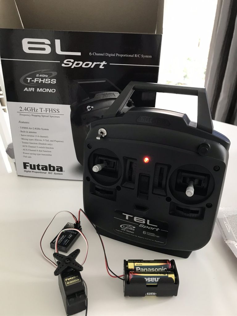

      I no longer have the original Sanwa AM radio set, so have been looking for a suitable replacement.
      Futaba was always a good make when I was a lad, and I’ve been looking at the
      2-Channel T2HR combo which seems a fairly cheap starter outfit.
      Does anyone have any experience with this transmitter and receiver combo?

                  I don't have any experience of Futaba (I use Hitec) but as you say they have been around for a long time and the spec. for that model looks good. I like that you can have a spring loaded or ratchet throttle. I have a ratchet on the Hitec and a spring loaded on an old Acoms which I quite like, so having a choice is good. So unless someone says otherwise I'd say the Futaba would be a good choice.
                  For the prop shaft I'd suggest fitting a P bracket to support it. I'll PM you about that.

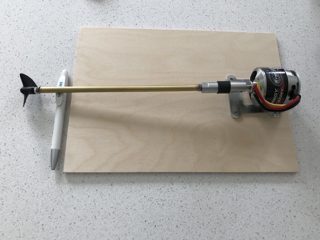

                      Thanks Chris and Dave for the advice. The Futaba set looks like one I’ll start with. Out of interest do you know what the working range of a 2.4Ghz radio set like this should be?
                      The heavy duty P bracket looks like it will be a good replacement for the original hand bent aluminium strip that was previously used. I bought the prop, tube, coupling, and motor mount from Modelboatbits. The guy from the shop, Steve, was extremely helpful.

                        As long as the set isn't designated for Park Flying then your model will be out of sight before it's out of range.

                          Your motor looks odd to me as all mine have the mount the other way round with the motor fixing bolts adjacent to the coupling. Your motor shaft is quite short as well and is that a collar on the other end. Nothing wrong with mounting it that way and it may be the only way, just that I'm not used to seeing them like that.

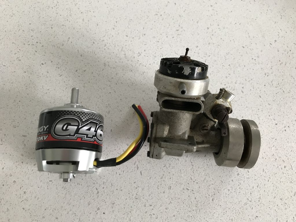

                                I’m still playing about with the orientation of the motor and mount at the minute. I think it will need to be fitted that way as the existing block for the motor in the boat is right up against a forward bulkhead. The mounting plate looks as though it is designed to take the motor either way with nothing impeding the rotating out runner. It is indeed a collet on the non drive end of the motor, it looks like the whole shaft can be removed by loosening it and an Allen screw on the outrunner at the drive end.
                                I’m quite impressed by the build quality of the Turnigy, if not a little frustrated that I still don’t have the means to actually try it out yet!

                                  Yes, it looks a nice looking motor. In fact I'm impressed with the quality of brushless motors in general compared with brushed. They are a nice bit of engineering.

                                          I’ve still to purchase a battery pack and speed controller so haven’t given a lot of thought to weight distribution and balancing points yet. I’ve mounted the electric motor in more or less the same position as the old IC engine.
                                          I did read on an other forum that the angle of the propshaft might be to steep, as the original design catered for IC motors. Not sure why this should be an issue though, given that today’s brushless motors have the same type of performance as IC’s I believe?

                                            Whether or not the motor is brushless or IC makes no difference to the propshaft angle. The debate about that angle has been going on for nearly as long as the one about whether the earth is spherical or flat. In a displacement hull with a counter stern then there's no doubt that it is best-practice to fit the shaft parallel to the bottom of the keel, but in a deep-Vee powerboat this just isn't possible. To make up for the slight theoretical reduction in thrust you can easily compensate by using more power.
                                            If it's the 42" Veron Huntsman you have then it was designed by Phil Smith. Alongside Vic Smeed he was at the absolute pinnacle of model designers, so If the angle of the shaft was OK for him then it's OK for anyone. Incidentally the shaft angle on the real thing was 12°, and that was designed by another genius [Alan Burnard].
                                            Keep the battery pack back as far as you can. The position of the speed controller will be controlled by the length of cable between it and the motor; this should be kept as short as possible. The weight of the ESC will be practically irrelevant.

                                              The Pandora's Box of angle of dangle is opened again wink
                                              This debate has rumbled on for years and our favourite flat earther always leads the charge for the historical prescient.
                                              However I am sure that if Alan Burnard had been given access to modern machinery and design techniques he wouldn't have produced a boat with a propshaft angle that looks like a donkeys dangler.
                                              At 12 degrees so much power is wasted trying to lift the stern out of the water.
