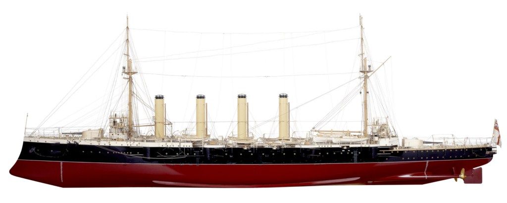

        I have DK Brown's book and others and my impression is that in Victorian times hull shapes evolved from one class to another on an empirical basis. They were expanded, stretched or both and the basic shape was not too complicated and did not change very much. The image below is of HMS Leviathan of the same class as Good Hope which I think would be pretty close to the HMS Terrible hull shape. I can email you a larger file if you want.

          Colin, Theres no doubt about it, That is a seriously good looking boat, and what an intersting underwater shape, what with the ram etc. And worth a bit more research, Paul..!

                      I have a set of hull drawings / sections for the Leviathan and some photos of the builders model that was auctioned off recently so I might give the Leviathan a go.
