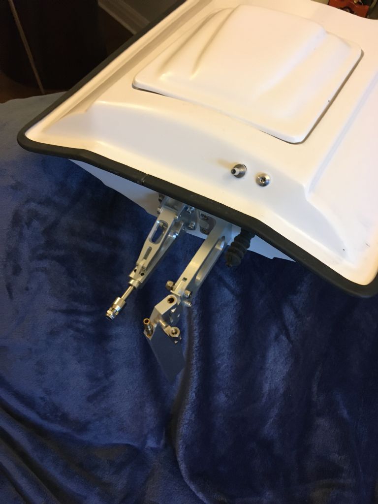

              As to my "Fast Electric" project. I have a GRP Hull 88cm x 33cm. I'm using a 1700KV Water Cooled Motor & 11V NimH Battery, Flexishaft with stinger and Offset Rudder.
              ………….and right now I have no idea at all what prop size to use. I've seen all manner of calculations online that mean absolutely nothing to me.

                  Peter. Is the prop going to sit on the waterline or be fully submerged? If it’s on the waterline ie level with the bottom lip of the stern, obviously(?) you will need a surface piercing prop, but if submerged, a normal X type two blade one.
                  Surface piercing ones can be larger than underwater ones as they are only half submerged.
                  X series props will drive almost anything, and are very cheap. A wattmeter is the thing to use when setting up, so you can see how much current is being drawn for whatever prop you have, and you can judge speed verses power consumption when juggling with sizes. AND you can keep the current draw within motor and esc specs. Buy a few (35, 40, 45) and try them out.
                  Probably you will have a dog-drive on the flexi, but X props can be converted by cutting off the end, filing out the threads and filing a slot for the dog. No doubt no one would recommend this, but it worked for me….

                    I guess I'll need a Surface Piercing prop Ashley.

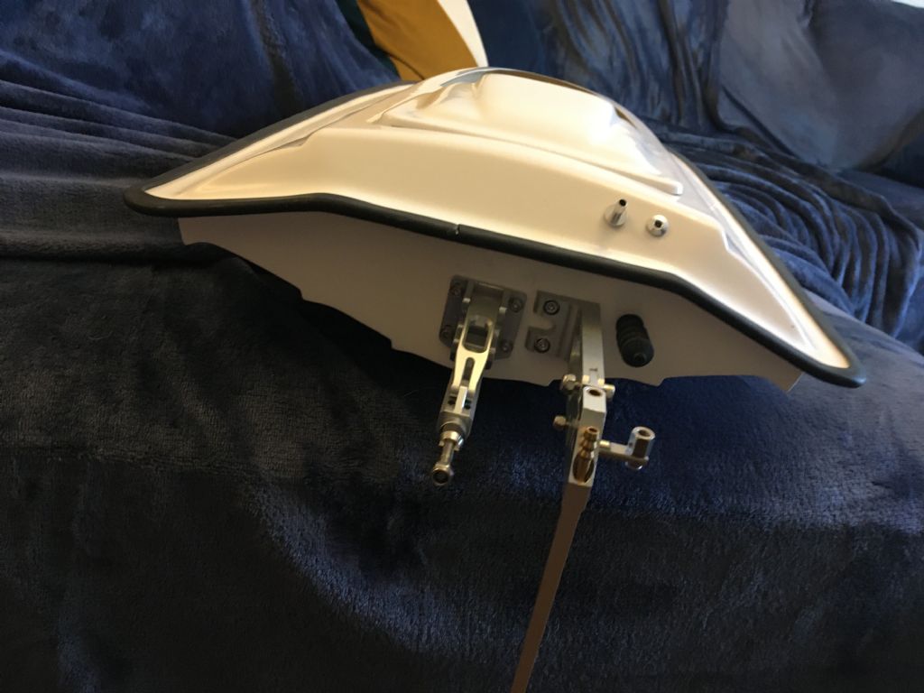

                      #93518
                        Yes you will need a surface piercing prop, but try an X propfirst!
