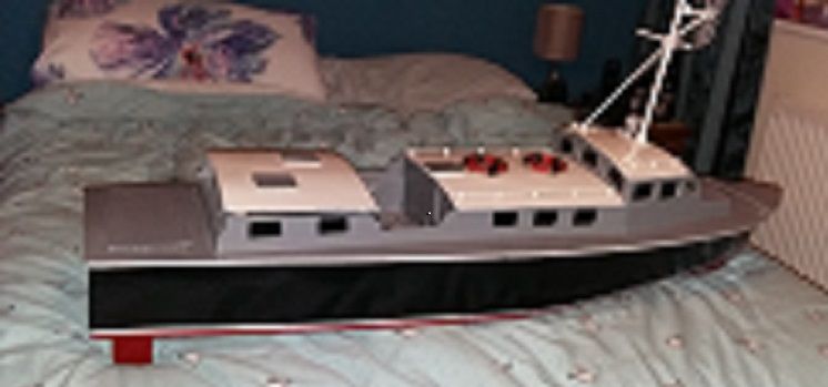

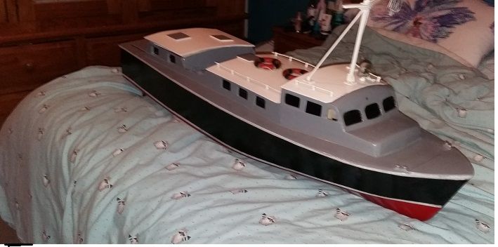

at the moment it is a bare shell i have some 3s 2200 from my aircraft that i can parallel or series up to mak a decent 3s or a weedy 6s i can do the same with some buggy pack 2s to give a decent 4s it has been suggested to give a decent level of perfomance as an ic it would have had a 10cc motor so i was trying to get a prop speed of 10-15,000 rpm it is just what size of motor would manage that
brushless tend to make there power at low revs on a big prop what we have found with aircraft is to ignore the watt rating and stick with kv rating and battery size
10cc is around 900 watts but if that comes with a shaft speed of 5000 rpm on a 70mm prop it's pretty useless
the answer to how fast is enough to get it onto the plane i dont want to get it right out of the water as i have always been told with my planes slightly over is better than under when it comes to power you can always throttle back
