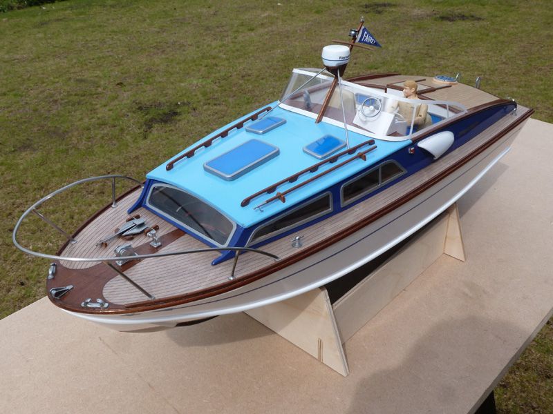

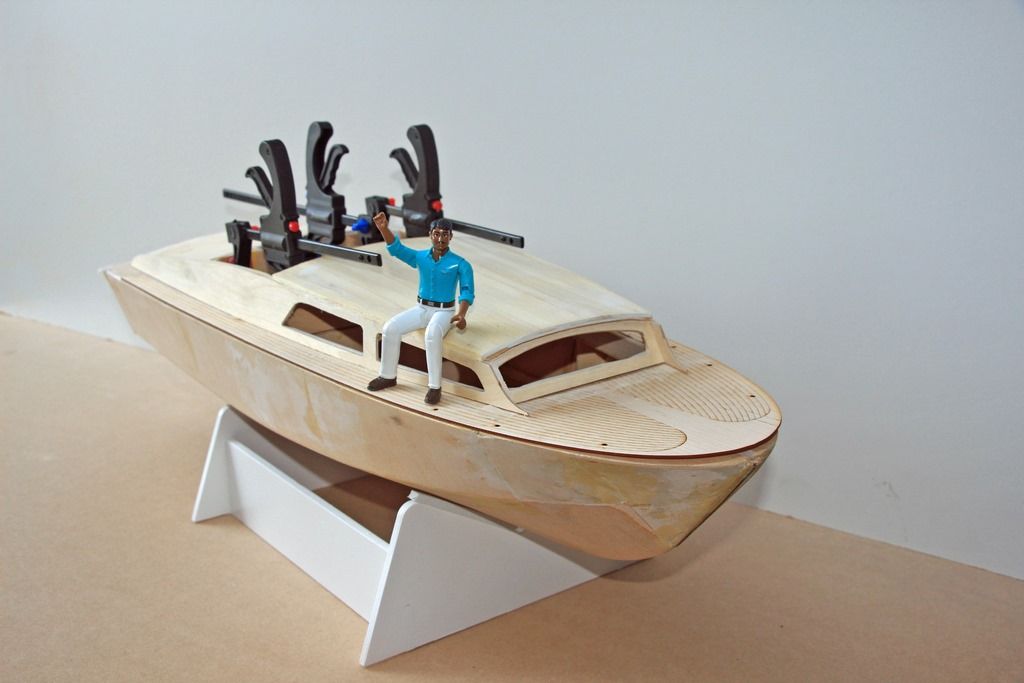

                                  I'm building the SLEC Swordsman at the moment and thoroughly enjoying it.
                                  Love working with the wood construction. The bits fit together nicely but there is still some satisfying shaping to do and I will hopefully end up with a near scale model as a stablemate to my earlier Huntsman.
                                  Edited By Colin Bishop on 12/08/2019 22:16:51
                                  #83415
                                    I'm only too happy to keep bringing Faireys to the masses! smiley
