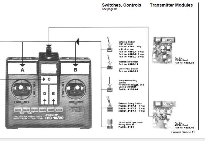

              The photo on Page 11 of the MC16/20 Programming Manual (UK version) shows two different circuit boards – or RF modules – for the Tx, depending on whether you need to use 35MHz or 40MHz. These are the two VHF frequencies permitted for model use in the UK (along with 27MHz). I don't have a copy of the French/European version so I can't say what options are available for the set you have bought. As you say, the bulk of the manual is concerned with programming model aircraft and helicopters, although there is a sizeable section near the back which covers the Nautic switch modules (not the same as the RF modules).
              This RF module circuit dictates the frequency at which the signal is transmitted, in combination with the crystal. You can't fit a 35MHz crystal into a 40MHz module and expect it to work properly. In the same way you need a 75MHz module if you want to use 75MHz crystals. Some radios have plug-in modules which fit into a "well" in the back of the Tx case, while others require you to open the Tx case and fit the circuit internally. Similarly some receivers have interchangeable RF modules, but generally they are manufactured for a fixed frequency band and you'd need a 75MHz receiver.
              In short, I'm afraid you have a 41MHz radio and you'll need to buy more than just a pair of crystals to change that frequency to 75MHz. Not that you have to take my word for it………………

                The reference to swapping crystals between air and surface probably refers to those countries where the model bands are shared, but odd channels are used by flyers, even by surface. Or the other way round, I don't live there so I don't need to be exact on that. There was a recent report that some UK air band (35MHz) receivers work with 40MHz band crystals, but trying that with a transmitter would be operating the transmitter out of tested specification, voiding any legally required certification.
                The RF module in the transmitter has components that operate in the designed band – the crystal fine tunes the frequency that it will transmit at. Put a hugely different crystal in, there is no saying what might happen. There might be RF power transmitted at the crystal frequency, but it might also be transmitted on a few harmonics as well. It might not be at a useful power level, it might be at a higher level than is legal, it might give an impedance mismatch to the output transistors and kill them. The least likely is that it will work properly.
                Inside the transmitter case, on high end devices, the part that sends the signal to air is a module that can be changed for another designed for that band, keeping the existing control functions. A fairly popular move recently has been to replace the Radio Frequency module with one operating in the 2.4 GHz band. Obviously, matching 2.4GHz receivers are needed.
